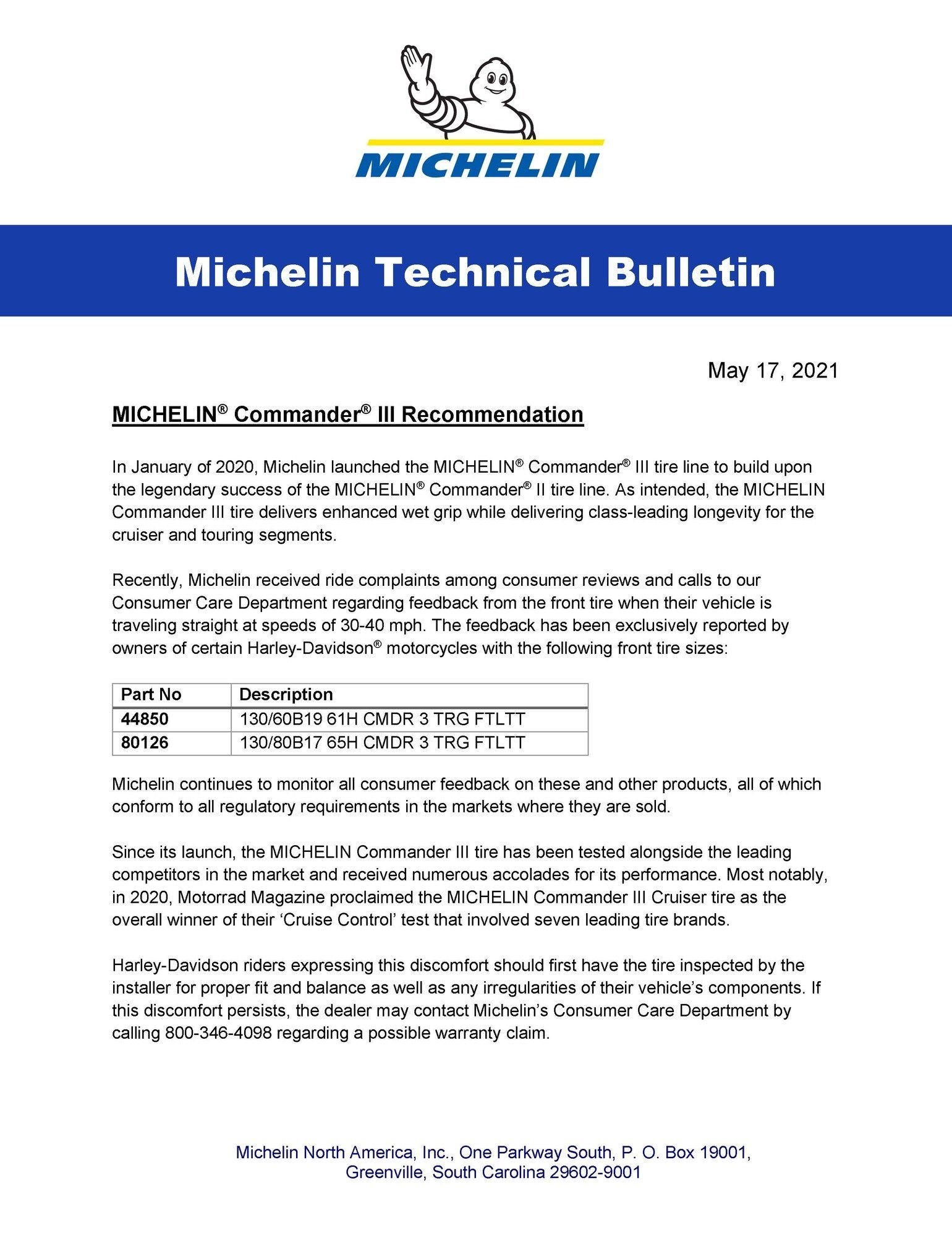

Originally Posted by kojak
"I keep the front at 41psi and rear at 46psi cold."
Why do you keep your tires overinflated? Is that what Michelin recommends? I've always run my touring bikes at 36 front and 40 rear cold psi. I only run American Elite's. I would think overinflation would wear the center tread more quickly causing vibration in the ride after a few thousand miles.
I will add here the '17 CVO has TPMS. If the rear gets below 40 it will throw a warning that won't go away unit you start the bike with the rear avove 42.

Update: I’ve ridden a thousand miles or so since I last posted. Essentially the Commander III’s are the opposite of my experience with Dunlops. After a few thousand miles Dunlops cup off-center and “sing” in the corners. The C3’s sing in a straight line with a small amount of vibration. Both sound and vibration disappear with the slightest lean.
