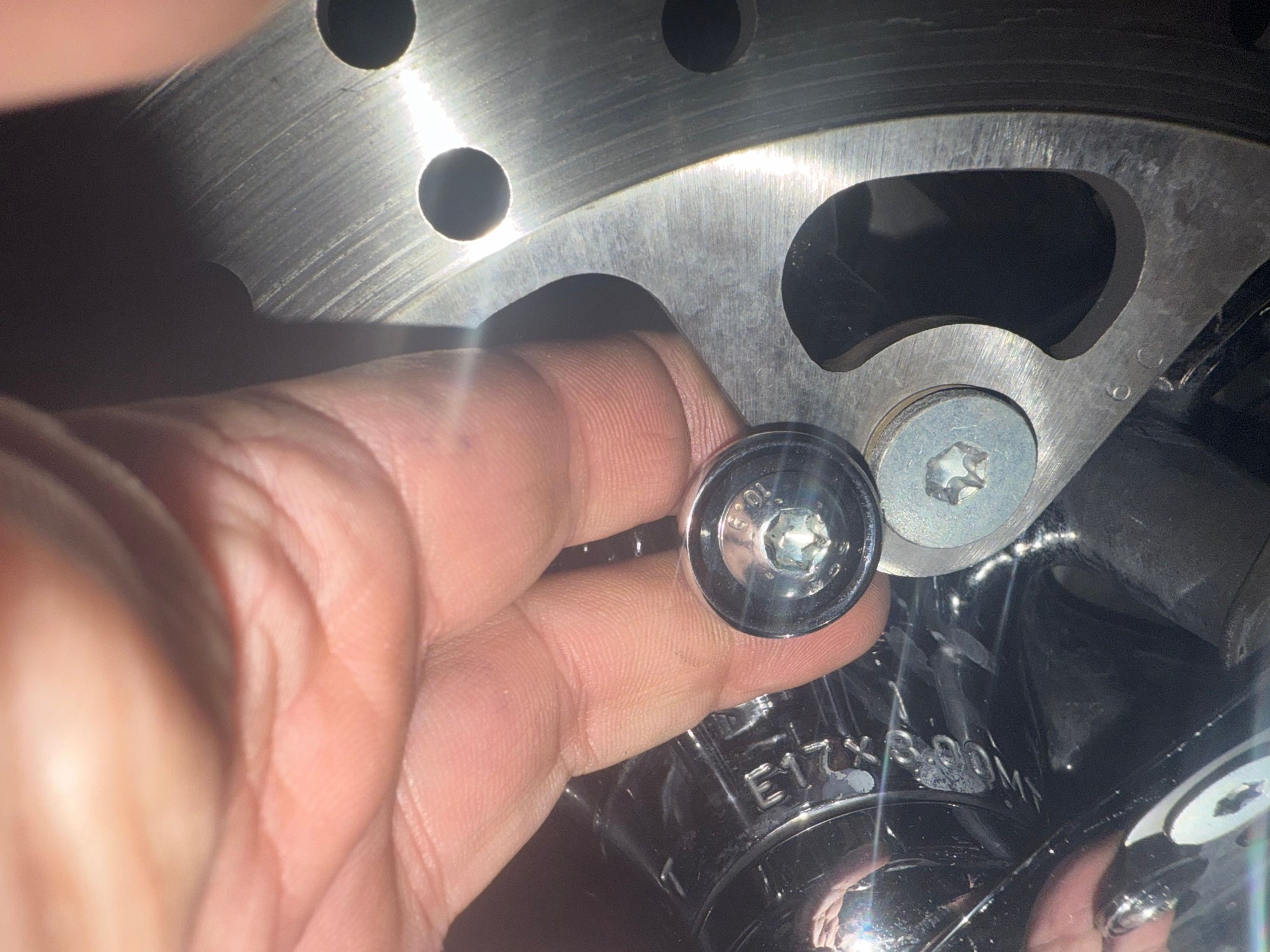

Taking my front wheel apart to polish it. Plan to polish the factory 7 bolt rotors too.
I want to replace the rotor bolts with chrome. Aftermarket ones I bought look different and don’t fit (see pic). Internet search suggest I need 3 piece bolts (bolt, spring and washer/spacer). 41500020, 19 & 18.
I took one off the bike and it’s a 2 piece (bolt w attached washer/spacer and spring). I’m guessing part number 41500196.
Harley ‘used’ to make bolts in chrome and I found them online (91800029) but now worried they won’t fit.
then there’s these on Amazon that match up thread size (not sure about the washer size though) but don’t include the spring. https://a.co/d/1PCwr9J
can anyone point me in the right direction,..I’d like the factory look and don’t mind aftermarket. I don’t mind oem chrome provided they fit properly. Thanks!

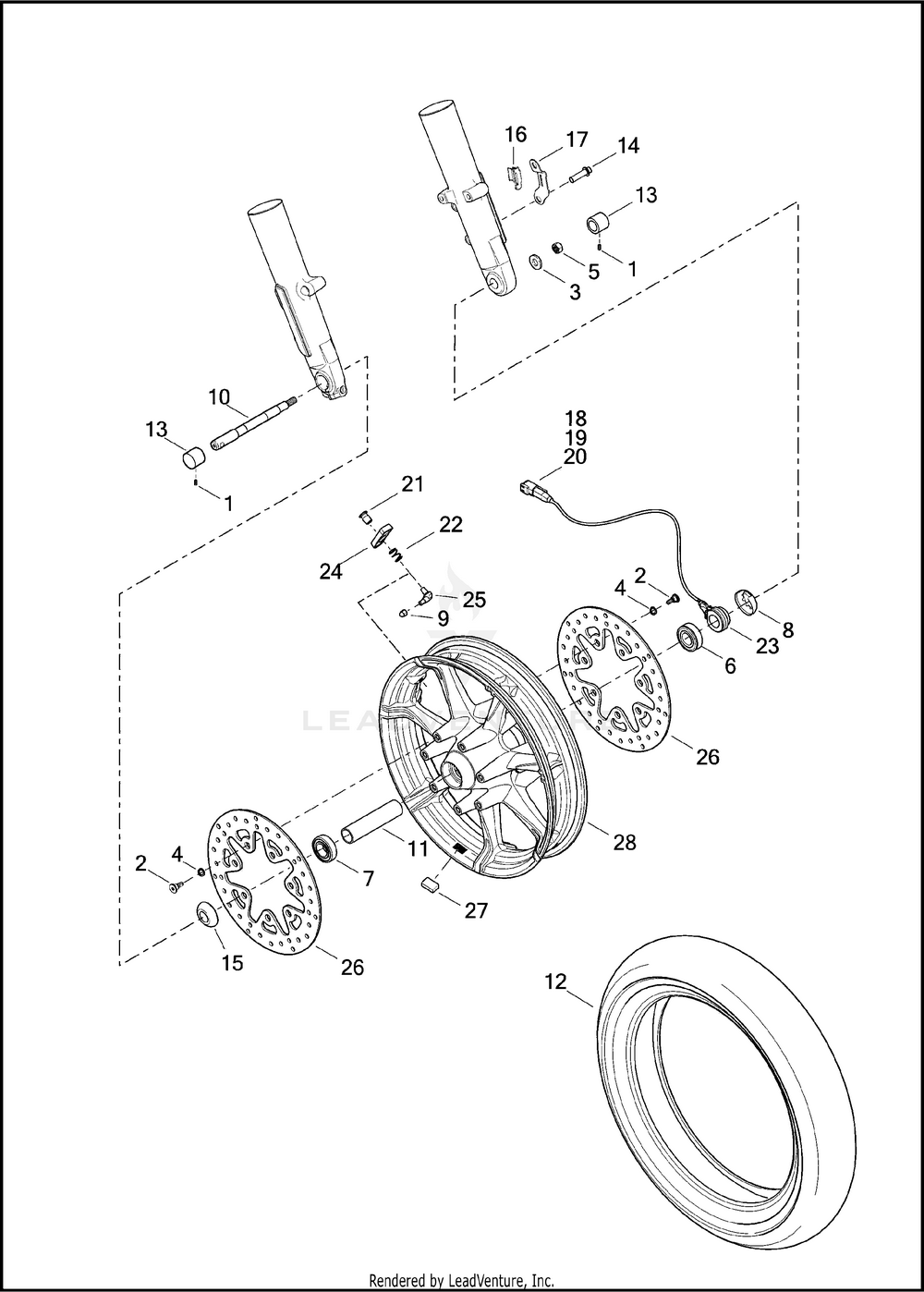

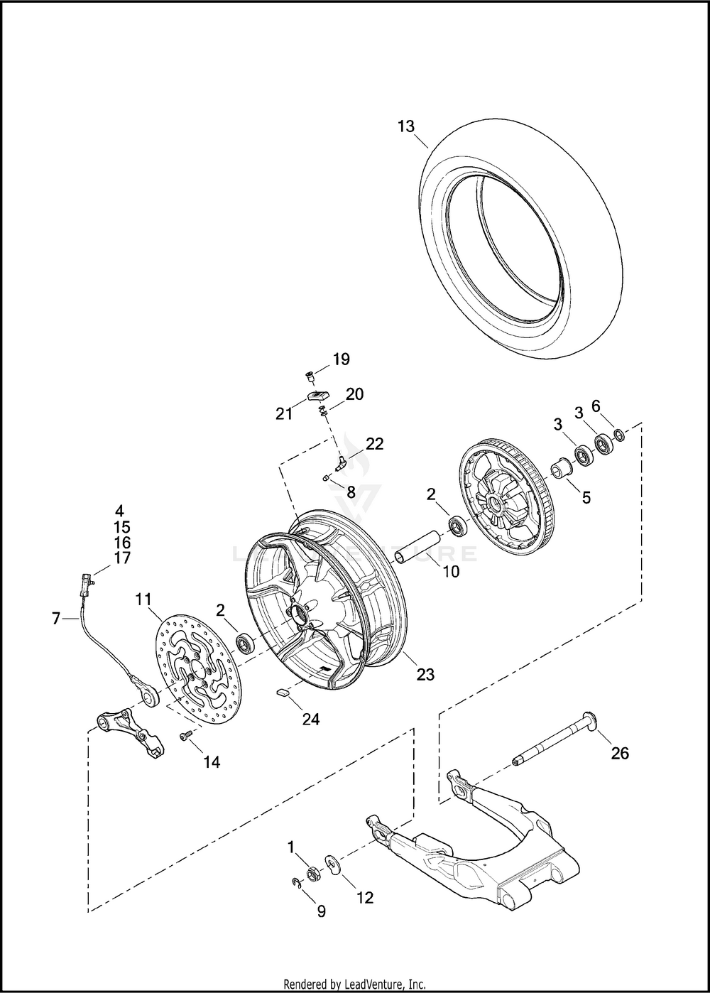

Best to use OEM. Looks like front and rear rotor bolts are different. Rear SAE, Front Metric.
REAR
Ref:14
43567-92
SCREW 3/8-16 X 1 TORX PAN HD., W/LOCKPATCH
FRONT
Ref:2
3762M
BOLT M8 X 1.25 X 23 - 12.5 TORX HD., SHOULDER
Ref:4
6966M
WASHER 12.6 X 19.0 X 0.63 SPRING
https://www.harley-davidson.com/us/e...s?aribrand=HDM

Thank you! Are there more part numbers available for the front wheel? I’d like to see if I can use the discontinued oem chrome shoulder bolts and spring washer kit number 91800029

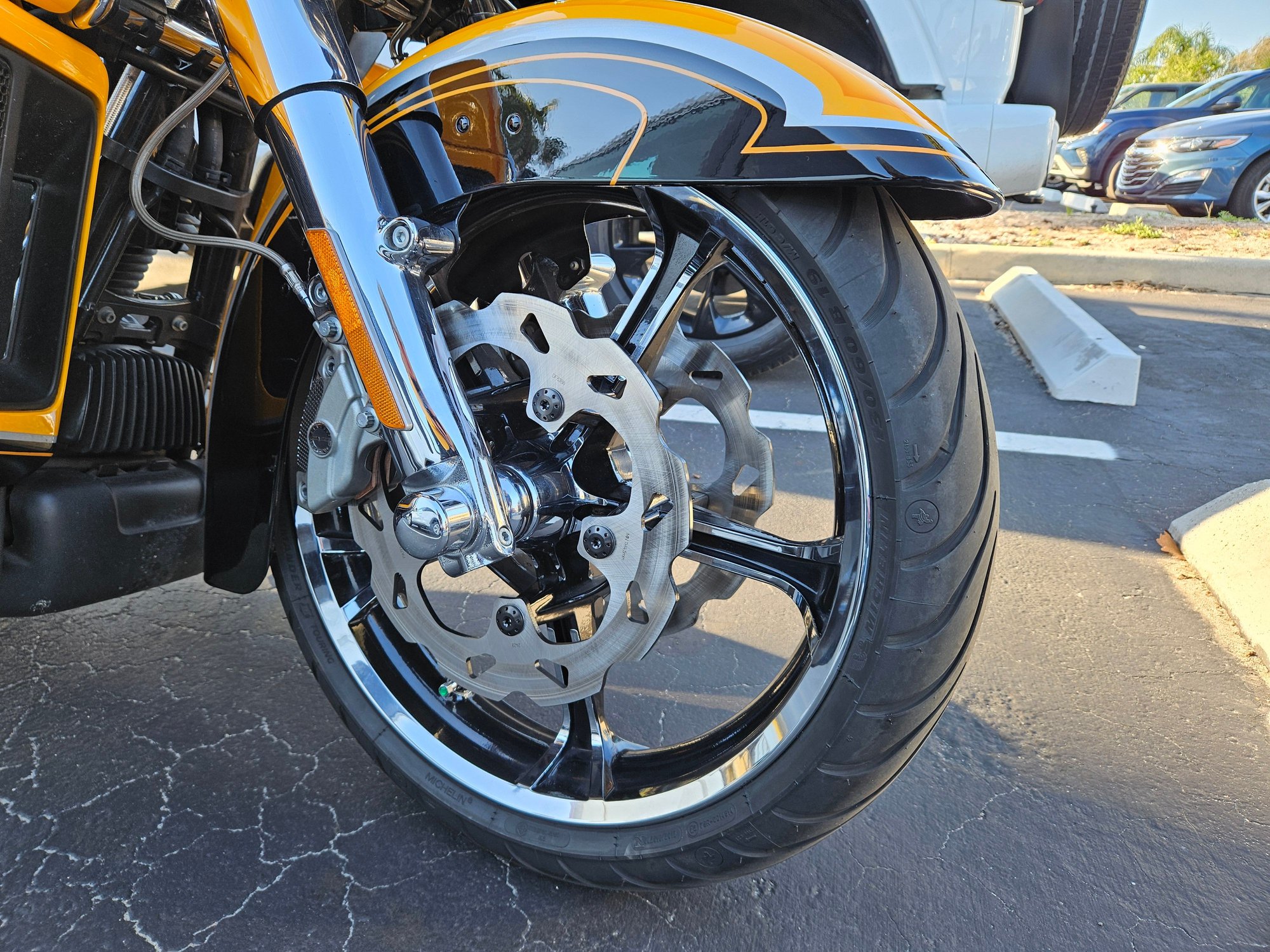

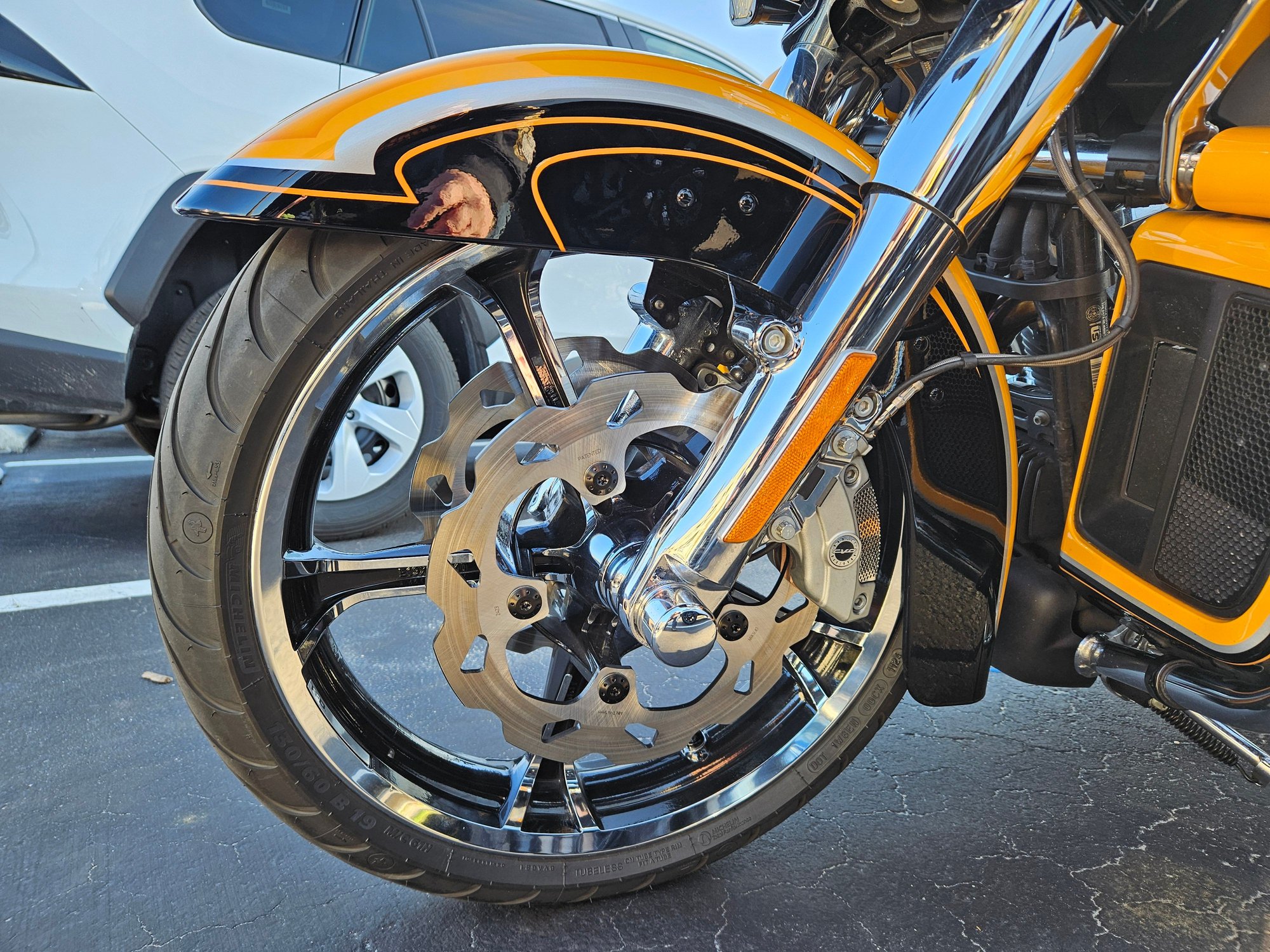

We purchased Gralfer Rotors for the front of Ginger while in Daytona this year for the rally. They recommend changing the bolts and they had both black and polished.
I do not know who makes these but they look great.

^ Look like Arlen Ness bolts

Understand the front end is made by Showa and as such the bolts/screws are metric, so make sure you get metric threads and sizes.

got it. I measured the ones off the bike and they are M8 1.25 threads and just over an inch long. Harley doesn’t have the thread size readily available for their part numbers.

AI said 91800029 kits have standard thread size. I called Harley and they confirmed these are metric and the only OEM option if I want chrome, which I do. That said, I ordered 3 of the last kits (discontinued). Thanks everyone for the guidance!
