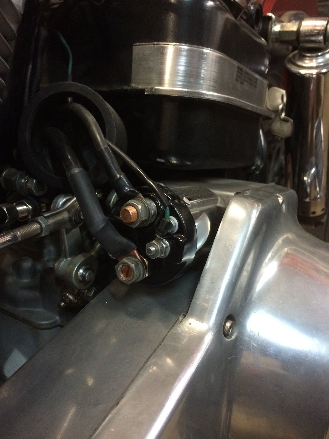

I disconnected the wire from the solenoid to the starter to test the relay. The relay clicks on/off as I push and release the starter. The solenoid doesn't move though.
I reconnected the starter to the solenoid, put the plugs in, and the starter still keeps turning once the button is released.

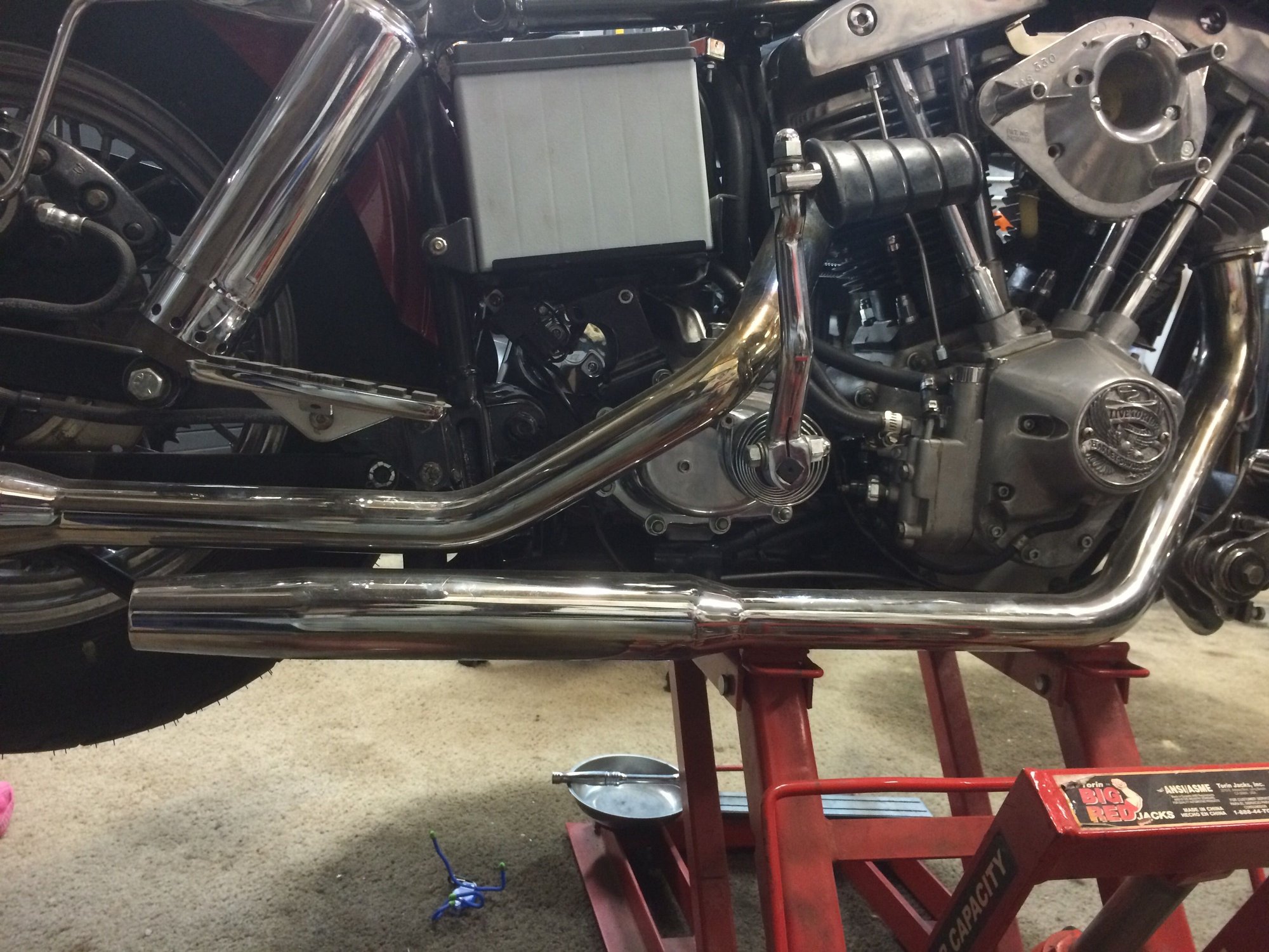

1980 FXEF80
Solenoid with rubber boot off
Battery box side
Close up near batt box

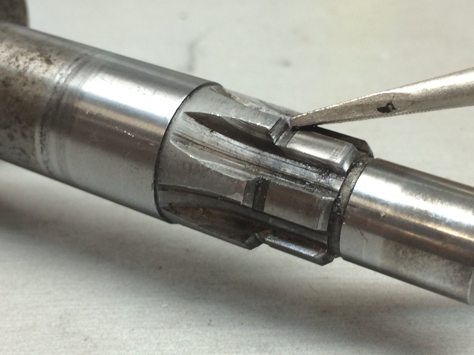

I finally pulled the damn starter and shaft. Looks like the splined end that goes in and out of the starter has mushroomed at that ramp. This is the original shaft. The starter is brand new. Thoughts?
Starter shaft
Close up spline to starter
Mushroomed a little?

I would Not have any problem running that shaft...I am gonna go with what Tom84FXST says about the engagement [shifter] fork.. You are there now, aand that is the most likely spot on the Shaft to be a Problem.
I'm still Thinking Main solenoid...the one on the Primary...Only that solenoid and/ or thee fork [or similar mechanical assembly] can cause "stuck" engagement. And, if the Main solenoid "sticks" don't make two ***** if you take power away from the "Trigger" it is still mechanically, Stuck and making contact at the Washer. Very very common....especially with Chiwanese Solenoids!!!
BTW, NAPA has a Solenoid rebuild "kit" worth it in every way!
