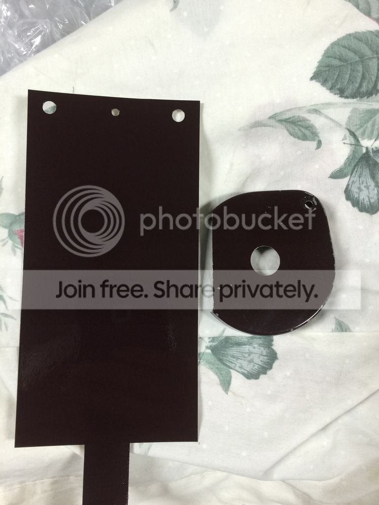

Below is a spray out of the PPG against an original piece. From my research, the FXDG paint was specially done with PPG from the factory, that is why the code exists in the first place. My paint guy, who is very particular, thought there may have been some gold pearl in the original that is not in the PPG code, but it's almost impossible to tell. He used different lights and a light gun to try and find differences and confirm the color. You would not be able to tell the paints apart (PPG code from original) if a stock bike and a repainted one were right next to each other.
HOWEVER....... We wanted it 100% accurate, so my guy did a spray out with the lacquer paint and sent it off to PPG for them to match it in the lab. I don't have that code back yet. I am assuming all they will be doing is adding a tiny amount of gold pearl. It depends on how into perfection you are I guess.
I don't think I would use the lacquer paint even if you found some, we did not; and like I said, I have a can.
I would also add that the color gun does not work with this color....
