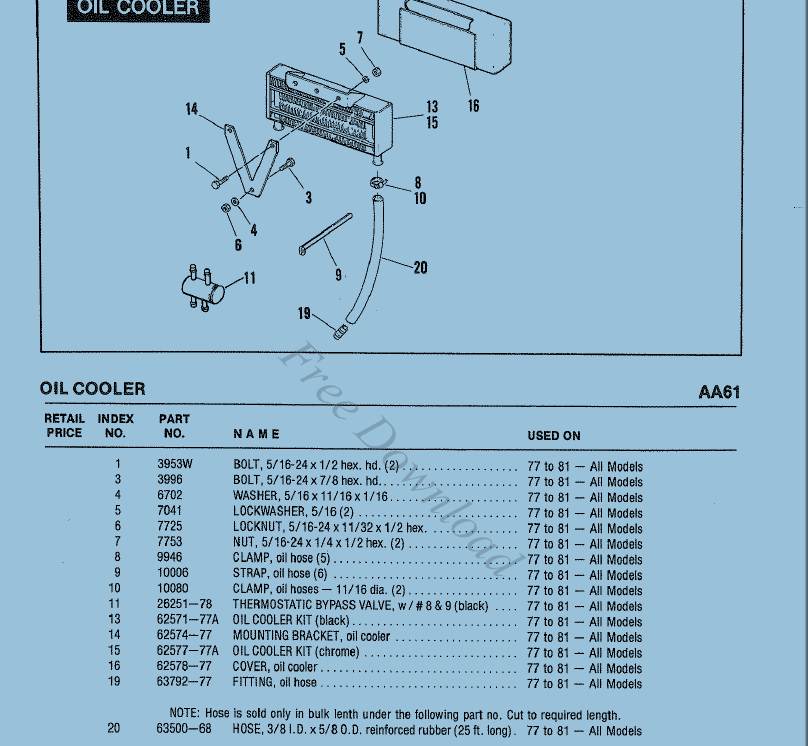

That radiator is an oil cooler .. This is to help cool the oil when you are moving ..

Oil coolers came stock on some models in that era like my 79 fXS. Not really necessary but they can help maintain oil viscosity in hot climates.

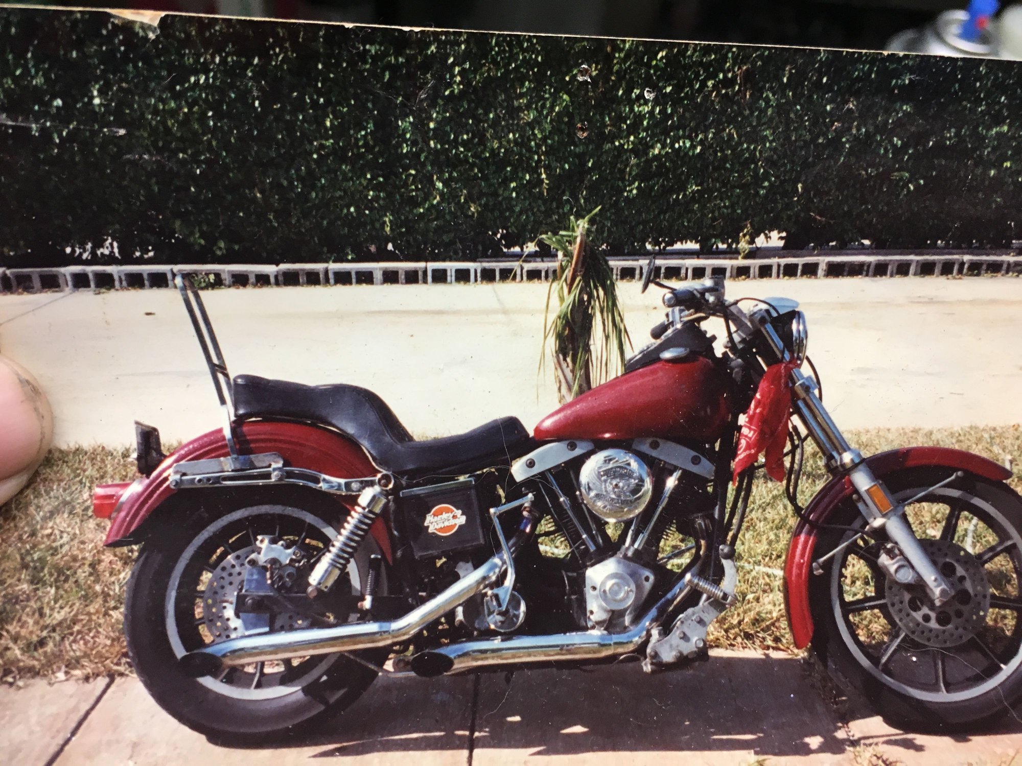

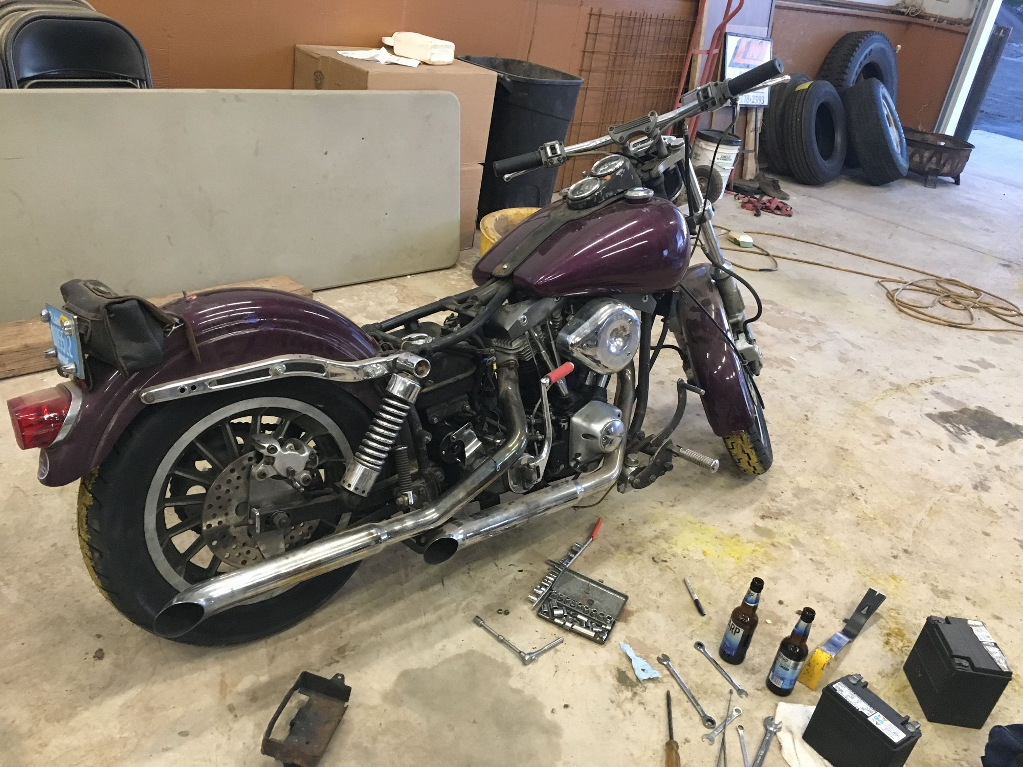

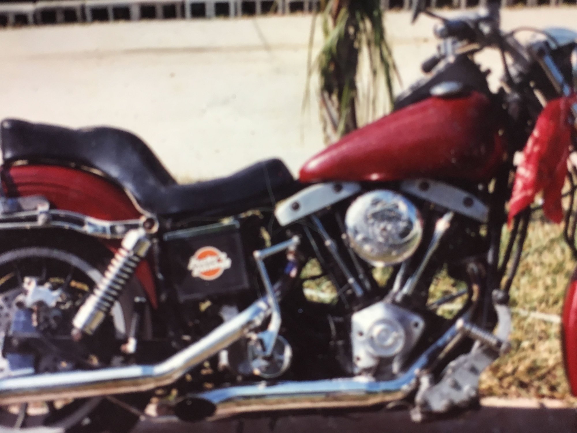

Here are just a few pics thru the years, I got it purple and started messing around with a few black an red combos. But ultimately, it's getting a springer front end, and rear fender is being chopped a little shooter.
It comes stock with a 32 degree rake already. I'm new to the springer set up. Any good suggestions on length and rake let me know.

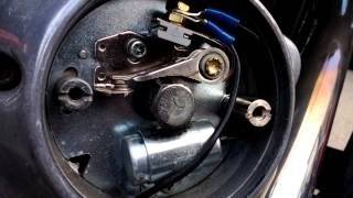

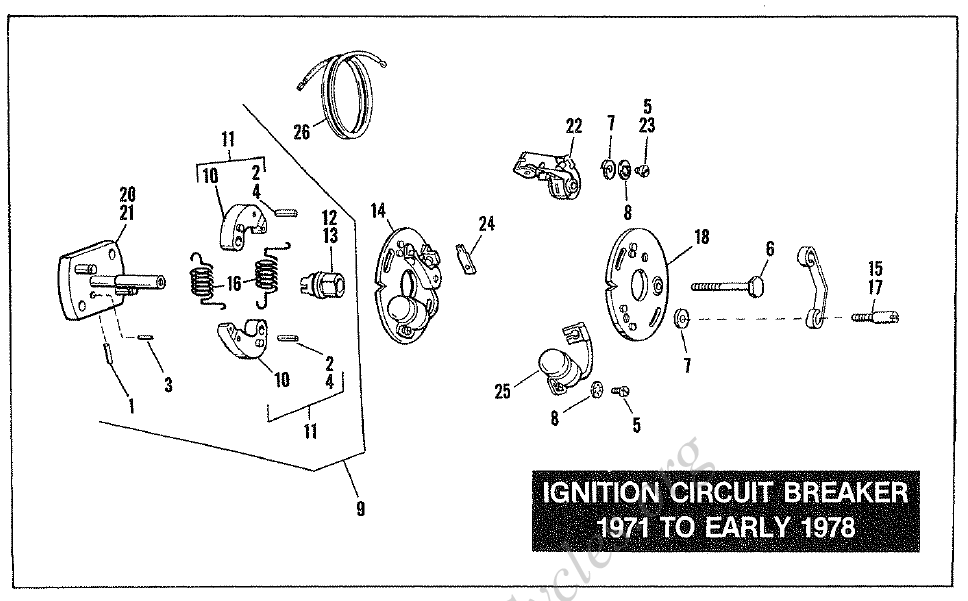

https://encrypted-tbn0.gstatic.com/i...mPyhMtOVreBOk9
HOPE U CAN SEE THIS . IT IS WHAT MINE LOOKS LIKE.

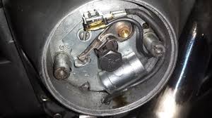

From: Philadelphia
THIS IS WHAT MINE LOOKS LIKE.<br/><br/>
That's points & condenser
