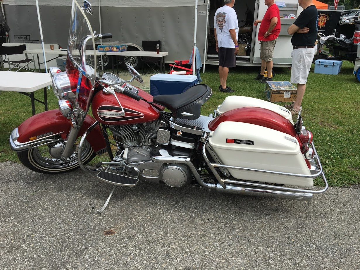

no 1971 is silver jugs and the rest of the engine and trans are natural alloy
I restored this 1971 some 5 years ago and its the highest scoring AMF shovel in the AMCA still today
Attached Thumbnails Engine Paint-image_fc95f4a47e8ebfcc7c556d7c1702289670221c2d.png

JZ Nice looking bike, I hope to have mine look a little like that but just for the street.
? I understood that the '71 was the first year for the AMF logo to be on the tank also.
No the first time it appears in early 1972 as it was a add on sticker by the dealers in the field - they AMF bought Harley in 1969 but did not finish paying for it till the end of 1971 - reason for the add on sticker
