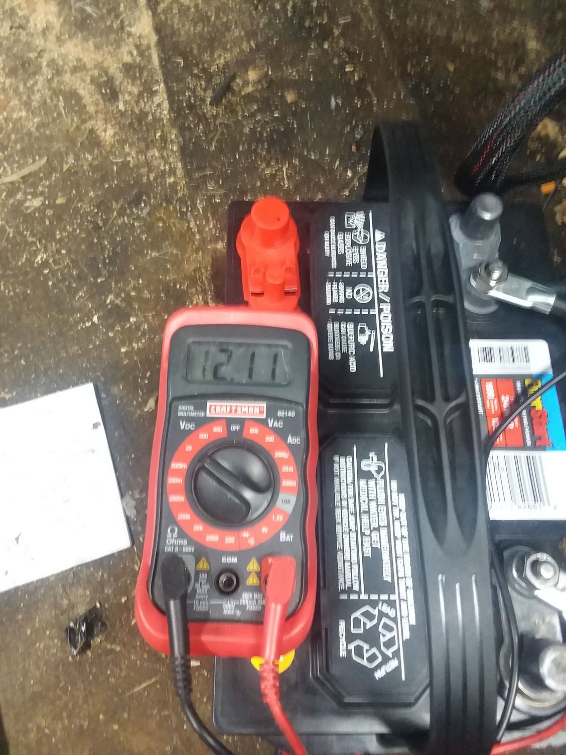

Entertain me; Put a Digital voltmeter accross the Battery terminals, record voltage
1] at rest
2] starter engaged..

don't really understand the Pics... But... 12.11 is a Dead Battery!!!
Starter engaged it needs to hold about 11v
remember
12.6 Volts+ is 100% Battery
12.3v is a 50% Battery
12.0v is completely and Positively Dead!!!
Never gonna start with a battery not 100%
in fact... gonna wreck what ya got..
and... I have Never had any luck jumpered... better jumpered to a battery than your Pick-up Truck tho... next you'll need a Voltage regulator..
