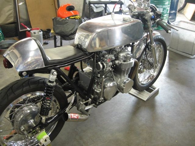

A little oil leak detour here. Pesky *** leak at shifter shaft. Has a pretty long section with minimal support after the seal, gonna punch out the side cover, and insert a bronze bushing that I am going to ream to precise size. When you have a lot of vintage bikes, there is always a little oil somewhere!
