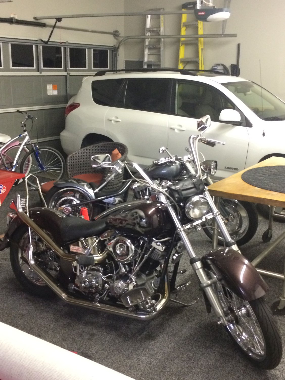

Default No no nooo
mine does just mask it off painted it bright silver worked out and when needed do it over. And yes OE fender so not gonna cut it up. Ride safe. Wild Bill

^^^ Stock Shovelhead fender with a Tombstone taillight???I thought the hinge on O.E, was staggered by Width of hinge sections... wide then Shorter??? Unless the light is playing tricks in that photo... that is not a Stocker...

Default not shovel frame or fender
51 wishbone frame setup
Rigid also

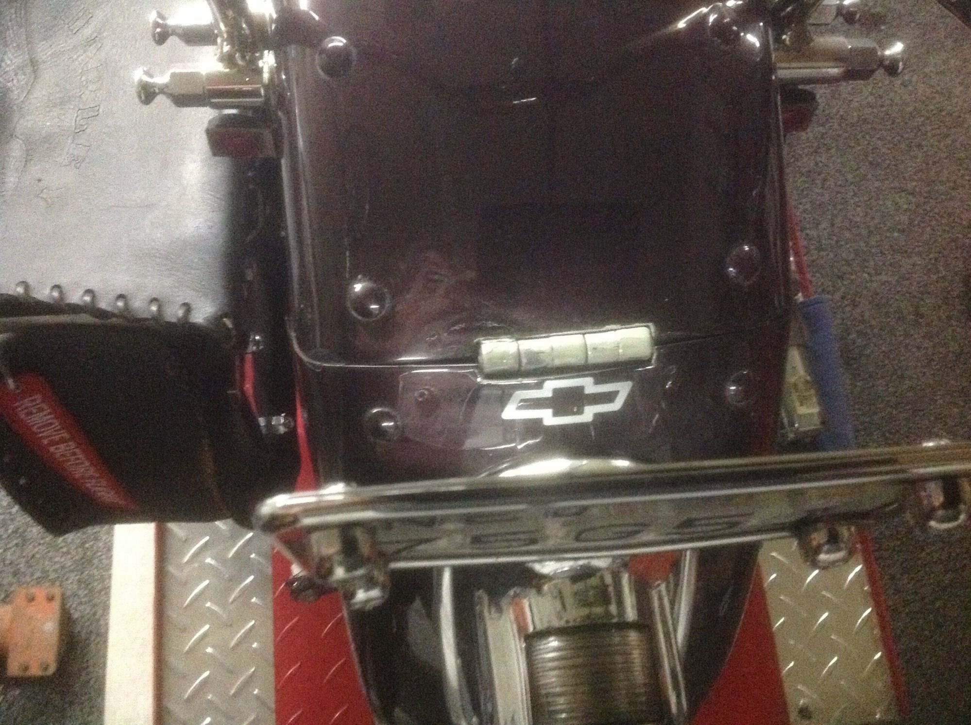

apples and oranges - I am talking about the hinge removed and the fender two pieces not having the ability to hold together like when it was riveted - and with out gluing the hinge in place and the fender bottom to the top part = the bolts being 1/4 inch even with red loc tite will not stay in place - I have seen every hillbilly idea used to do just what he wants -= I was giving shop experience in how to keep it more then a year with out painting it again - and chipping the chrome you just had done - I don't see bolts in yours
