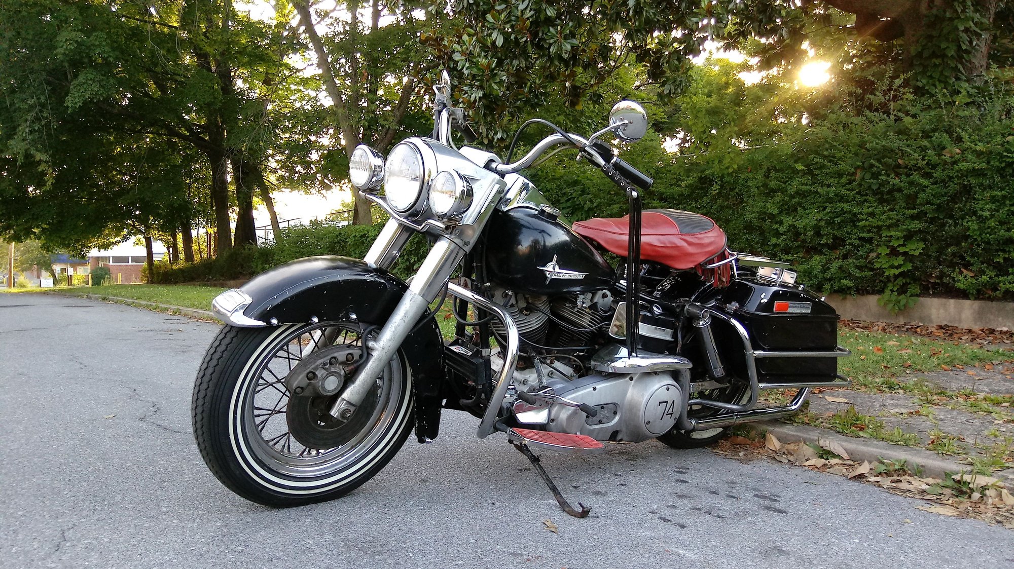

So terribly far from original, but it is a blast to ride
Baffles in those old fish tails, doesnt sound horrible
Been riding as a daily commuter this past week, well, since i got it on the road.
After about 100 miles with the 10wt oil, the front end seems to have settled. It doesn't crash around like it was, still firm, but not nearly as harsh. I'm still going to measure sag, when we have a rainy couple of days. But for now, it seems a bit better

what I see is the bike stance is a bit high it may have 2 over tubes but the cow bells are stock length
normally the cow bells are not at the top of the fender they are and inch or so down along side if it
Old Jun 29, 2019 | 08:45 PM

I thought the same, but i measured the tubes when i had them out, and they're 20.75" long, which from what I've seen, Iliad believe is stock length for the late 77> tubes. The springs are 19" or so, can't remember the exact length. The back of the bike is lowered some tho, but not that much, maybe an inch. Has a kraftech adjustable swing arm.
