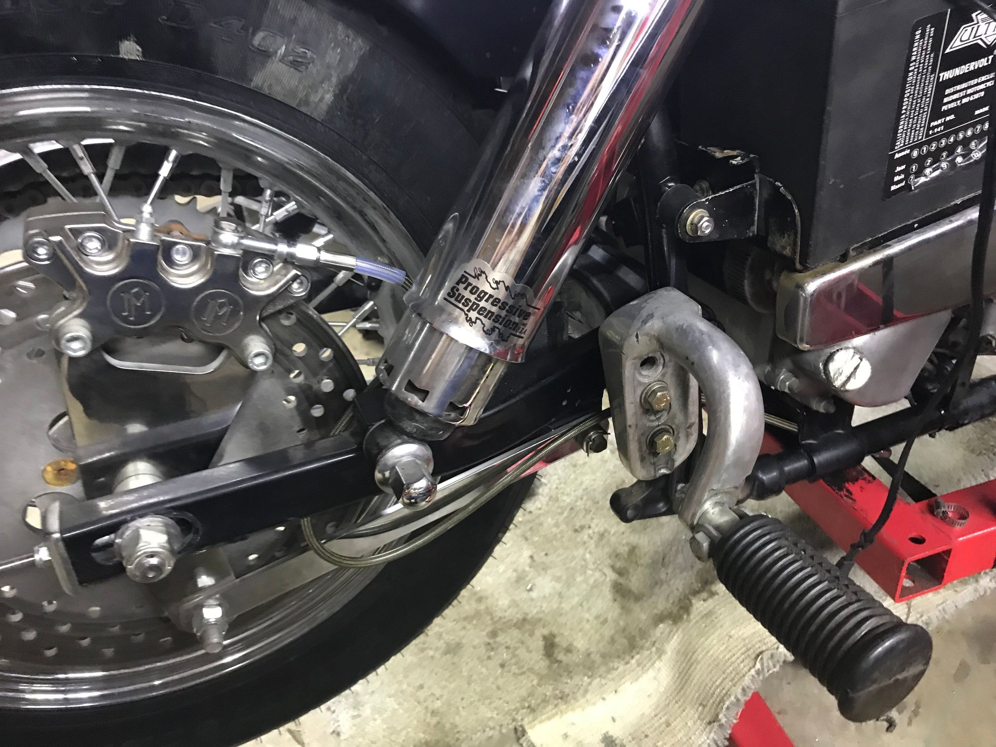

Can anyone who has switched to a Performance Machine rear caliper on a shovelhead tell or show me what they did for brake lines? I'm building a bike that Had one on the back and I don't know what to do for a hose. I can't find anything that will go from the standard shovelhead T by the tranny to the Banjobolt on the caliper. There's got to be a fairly common solution because i'm sure a lot of people run these brakes.

go on mid usa MC book on line - you need to be versed in ends and fittings a bit but one line fitting goes to the master ( you did not say screw in or banjo ) then braded in pre cut to lengths 10 inches 12 inches kind of thing to the front right side trans stud and attach the correct triple to that - Triple > one is the front line, one is the rear line and the center is the brake switch - then you do the rear with a banjo I believe they are 10 MM banjos on a PM caliper to the braded cut to length lines

Just a follow up here, I did go with these brake lines. A warning though: I ordered a universal cable that was the length of a stock one, plus the two ends, which made it a little long. It’ll work, just has to have big loops and be zip tied a few places

Tech tip for playing with custom brake lines, use a length of bailing wire or a coat hanger and bend & route it like you want to run the real line point to point then straighten and measure. Takes the guesswork out of getting the right length.

Yep, good tip, I’ve done that before. This one being relatively stock I figured I was safe using a stock length. Slightly off though

I just had one in here much like yours. I shot the line to the rear and looped it along bottom on brake anchor braket. Dont know how long your line is...
