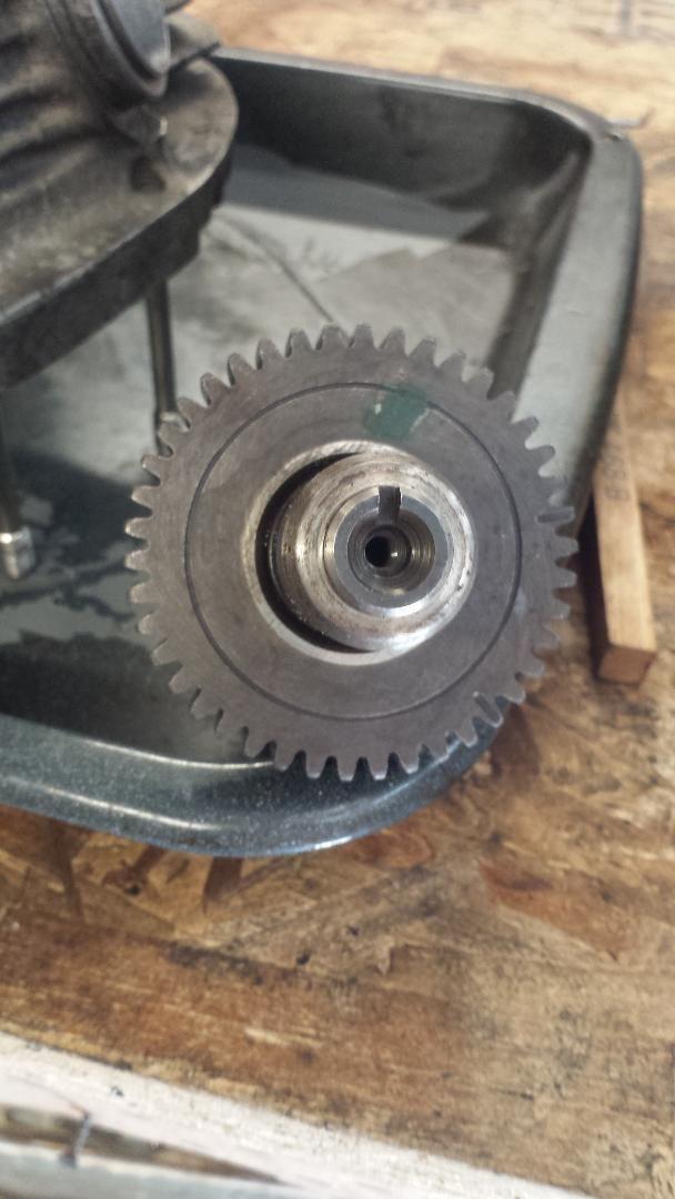

I would like to verify my thinking is correct. Is this an Andrews H grind that replaces stock cam? Same lift/duration as stock?

wow a green gear - red is the normal one I only used a green I think once in all the years
yea your thinking is correct

Thanks Johnjzjz, could you shed some light on what the 'green' or 'red' gear means?

Thanks John, could you shed some light on the 'green' and 'red' gear means?

the pinion gear and the cam gear come in different sizes ( they are color coded ) to set the correct gear to gear lash - the combo makes it like 50 different combos in every direction

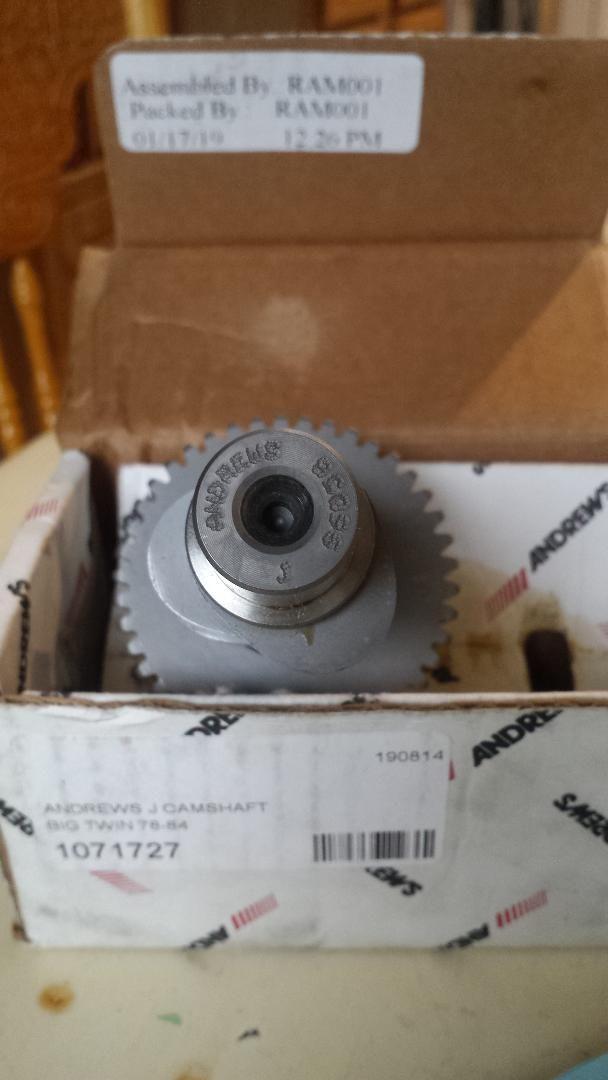

If i change to an A2 or J cam what else will i need to change?

read the factory book on cam gearing and setting

I installed an Andrews J Grind cam into my '77 FXE and no head work was required . It's not the hottest cam in the world but the bike runs better with it than the stock Harley cam. By better I mean a bit more power, very smooth operation, and better throttle response.

I had an "A" grind and a super "B" on my 83 FXRS and I was very happy with that combo.

Got home today and found a surprise waiting for me. Brother-from-another-mother is getting tired of riding alone, trying to help me finish the bike.
