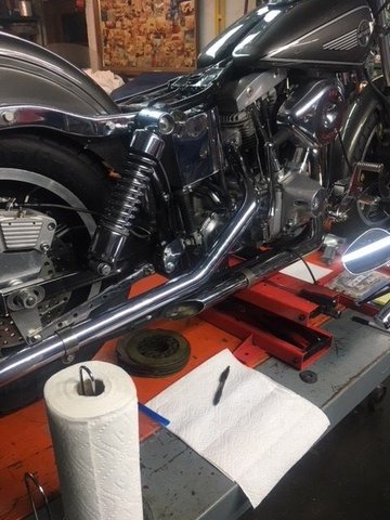

yea I just did one as well but I had a bracket - it is made of round stock with a pair of horizontal flat end tabs with 5/16 holes in them - then it has 2 threaded studs that slide into the rear part of the frame then the clamps attach to the tabs - had to space it a bit to get them to look right but that is the bracket that works
sorry I have no idea what its from other then its for a right side 2 pipe shovel

I will take a picture of the one I have I have clamps on
maybe you can use clamps and they have 2 ways of attaching

this is one of our sale machines we just are finishing up new motor complete and the entire bike gone through and brought up to good running its an 80 FX
