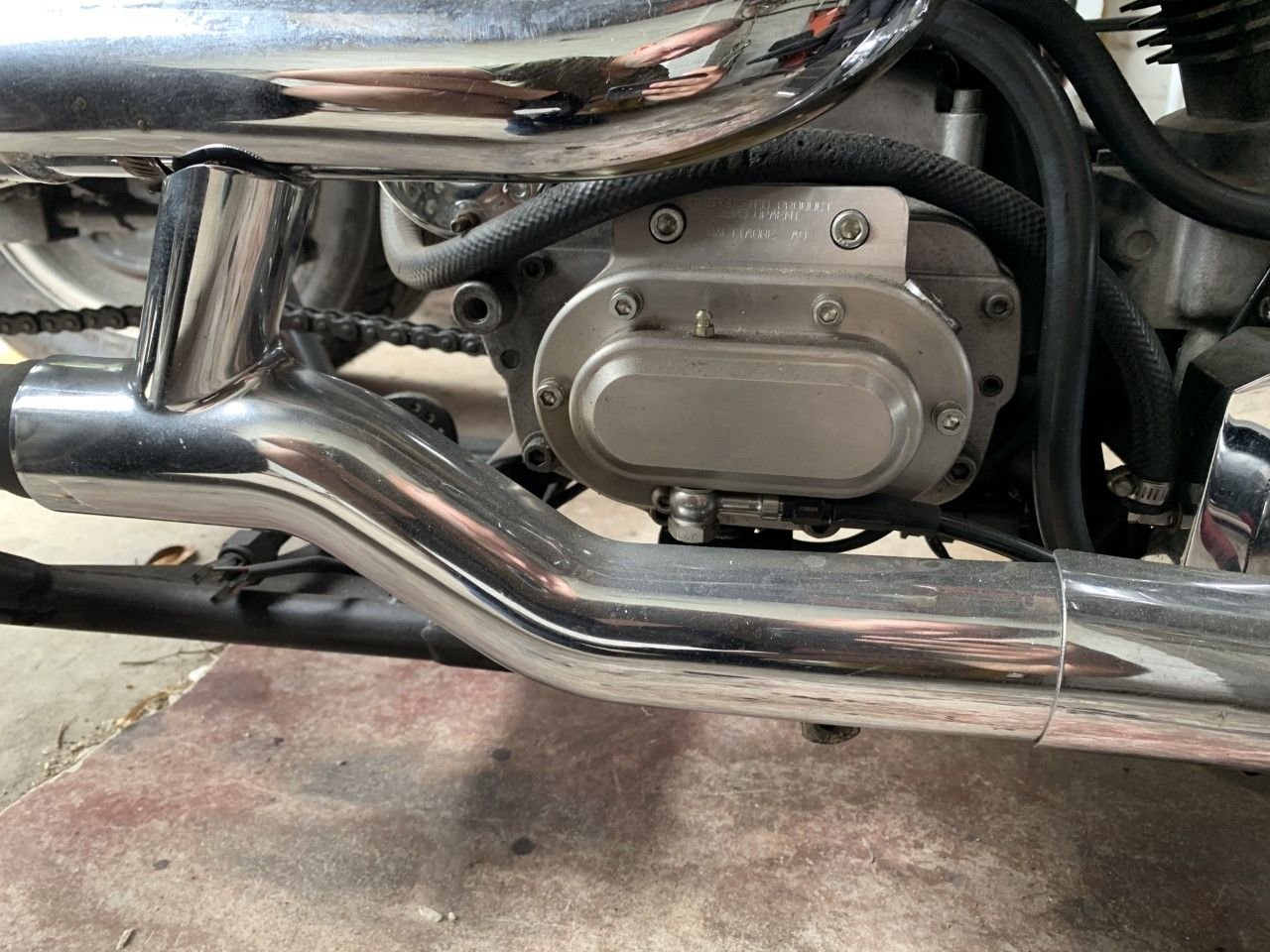

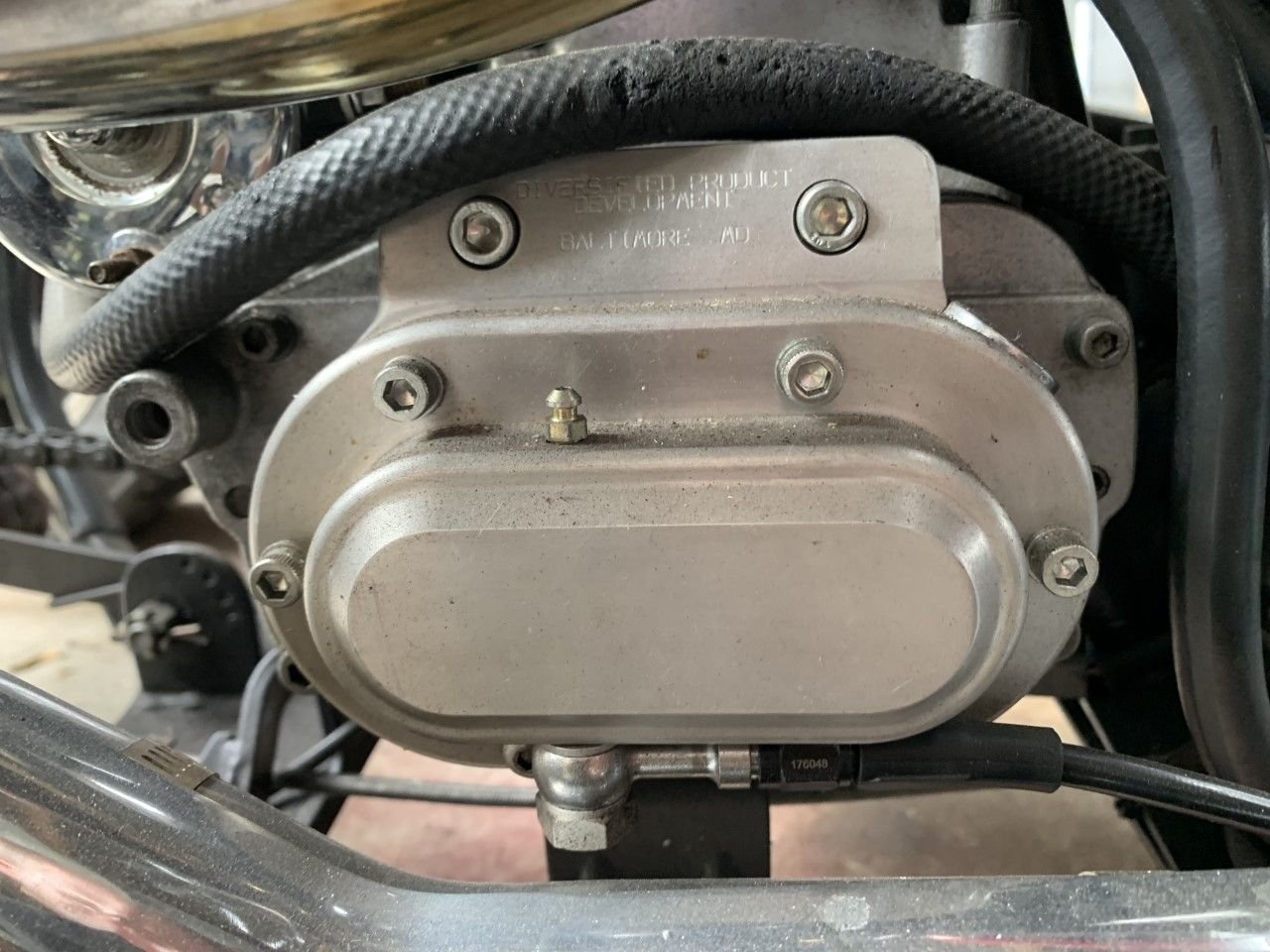

putting a reverse on my trike. the problem is the clutch cover will probably be spaced out .the bolt holding the hydro line will hit the top pipe. 2 options. grind the head of the bolt down half way. might just clear or put a indentation in the pipe.what would be my best way to do the second option thanks all

you need at least 1/8 inch of material across that will connect to the piston location perhaps the front of the cover machined into the piston area = could work you need to look at movement of the line and plugging the original spot

Turn it Upside down!!!! not gonna bleed good... but.......
Otherwise...if the insides do not co-operate... like John says... put that banjo elsewhere...

thats a perfect solution if it works with the inside.as they say theres ways around everything thanks guys
