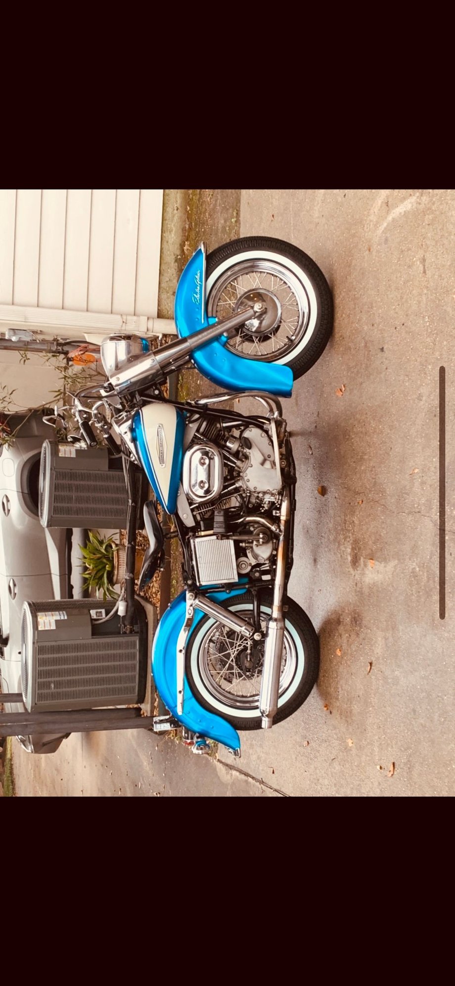

Hi all - I have a 67’ FLH picture below - the electric starter works well but after it cranks if the bike doesn’t catch it makes a really ugly whining “rrr” noise - that takes a second or so to slowly die down - bike is new to me but it doesn’t sound normal - I’m traveling or I’d provide a video but just wondered if it was something obvious that is a typical problem on these. Thank you

Time to chage the Bendix gear

Thank you - my dad said that’s what it sounded like (he knows cars fairly well) but didn’t know on bikes. Thank you

could be Bendix but check the needle bearings in the starter housing also nice pan shovel
