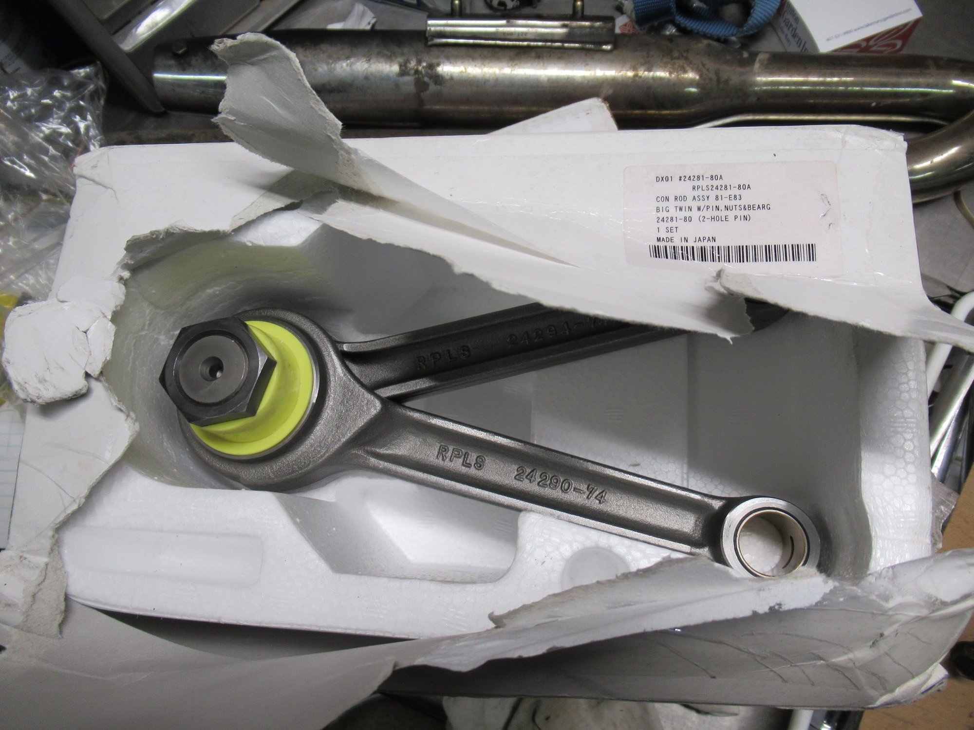

I got the new rod set. The box wasn't in good shape when it arrived, but the parts look OK:

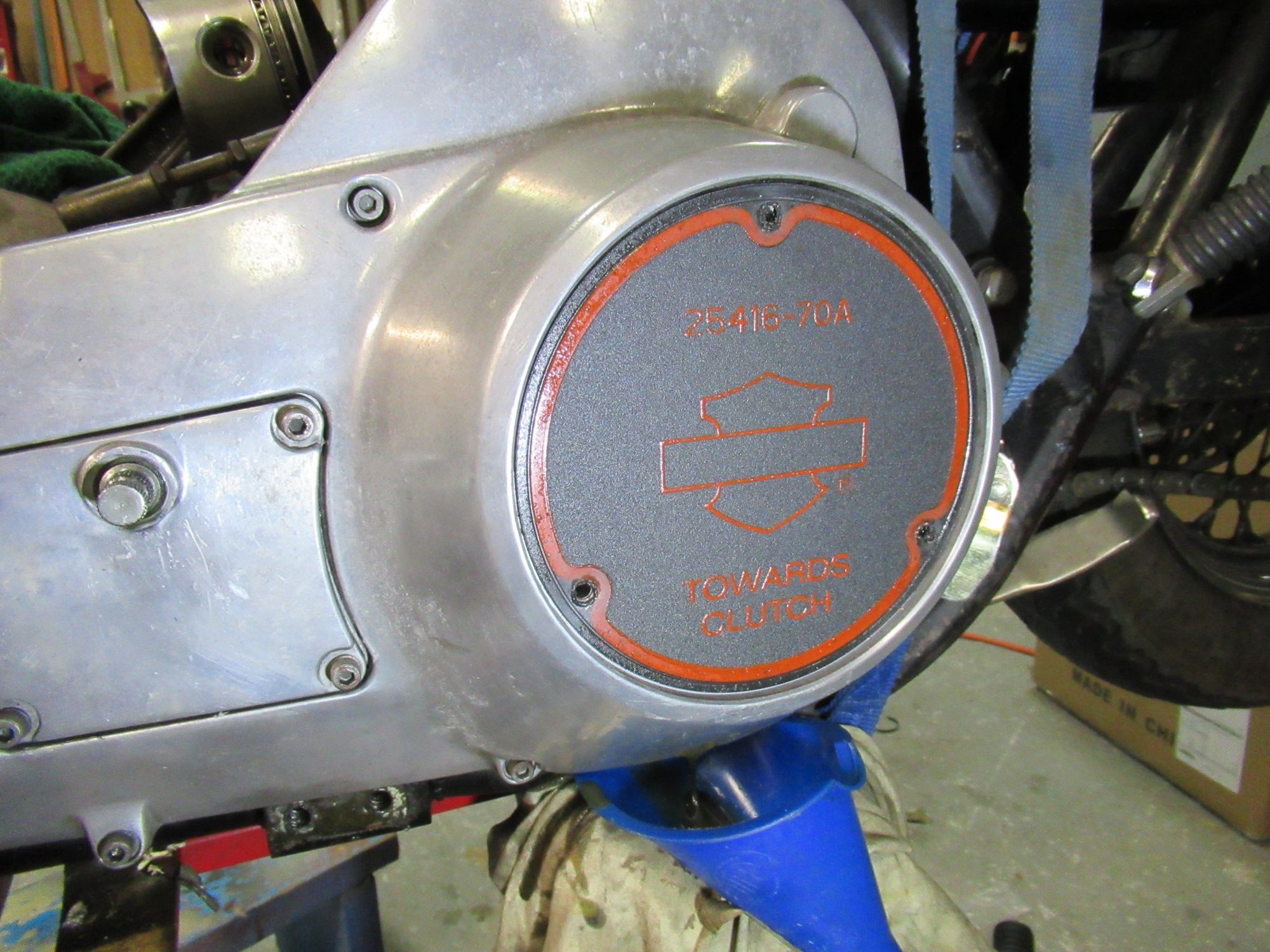

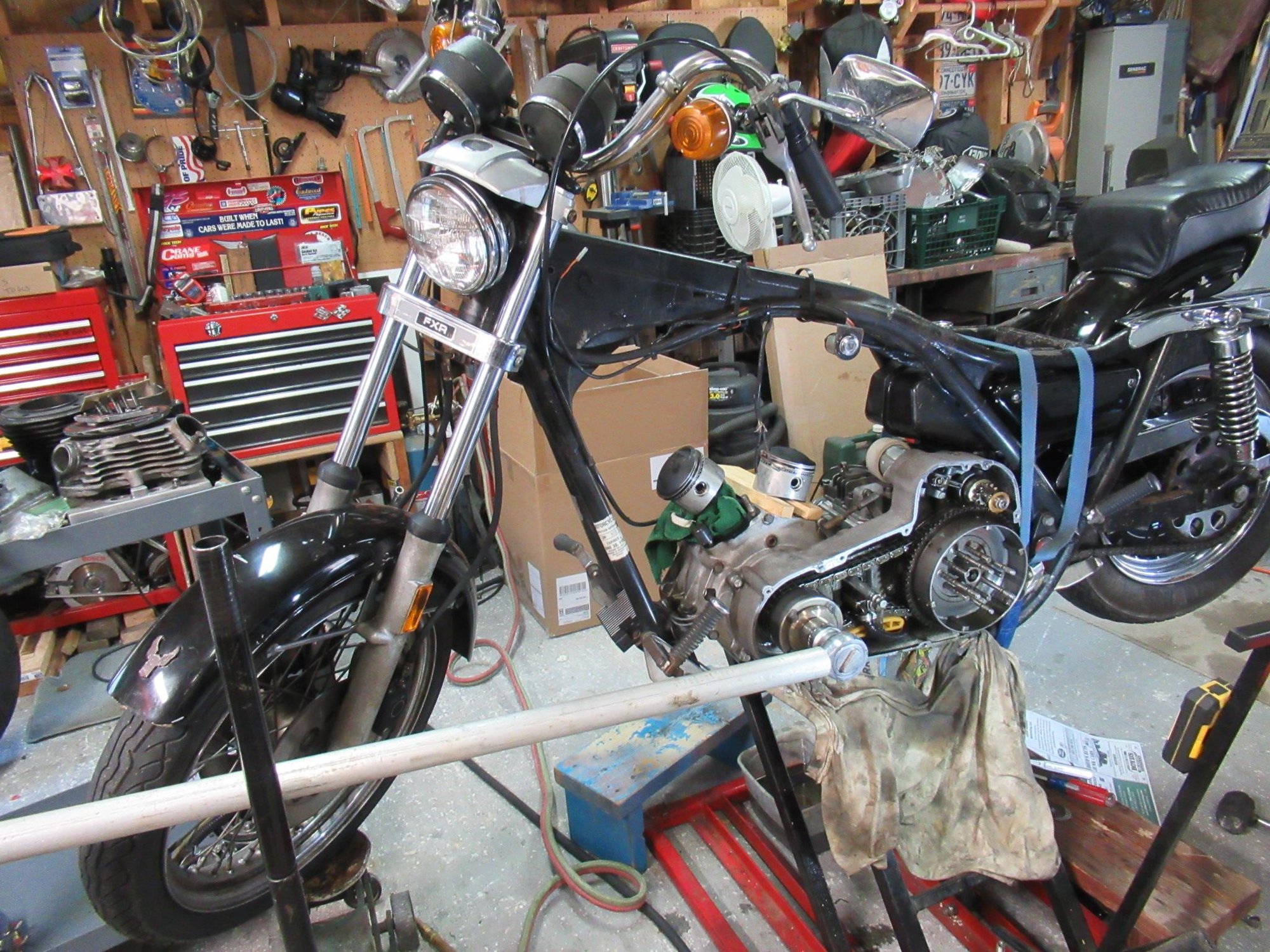

I had a couple of days to work on it and I got the primary case off. After I clean off my work bench, @Uncle Larry, I'll pull what's left of the motor and put it on the stand.

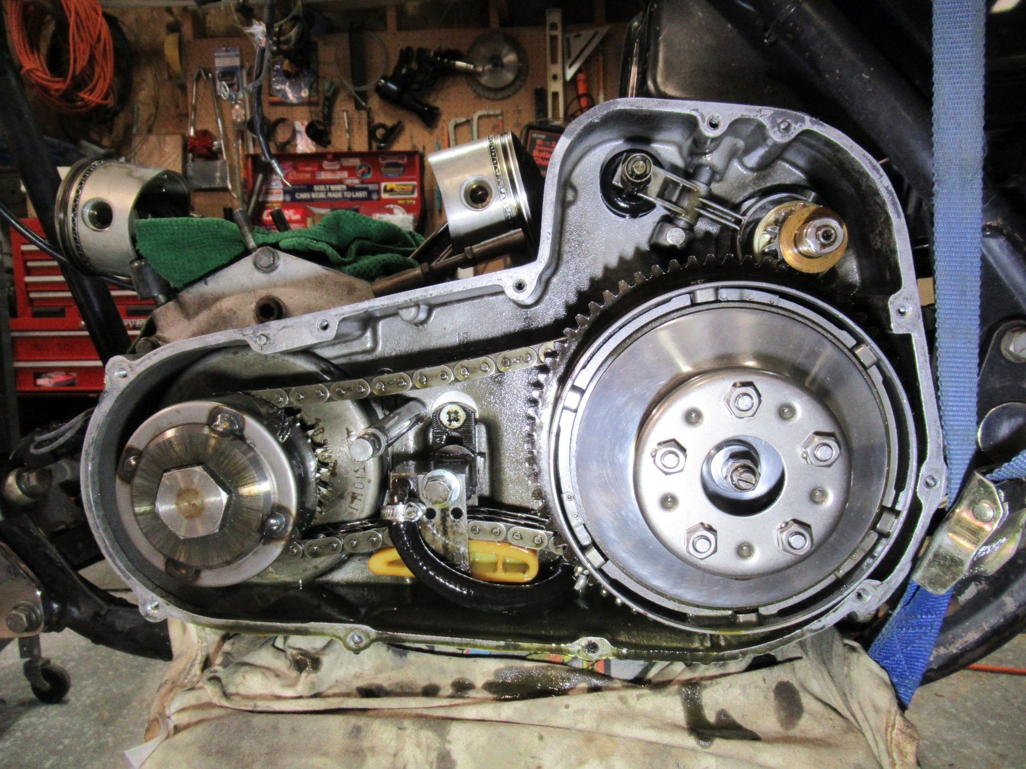

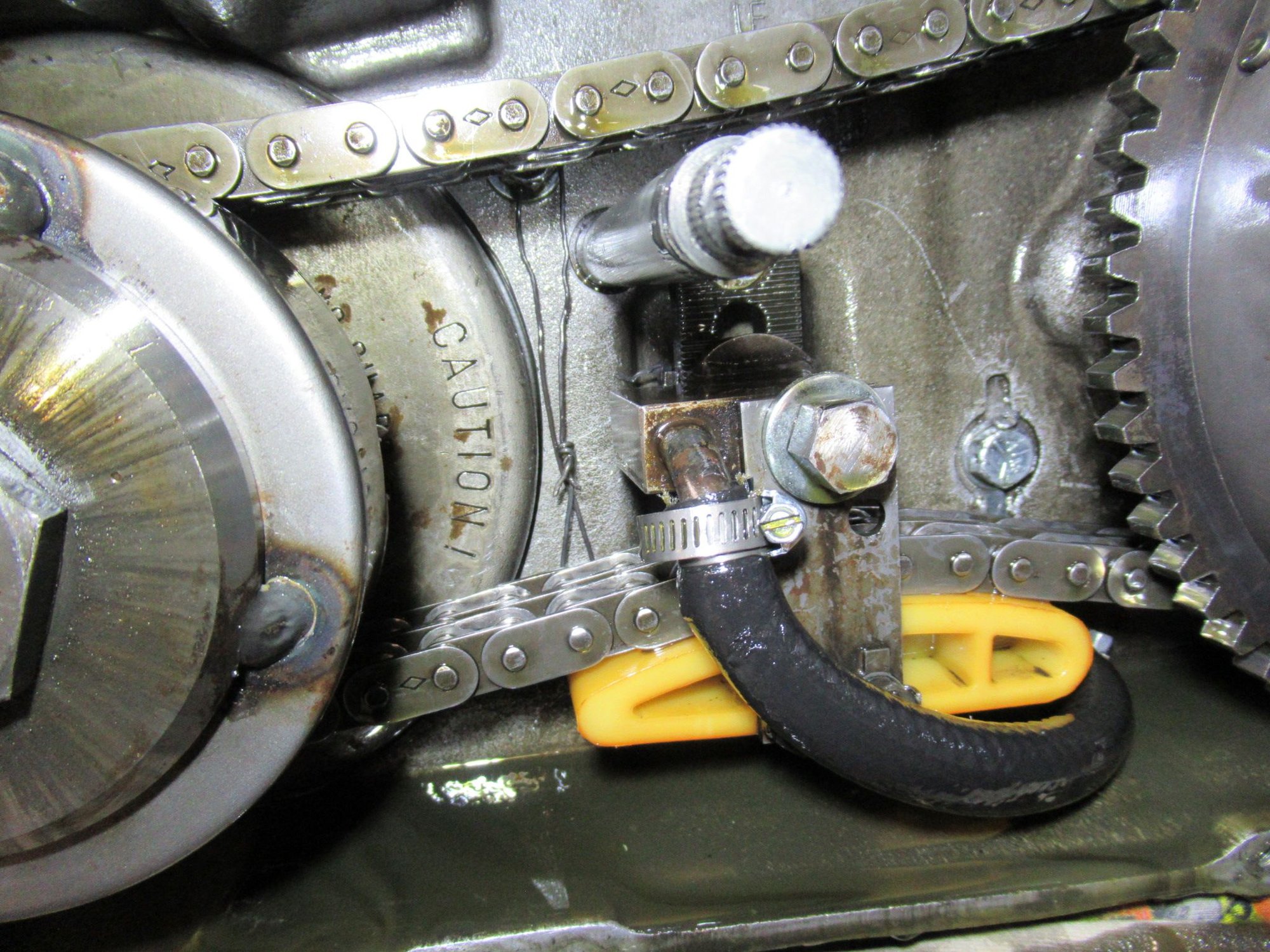

First remove foot peg, shifter and outer primary. The previous owner installed an aluminum pressure plate and 5-stud clutch. But I think the chain adjuster shoe is backwards?

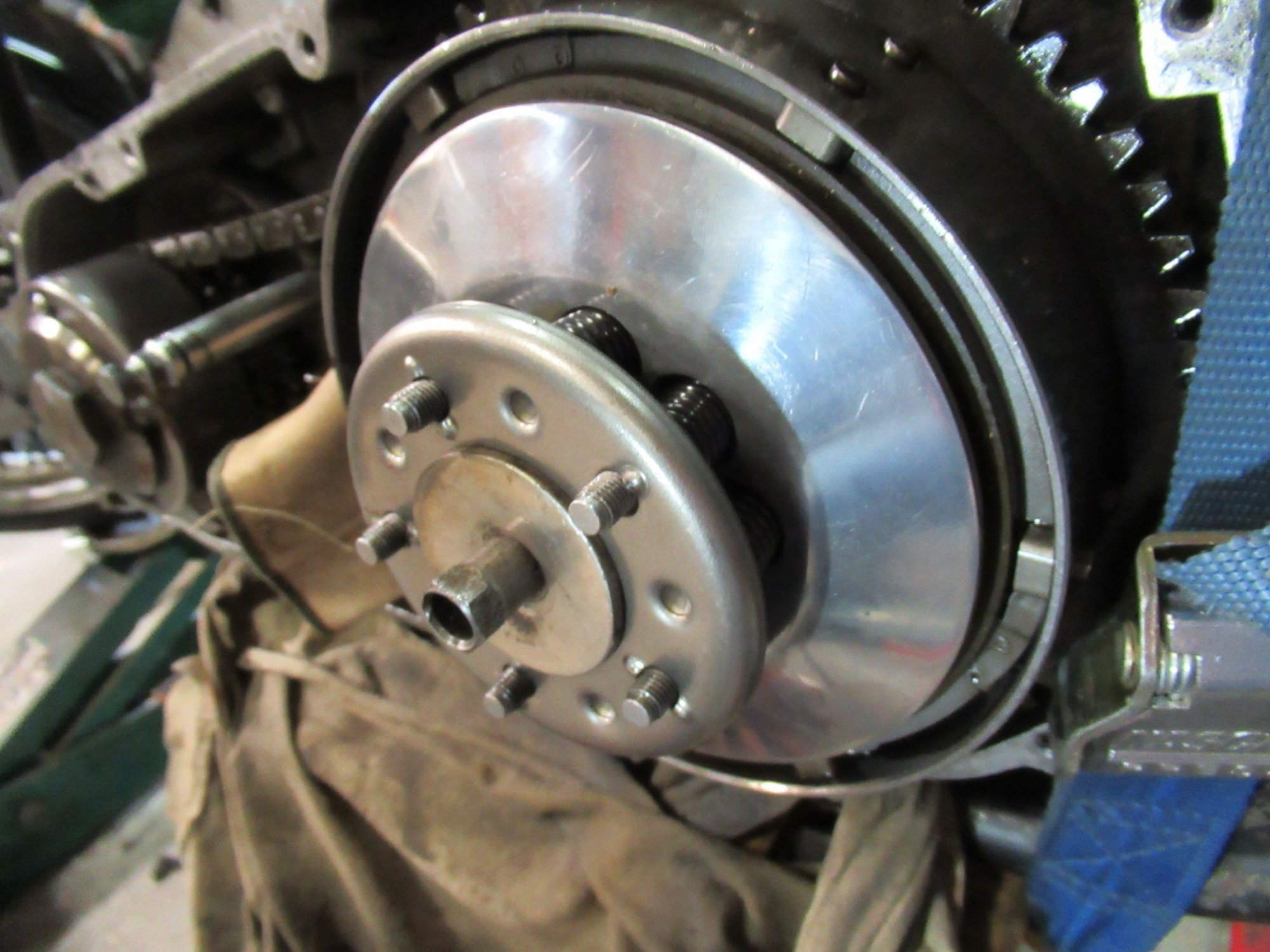

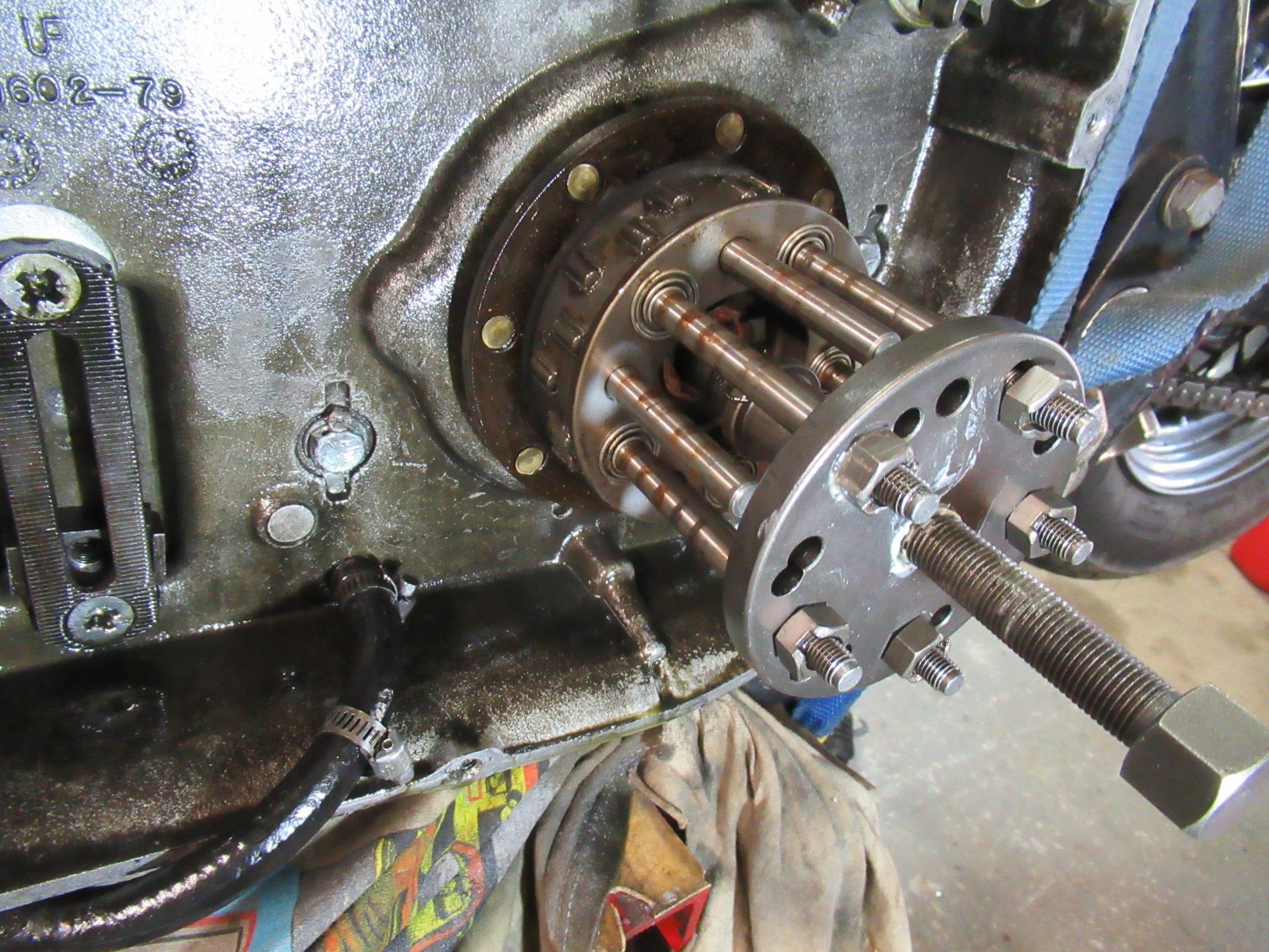

Big washer to compress the clutch springs and remove the pressure plate as an assembly:

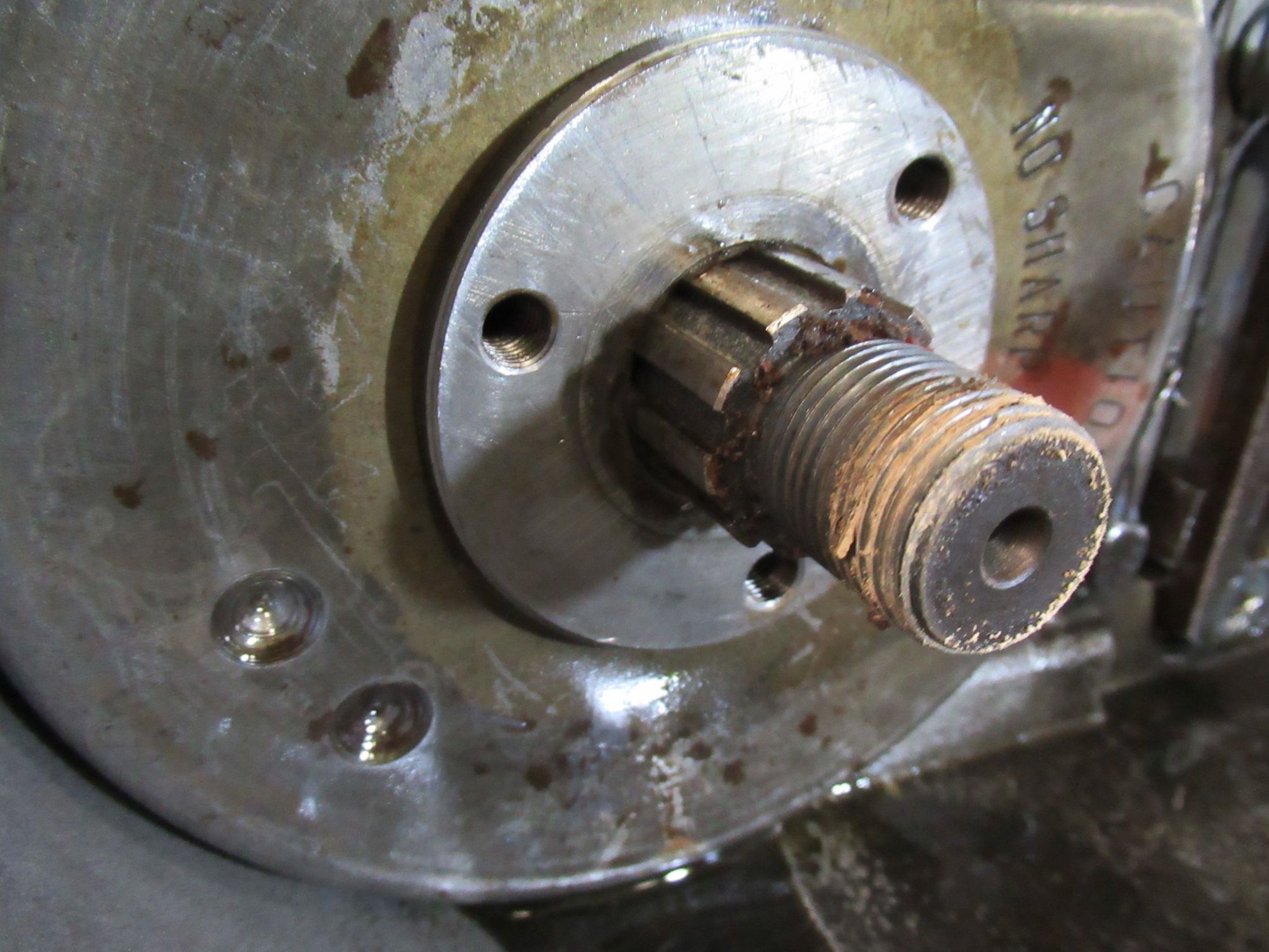

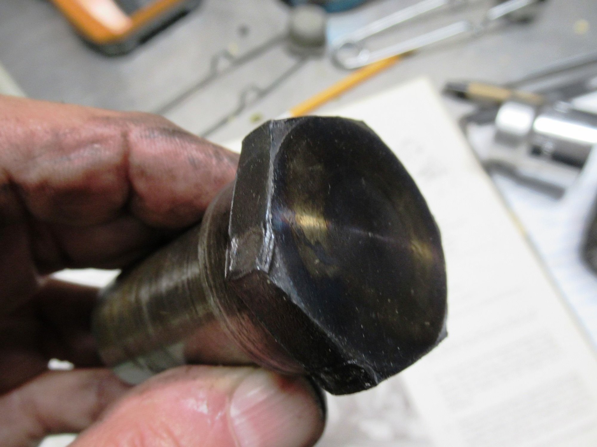

I had a bear of a time removing the compensator nut. I tried heating it with propane and a 1/2" drive breaker bar, but it just flexed the breaker bar and didn't loosen. Then I broke out the oxy/acetylene and that didn't work either. I tried my Snap-On 100psi impact wrench and even that didn't work.. So I borrowed a friend's 3/4" drive and a 4-foot cheater and it finally gave in!
Whoever was in there last used RED LOCTITE! Gaaahhh!

The splines look good, but the nut is shot. The damage was done before I got there, but I turned it purple.
Clutch hub came off without any drama. I locked the rear wheel and put it in gear to use the puller. The studs are dirty but smooth, and will clean up well.
Bastid!

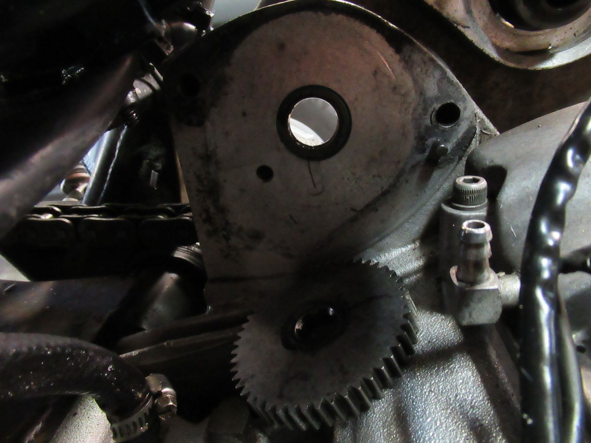

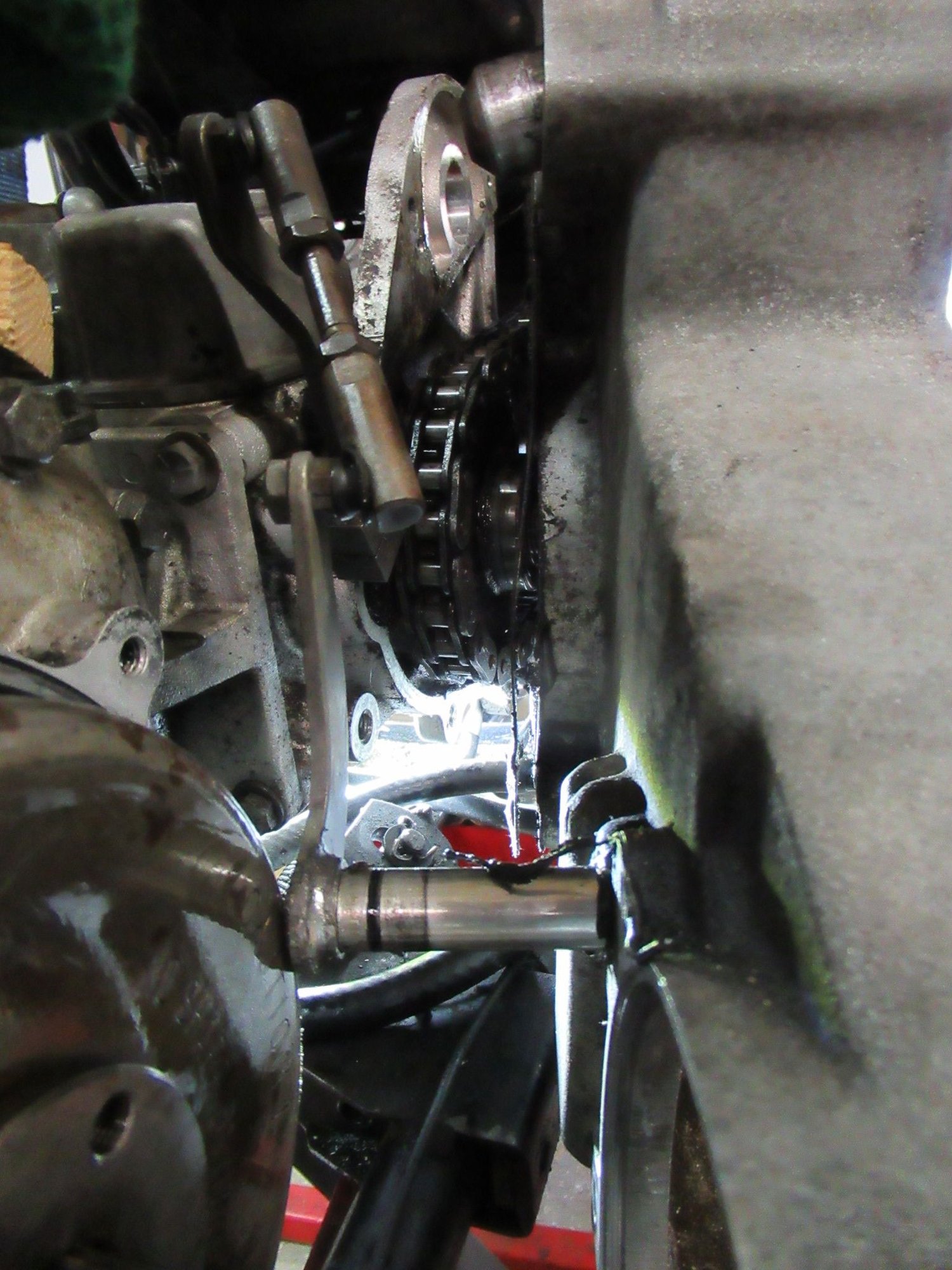

Removed solenoid and starter following the shop manual. This looks like a newer solenoid, because there are only three terminal posts and the manual shows four.

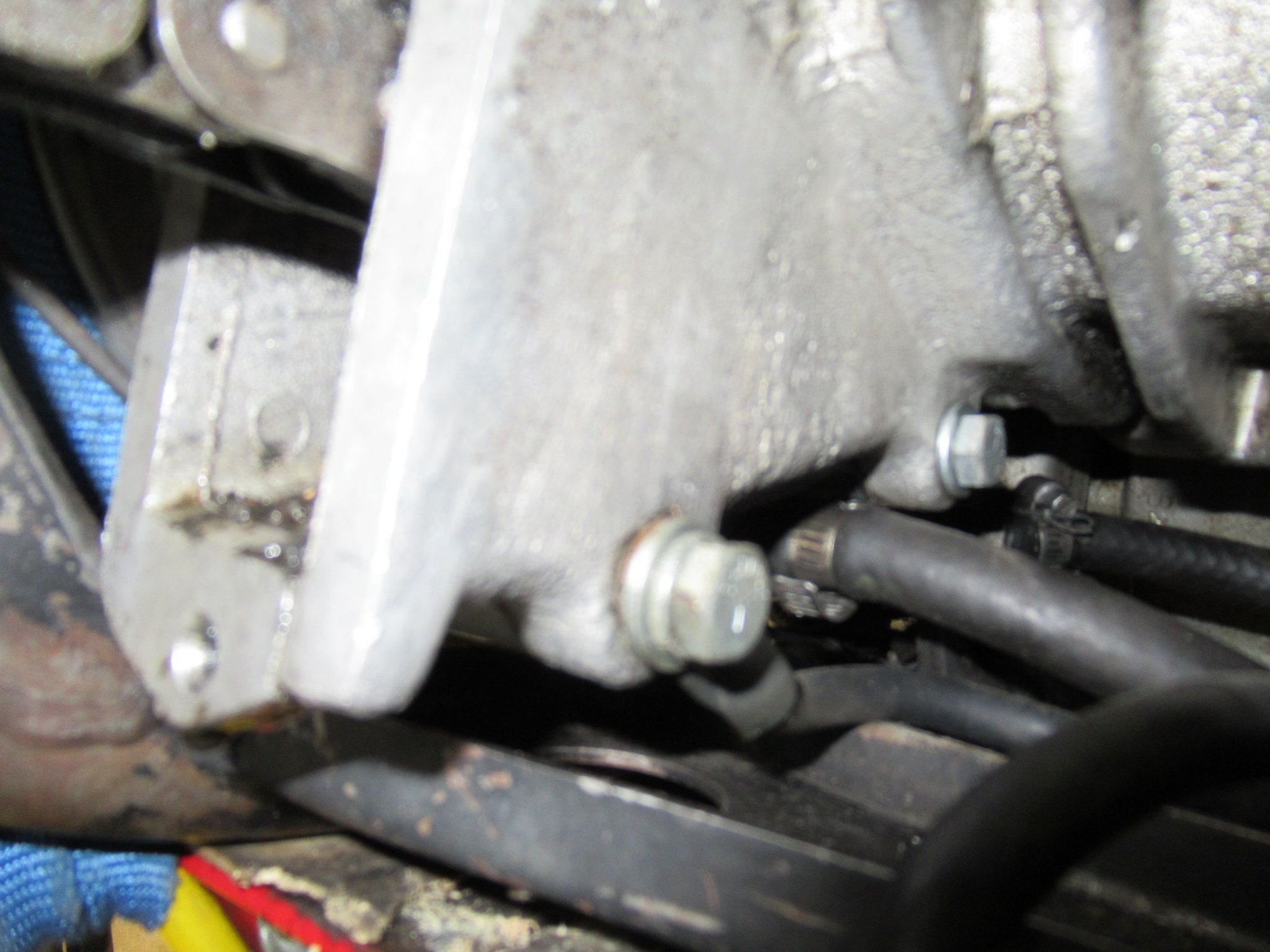

These bolts weren't too difficult, good to see someone added a ground cable. I had to cut the hoses to get the inner primary off, so it'll be fun to put new hoses back in.
With all the other bolts out, the inner primary came off easily. The inner primary bearing stayed where it belonged, on the main shaft, and the shift linkage came out without too much trouble:

Whoever was in here before me left me a couple things I know are wrong, that I'll do correctly when I put it back together.
