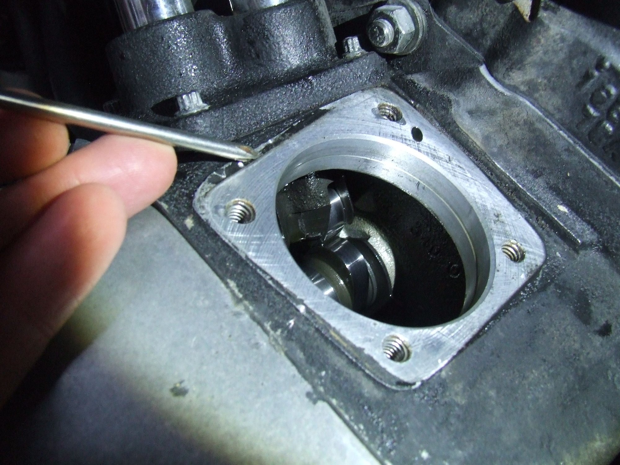

Okay, gaskets and new o-rings turned up the other day so this afternoon I took off the front cylinder push rods and tappets.
I was surprised that with piston at top dead center, there was no perceivable play in the push rods once the covers were raised. Perhaps this is normal for hydraulic type lifters?. On my old Guzzi that had non hydraulic lifters you could always feel the movement of the valve clearance. If someone could explain this I sure would be interested to hear about it.
Anyway, everything came apart reasonably easily. The gasket came off both surfaces without too much sticking. I have cleaned all the components except the hydraulic units which are sitting in a bath of oil. Wondering if I should scrape away the black engine paint that is on the edge of the machined surface the tappet guide sits on (see pic) or just leave it as it is.

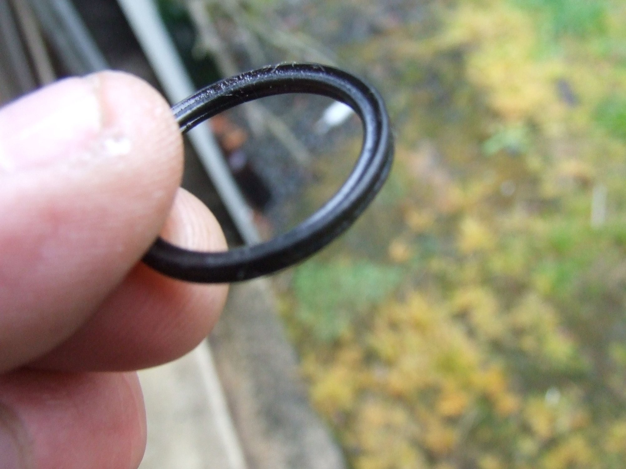

Another thing that has got me concerned is that the seal at the bottom of the push rod cover where it fits into the guide should be according to my service manual a "Quad seal" for 1981 and later models. The seal set I have however has 12 various O-rings in it.
I had imagined that a quad seal would be a square sectioned seal. Following picture is of the seal that came out of the bottom of the tube. Do you think this seal started off as an o-ring and has just taken this shape after 36 years or would it have originally been a 4 sided seal in section?. I may be worrying about nothing but it would be nice to do the job properly the first time.

Scrape the paint off.
Others will be awake shortly to answer your seal/O ring question. Good luck.

you got the wrong seals from a moron who knows nothing - let me guess JP cycles china emporium
the later shovels have quad seals the one in your hand is an example of the right seals and NO the o rings will leak
paint chips really

the center o ring you can use a standard size like - the black one in between the two browns that are evo top o rings - the blues are early panhead and shovel up to 1977 or so seems to be a mix at first when the quad seals came along - and we see a blend as people change stuff around all the time - the old quad seal in the end you can re use it if you have to just smear hylomar on it and install before adjusting
