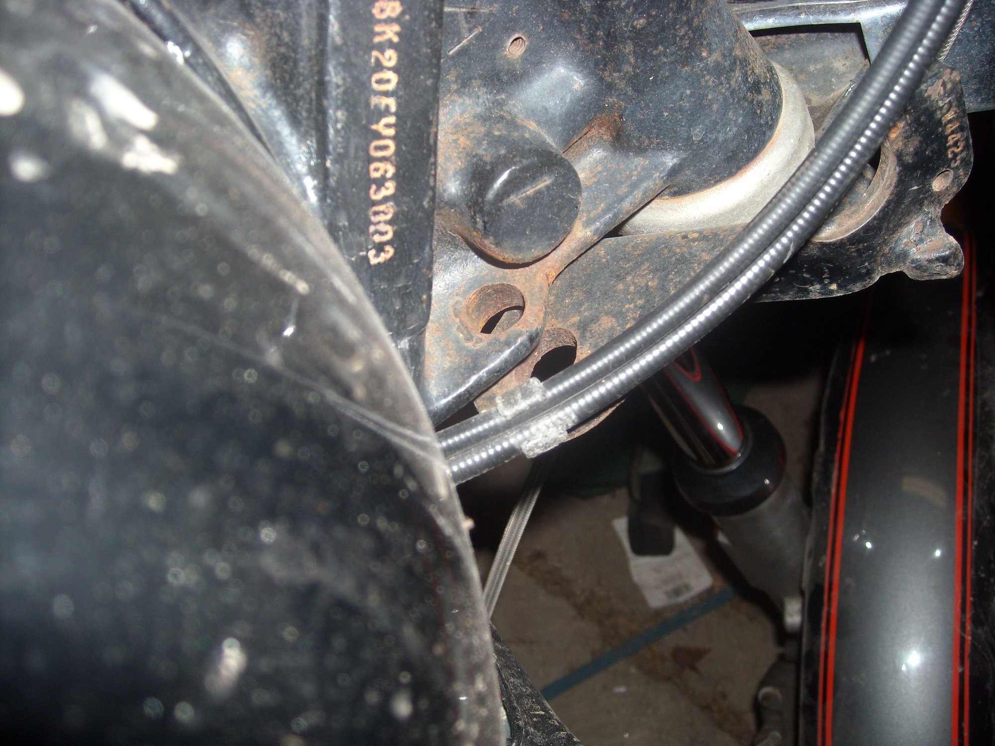

Here is my stem. Use my picture as evidence. My serial number is a bit lower than yours and the "E" is starting to get weaker than it's surrounding characters.

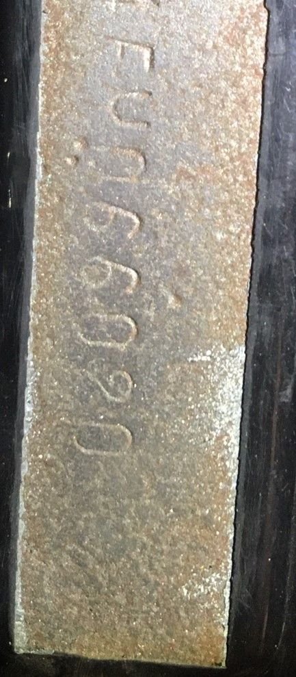

Originally Posted by Alexander Pearce
How I am going to also convince them that the F should be an E and it was poorly struck is going to take a bit of talking.
Alexander, I agree the alleged F may be a poorly struck E and I’ve seen it happen before. Also, if it was F then I would have expected that short horizontal stroke to be higher up the vertical stroke.
Have you calculated the check digit? It is the ninth character and it is used to help confirm the authenticity of the VIN. It can be calculated via the chart below.
Eric
Eric
Well thanks for that info SBT, I have never heard of that before.
