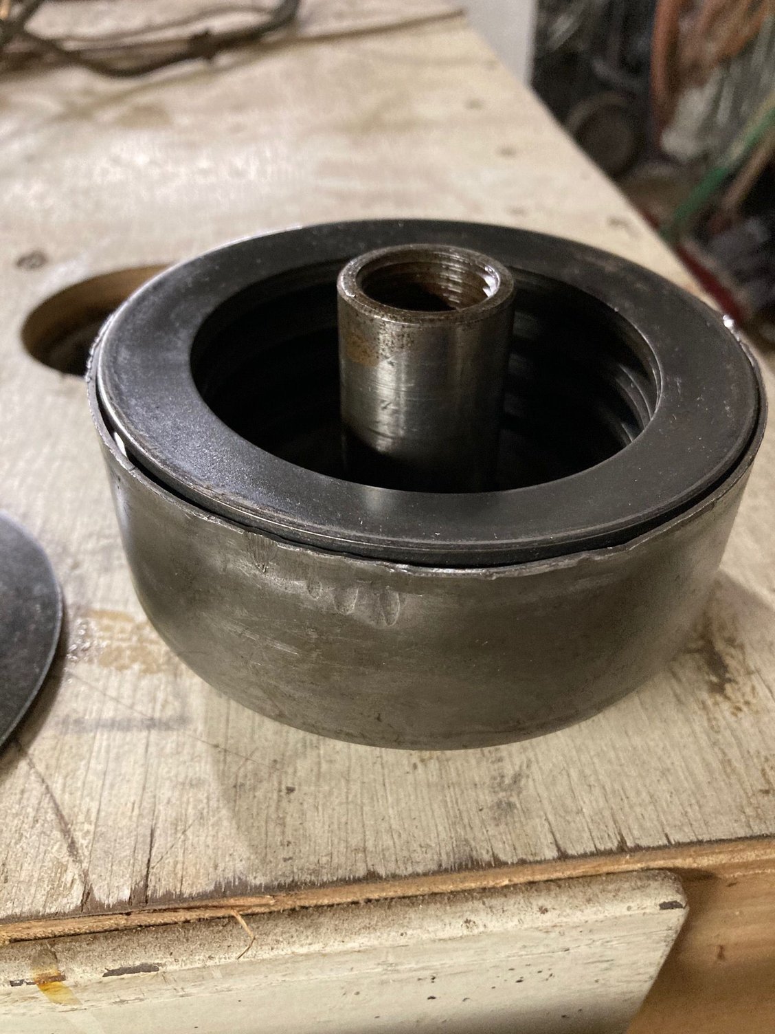

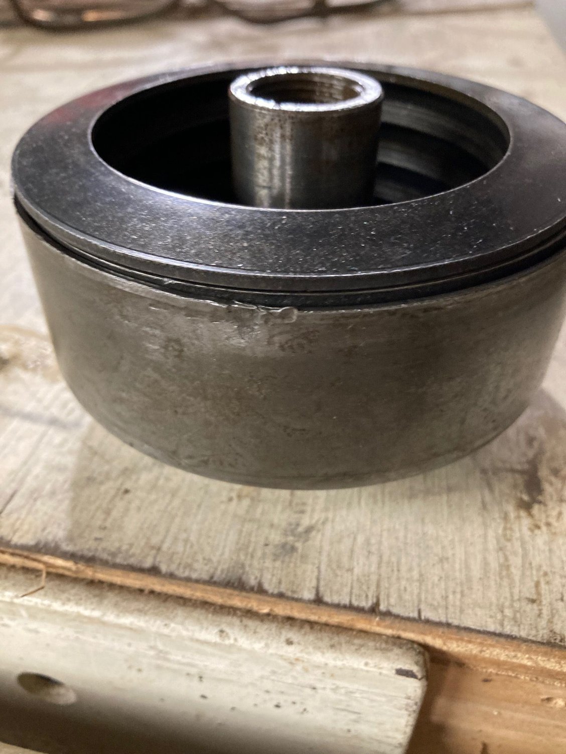

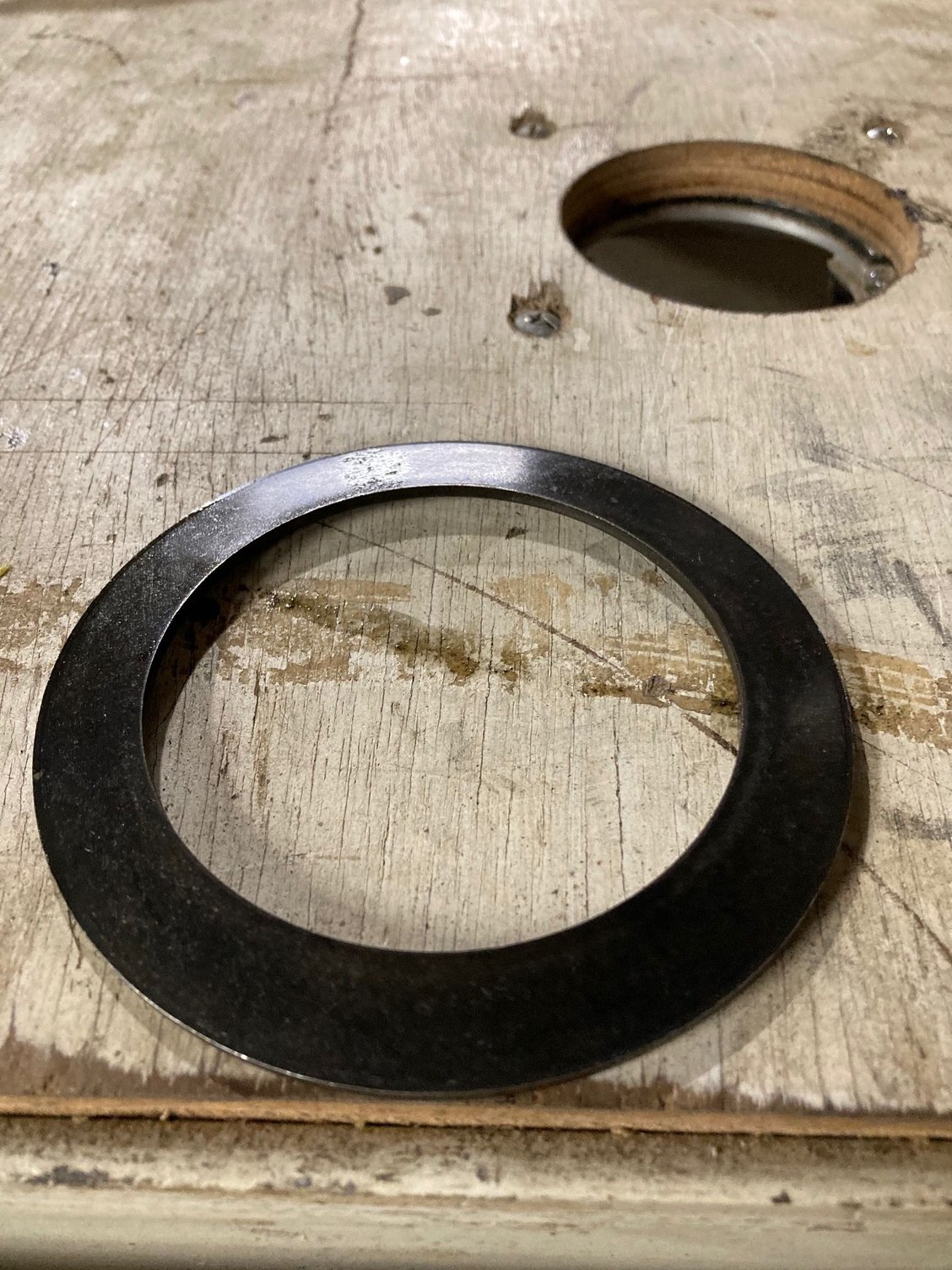

Is this compensator any good? Don't know what happened here, was like this when I removed it. Looks like someone had a problem removing it at one time perhaps? Also how many of these rings should there be?

When they do that we just buy a new one as the center nut location if you look close is caved inward and the body is distorted
its close to 40 years old and has been impact on and off - what 30 times - even 10 times - seen them destroyed in 1984 from morons with impact guns in shops and the bike was almost brand new
your choice but if it comes apart at 60 MPH the engine case explodes and oils the rear tire good
