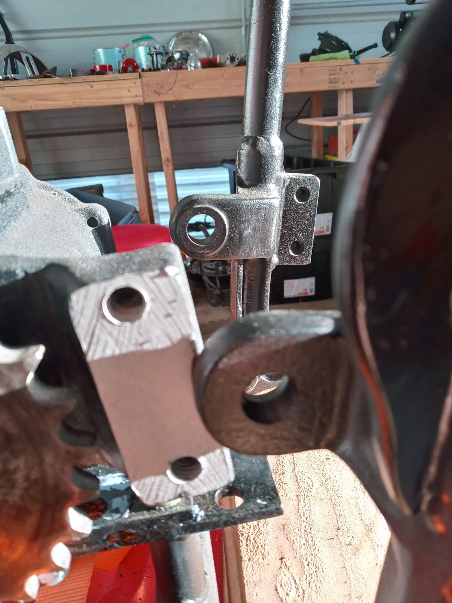

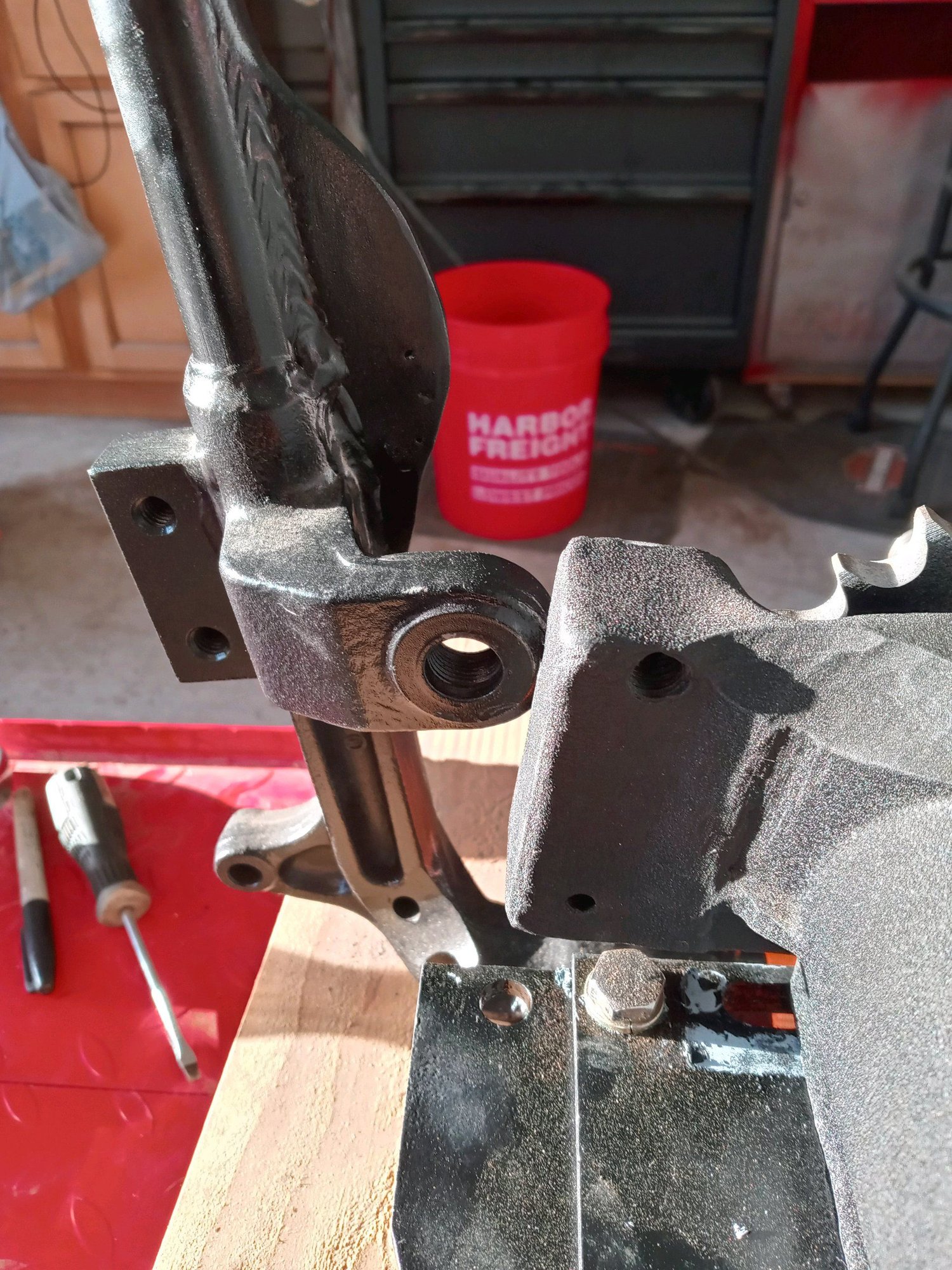

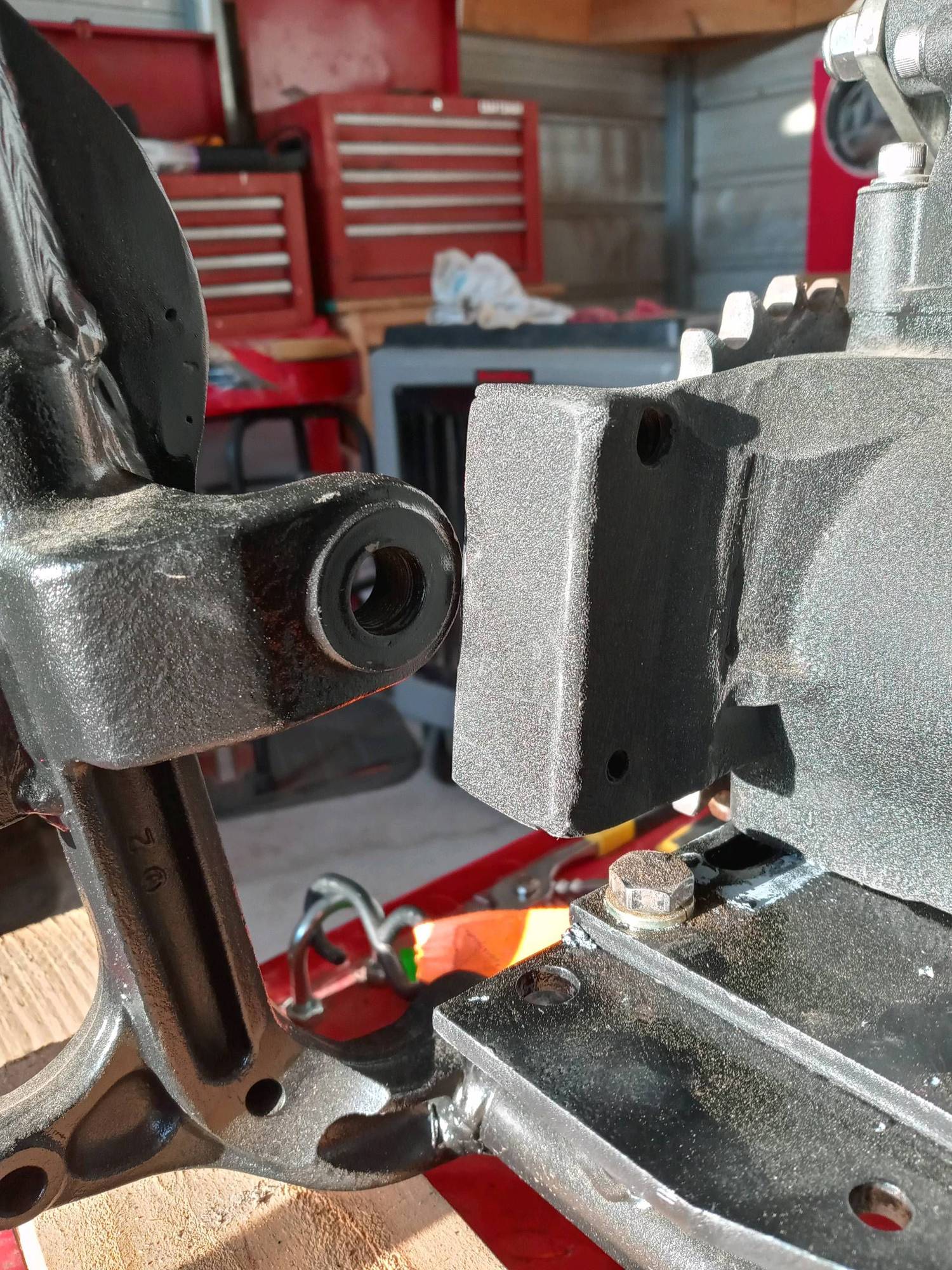

Got a buddy having an issue with a basket case 67FLH he is building..
the Transmission case has no cutout notch for clearance of the swingarm..
Trans is supposed to be 1980 shovel 4 speed..
here are the pics he sent me, any ideas?
all the pics I have looked at there shod be a half moon cutout to clear the swingarm.

Looks like that transmission has been repaired sometime in its life. Can't you just take a carbide burr and build a new notch?

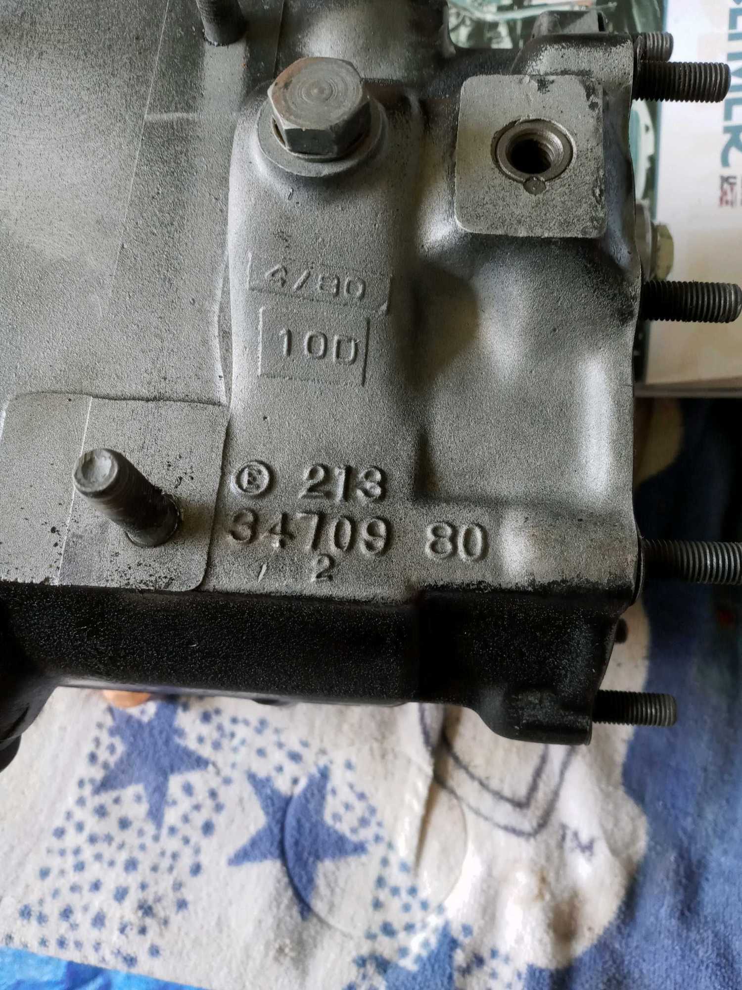

That cut out remained even for late-model Shovelheads. Your case is 4/80 (April, 1980). Looks like someone may have cut the tabs off at one time (or they broke off) and then welded a plate back on. You are definitely going to have to notch it.

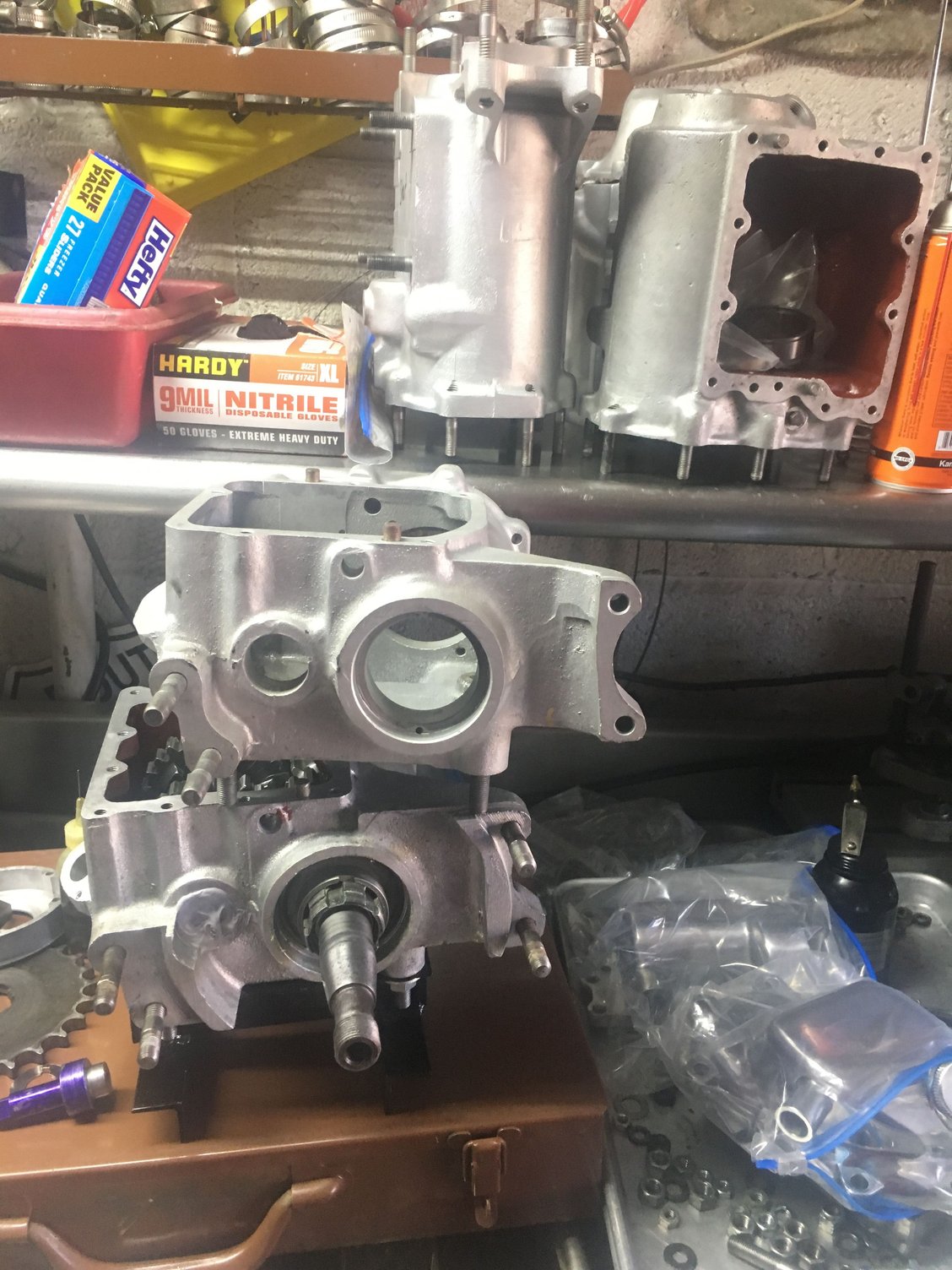

The back side would have looked like this
John's pics are perfect re: early and late model transmission cases using the e-start system.
Can you post a pic of the front side as well where the part was added?

they do mix and match the engine that you have - you need some pictures of the left side case block off the numbers after the FL FLH what ever it has
