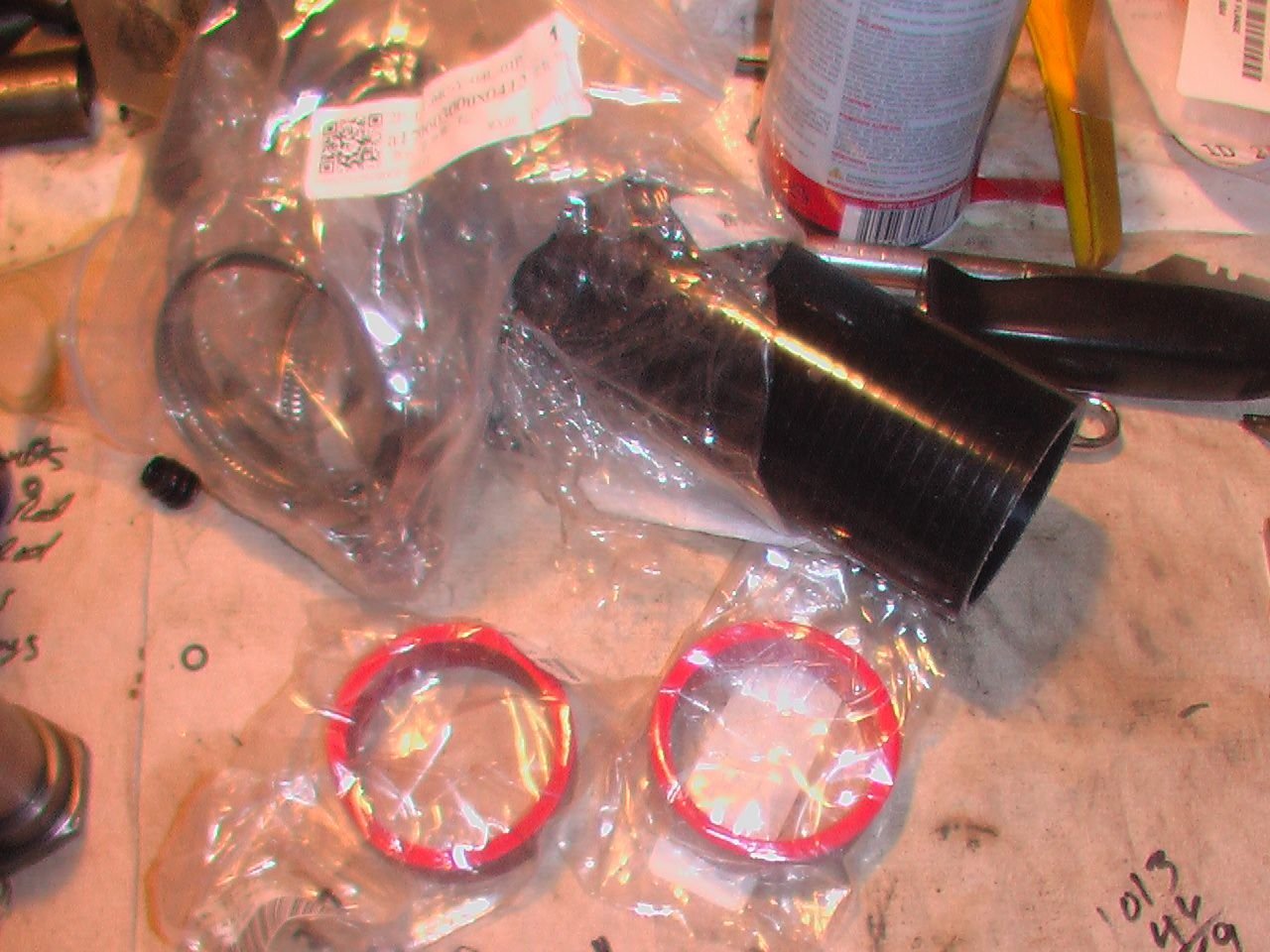

Dennis Kirk has the bands JZ is talking about - they are really cheap if you buy them from them - like 2 bucks - I frankenstein a lot of bikes cause I chop - when you first setup the intake - did you tighten up the band clamps and look at the gaps between the head and the intake? Tighten them - when they are tight enough the band will flatten enough so it actually looks like it is wide enough to cover the spigots - I use high vacuum grease on the bands - it is a Dow Corning Product - second - once you rhave the brace tight - you should be able to loosen then the band clamps and the intake should not move - if it moves - the brace angle is eff'ed up and it is pulling the intake - 3rd - I always add the back brace from the center stud bolt to the back of the intake on all my bikes - I also have 2" silicone pipe (used on turbo applications) and 8mm band clamps and make the super seals that are sold commercially. Anothe rthing to be sure of is the clamp quality and condition - if the band clamps are bent or krinkled - they will pinch the bands - the silicone bands are much stiffer - the James bands are rubber but are also pretty stiff - I use the James bands from time to time and they are okay - on both the 83 I just finished and my 81

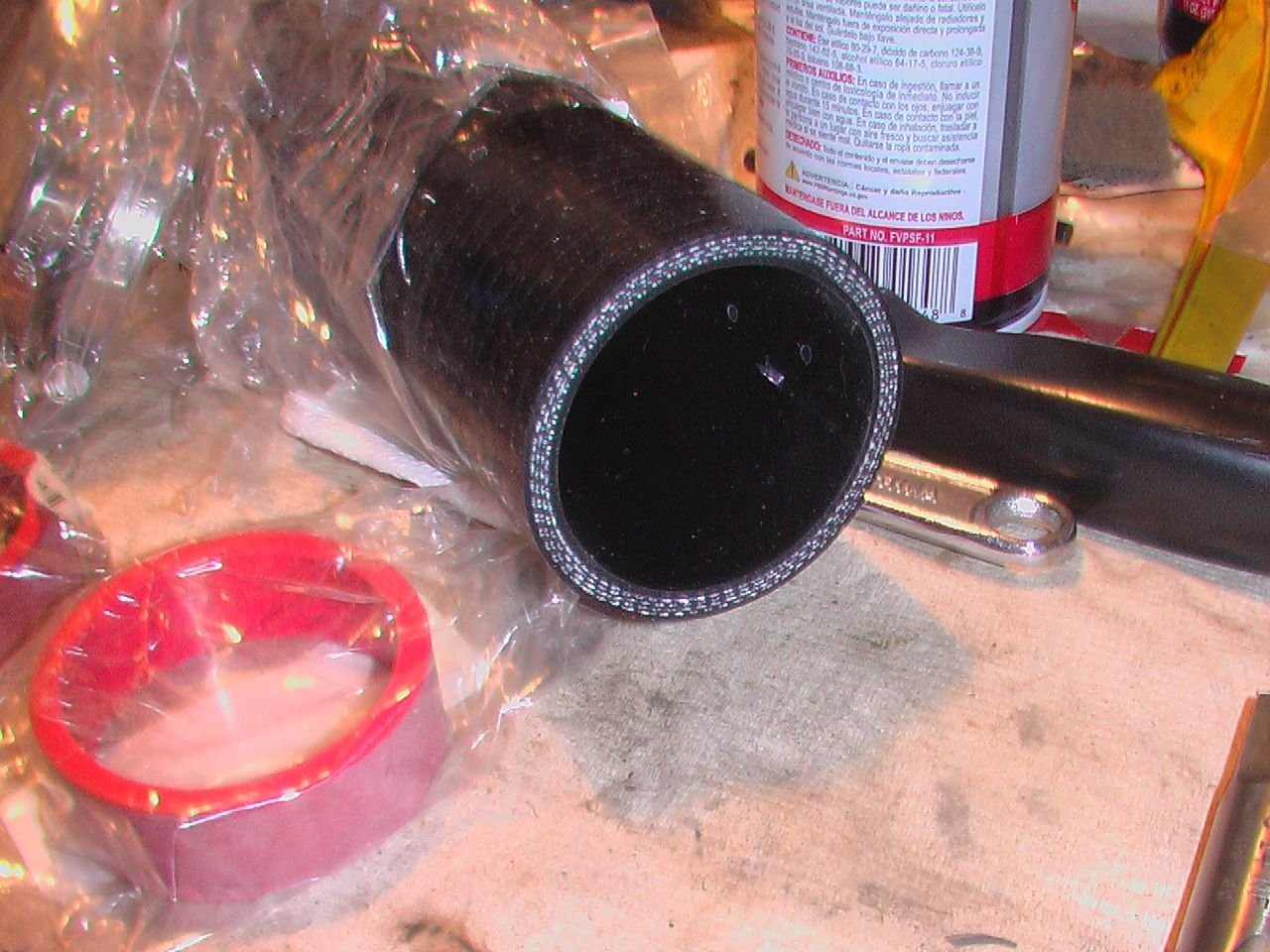

here are the reds from Dennis Kirk (which is near my house) and the tube I cut to fit if real problems continue - 8mm clamps - 2 per side - kits using the 4 clamp and silicone tubing are sold commercially
