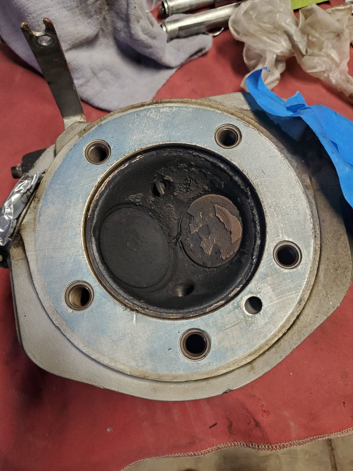

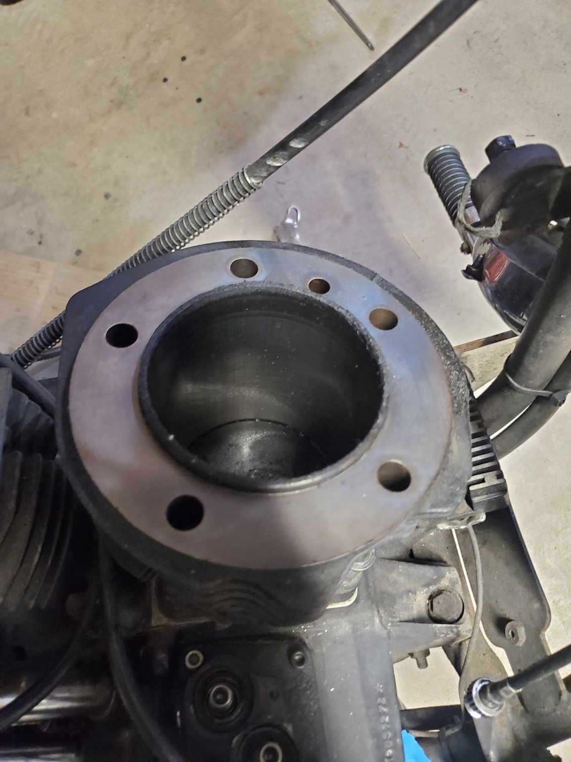

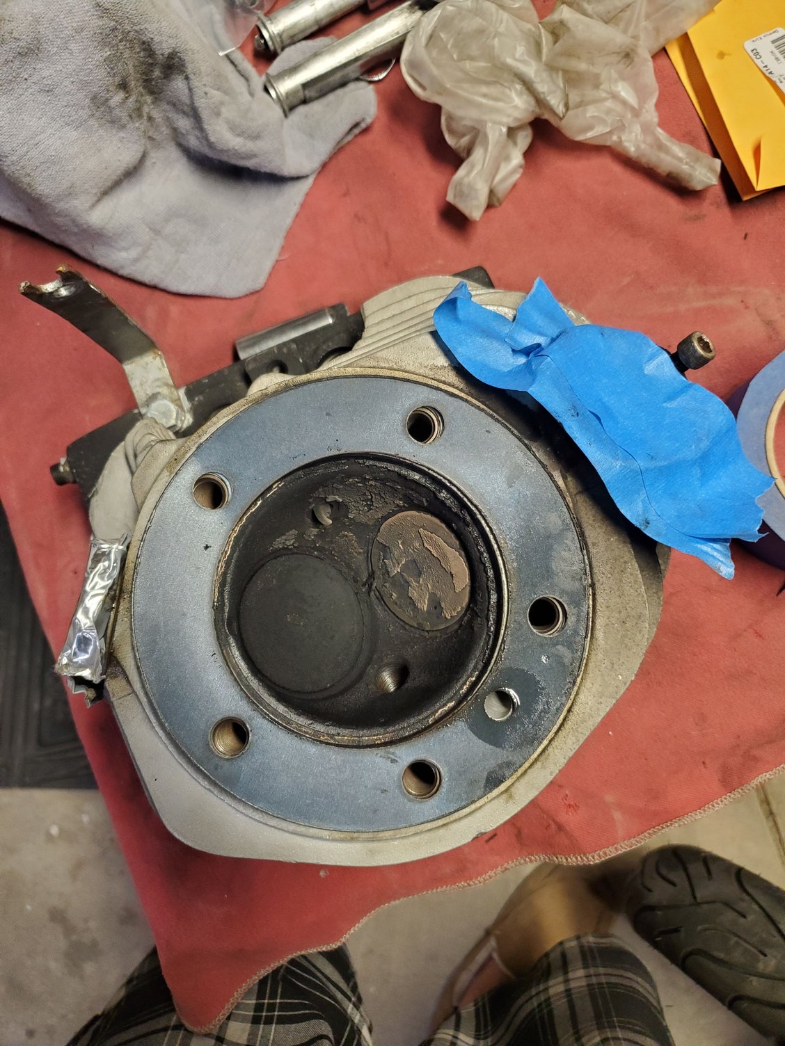

Hello again everyone, thanks again for the advice. I finally got a chance to start on the teardown. Service manual and pacific mike were a big help. So far I've pulled off the front head and it's not looking too bad. You can tell it was leaking but the heads aren't looking wavy or too bad. I included some pictures of the front head and cylinder. I had a couple of questions if anyone could spare the time.
One is the carbon build up. The plugs did end up being pretty black and as you can see in the pictures, there's a lot of buildup on the valves. What should I use to clean that off before I put everything back together?
Second is that one headbolt is hitting a cylinder stud and I can't seem to get it out. I bought a new set of head bolts to put in. Should I / can I pull out that one cylinder base stud or would I have to loosen all four to avoid warping it? How do you guys go about that?
Lastly is a quick one. I made a total beginner mistake and knocked a small piece of fin off the cylinder. Nothing too major. Would JB welding that work?

The fin forget it or have it welded back on with the jug off the bike only
the carbon is always a thing when things are worn out - wire brushing it off is a bandage on a wound
to me its rings seal along with valve guides and guide seals usually cause that and its not going to get better with out repairs

That makes sense. I'll look into swapping those out. What about those head bolts? Is there a way to get those out without pulling the cylinder off?

You will need a factory service book or you will loose your place and leave stuff not tight in places you have to take the bike apart to get to
take all 5 head bolts out they go up into the heads. 9 / 16 box type wrench = then the head will pop off the jug
IF SOMETHING ELSE IS GOING ON THE ENGINE NEEDS TO COME OUT TO REMO VE THE HEAD AND JUG TOGETHER
