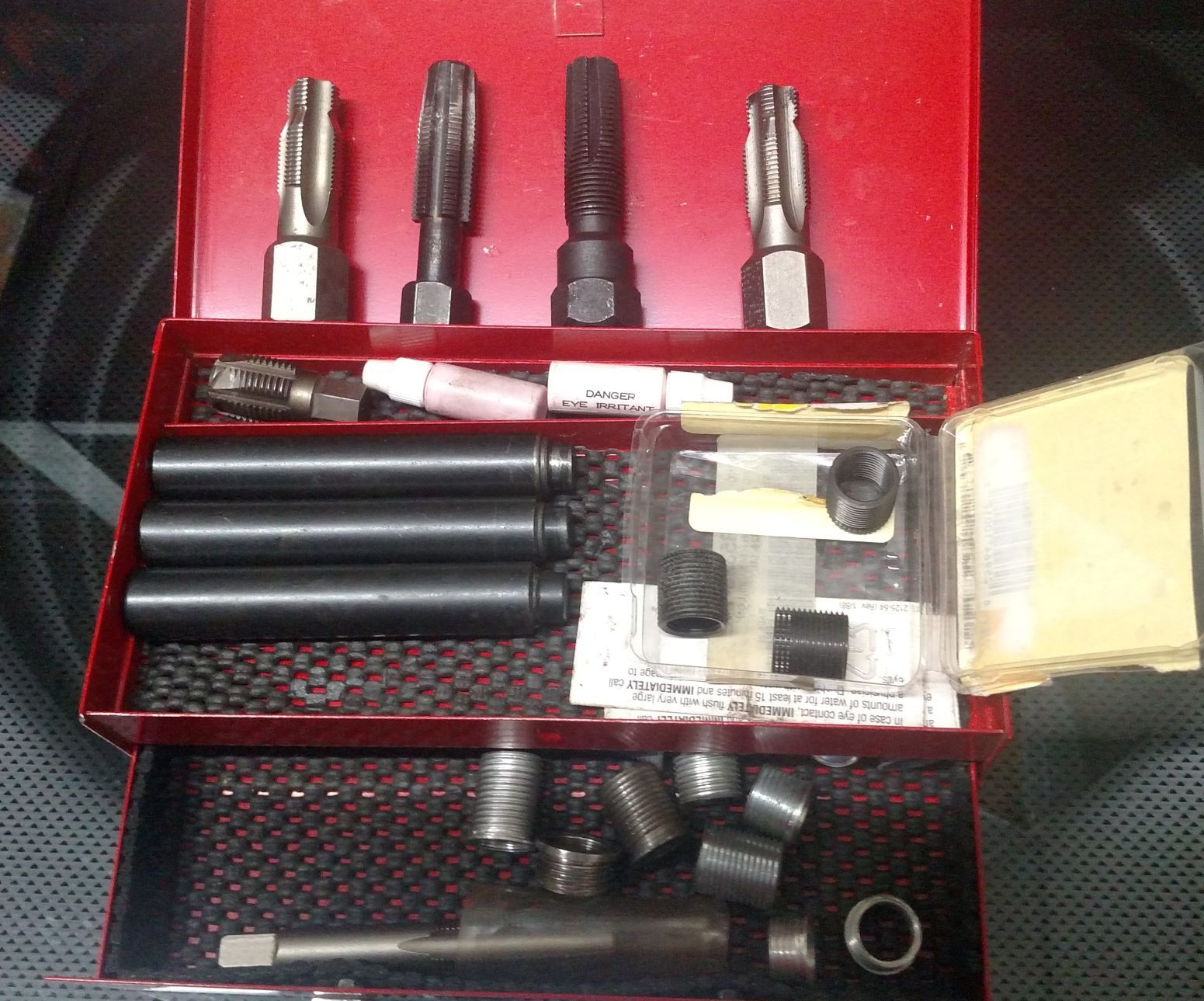

Don't go all cheap backyard redneck on it at this point. Repair the thread, it can be done head still on, fairly easy to do also, just needs a steady hand and some sense. There's less meat in there than you think at this point. Kits are reasonable. Use bee's or cutting wax on the tap to catch the chips then clean thoroughly with acetone or brake cleaner and blow out any left with compressed air. Anything that might be in there is very fine aluminium and will blow the first 3 seconds she's running High heat retaining Loctite #620 on the insert, install and let sit overnight. I've lost track of how many I've done in frame like this.

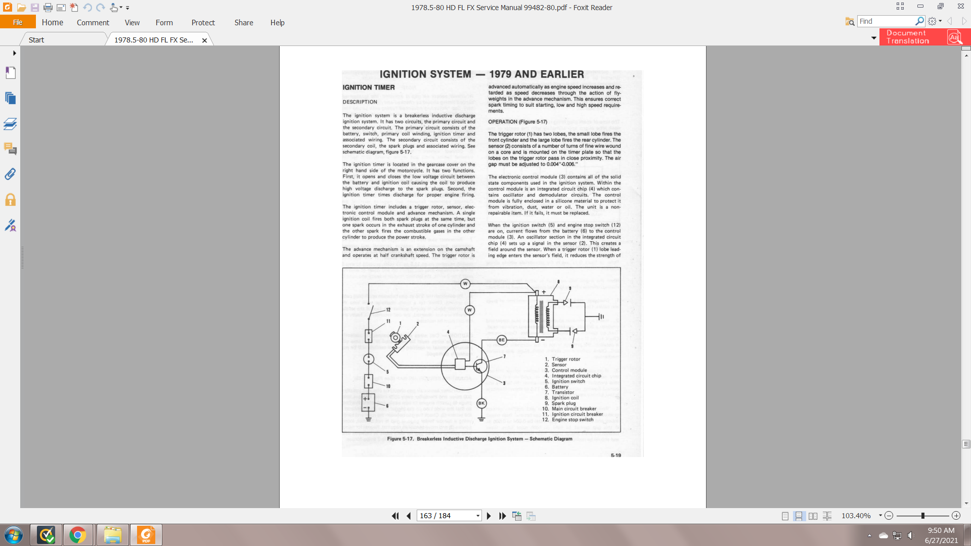

With the gap, I gapped it a .036. I have an S&S carb and the instructions from S&S say the gap should be .021 but Harley says .038 to .042
Speaking of gaps. On my points, it seems people generally like .014 to .018. My moco manual says .006. I just don't know who to believe.
I have my points at .016
Tom
.006 is for the air space on electronic ignition ... Not for a "points and condensor" set up

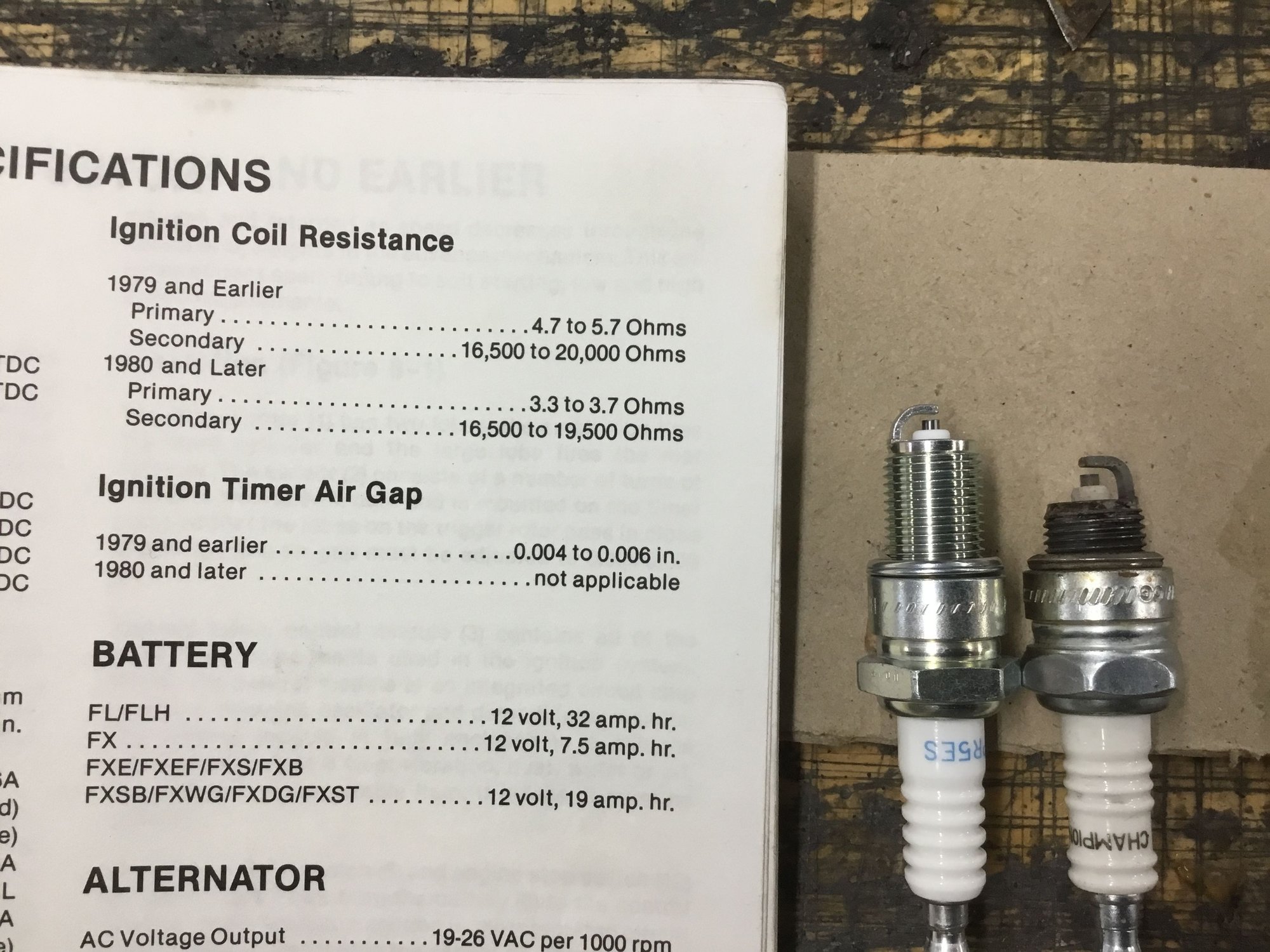

I’m definitely not going to redneck this bike. I’ve spent months a $$$$ undoing the previous owner(s) redneck modifications.
I do feel pretty confident that the threads are going to work for now. It’s almost July and I would like to get at least a few months of Minnesota riding season in. Plenty to do on it this winter.
I am dumping the Champion brand plugs since most everyone seems to poo poo them. I bought NGK this time.
In the following photo shows the old Chamion plug which is WRONG and the new plug I bought. Much longer threads.
Once again, I have this dorky 79 engine but this was the transition year where everything is a mess in the book. I have points which I think they used until mid 1978 or there abouts. Looking more closely at the book, Uncle Larry is right. The timing of .006 is not for points. I have my points at .016 for now. Plugs are .038
