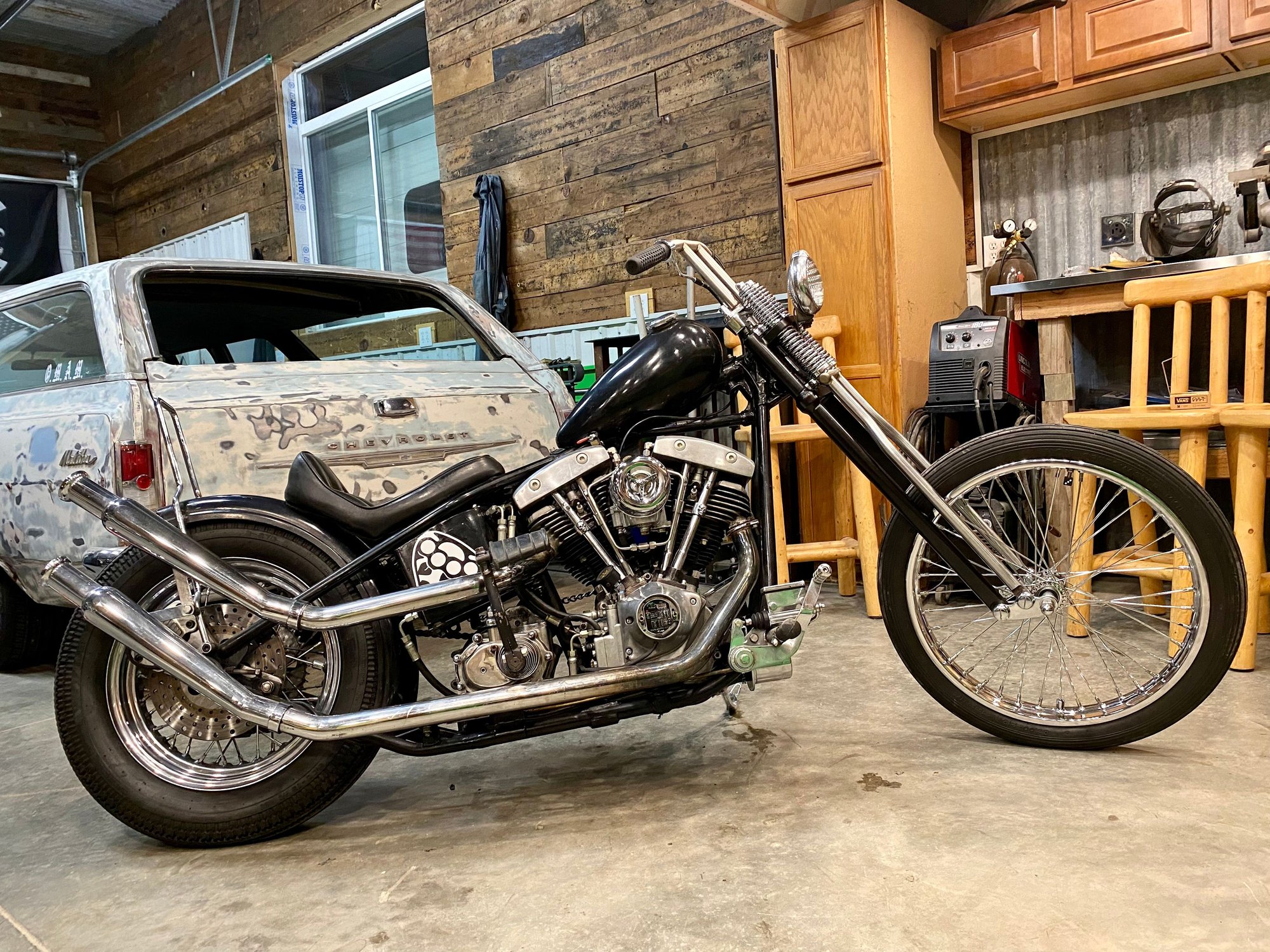

Evening. Getting my *** kicked with this new ignition. Ultima kick only, suppose to have been pre programmed. Now I can’t get it to run. Switched from points as it hadn’t been running well. Triple checked the wiring and timing marks. 73’ motor. S&S super e, kick only, three wire hook up, new battery. I’m at a loss. Backfiring out the exhaust and intake? Any thoughts? My thigh is sore as hell form kicking, never had this hard of a time getting one to fire. Thanks.

Thanks for the reply’s gents. Coil is a 2.8 dynatek. Pulled both plugs, with wires connected & kicked over. Getting good blue spark, & it’s sparking every time I kick the motor. Triple checked tdc. Pulled push rod cover to verify what stroke I was on. Finger over the hole to check for compression stroke too. Advanced it, retarded it, drank beers between both, cursed it and kicked it. My buddy was wondering if perhaps one of the adjustable pushrods were to tight. I’ll try that next.
