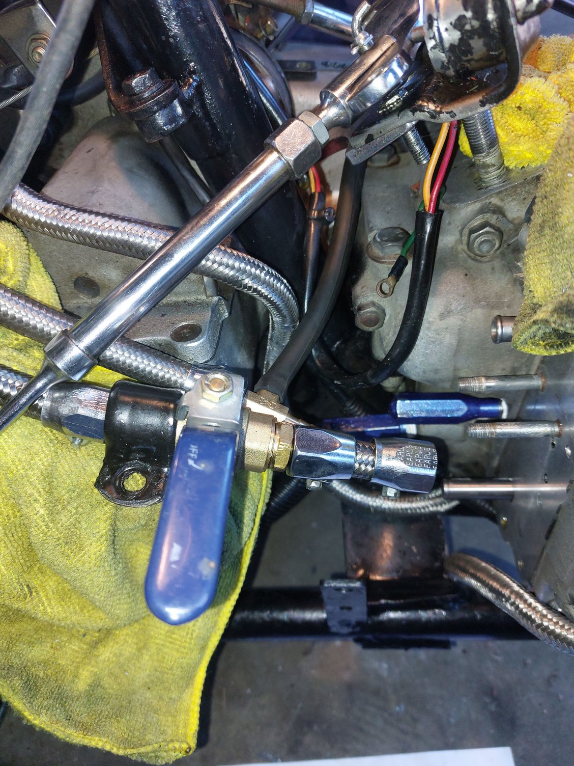

3. I actually put in an oil shutoff on the feedline to prevent seepage, I have the crankcase vented to my rear chain to spray oil. I also have a rather sophisticated method of seating the oil check ball to prevent seepage. As you all know, the ball WILL leak over time.

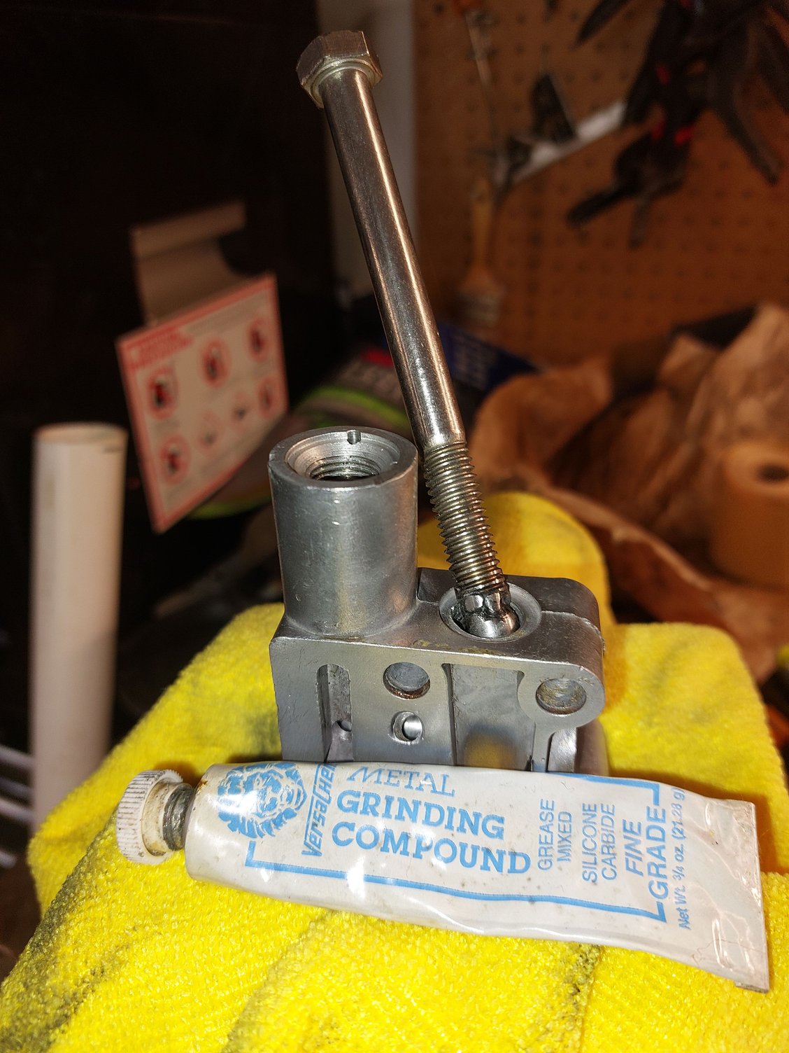

what you do is if you removed the oil pump - you can use a 3/8 push rod with valve grinding compound and lap a seat into the ball cavity - that checks the oil in the first place so it stops or almost stops the oil passing by at will - usually when no ones looking and its alone for a while - this cannot be done with the oil pump in place

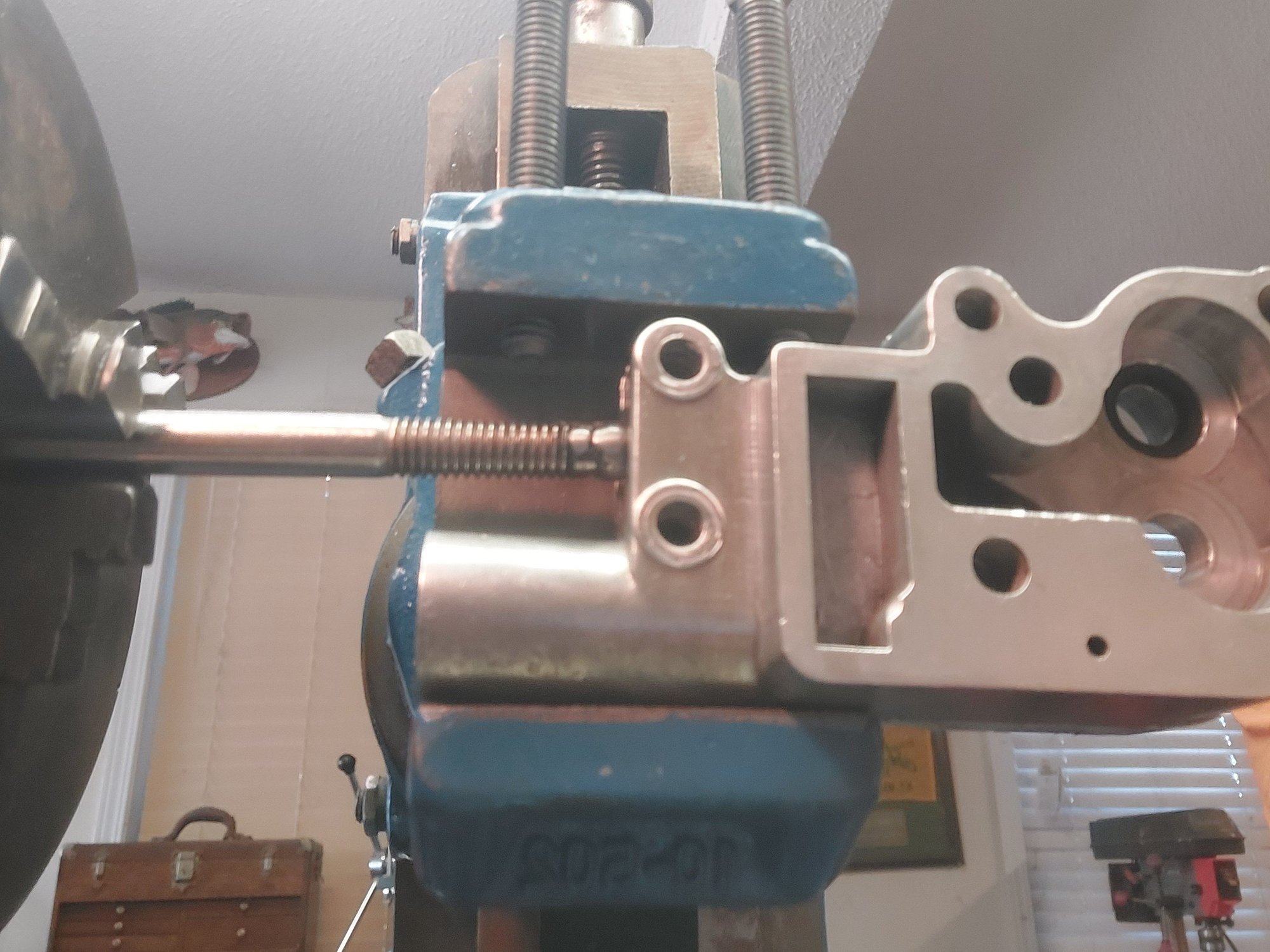

I use both of these to reseat the check ball. The big one is a 3/8 bolt with check ball welded perfectly straight on. The one on the right is a a hand tool for fine grinding the seat.
I chuck the 3/8 into my lathe and use fine grinding compound to reseat the ball.
To finish, I use the small diameter hand tool to careful probe for imperfections, check the seat, then do final hand grinding with the 3/8 bolt tool.
I use this Lowes bought ball valve to shut off the oil. With the handle off and pointing out, It instantly gets in the way of my leg if I'm sitting, or using the kicker. Pushing it forward opens the valve. Doesn't leak a drop. Looks kind of Steam punk in my opinion.
