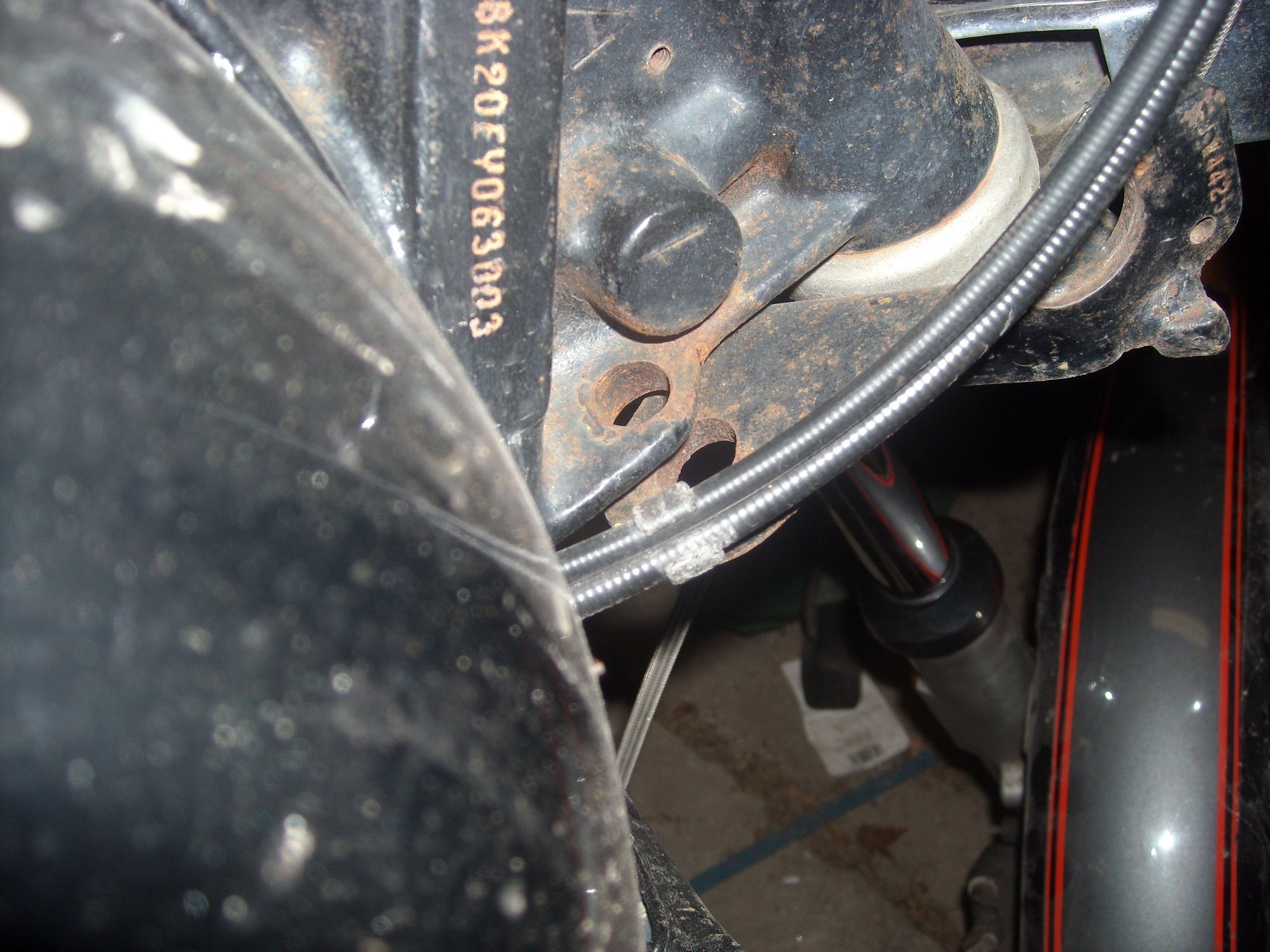

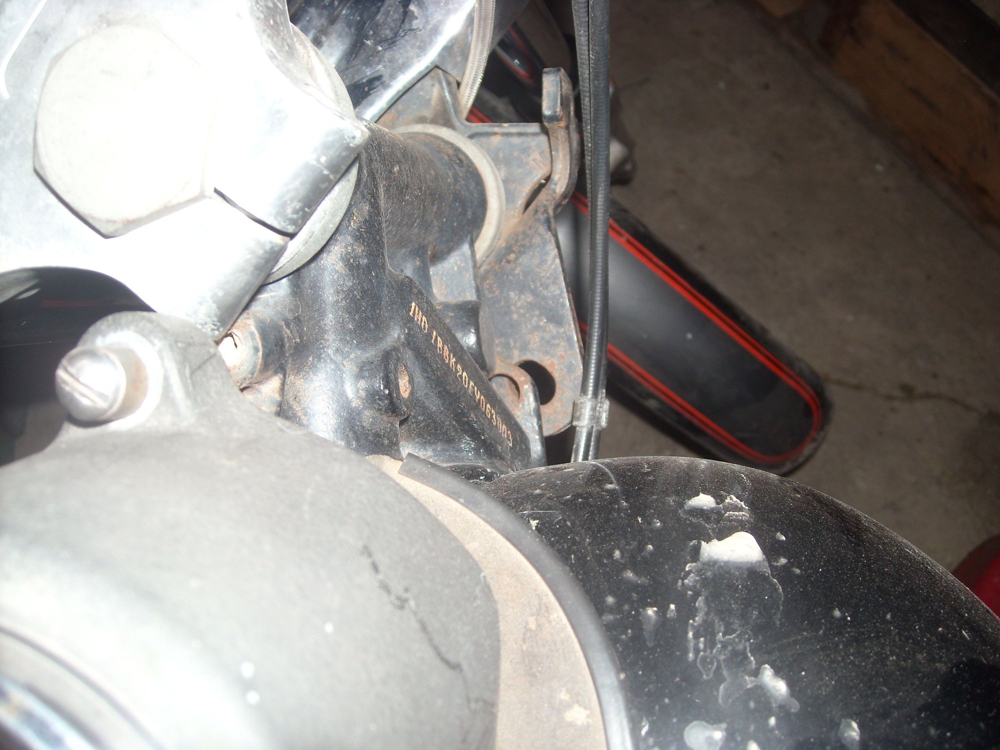

Originally Posted by 1981 suprglide
naw harley didn't make one in 1984 only the fxe and low rider
No Sorry Bud, they made them again in 1984. I have one. one of 398 in Candy Red, 1437 total. Mine was made March 6, 1984 and shipped Aug 23, 1985. It is not in any brochures as it is a mid year introduction. 1HD1BBK20EY063003

I am not totally computer illiterate, but far from an expert. In my last posting I listed my complete serial number. I don't know how that link appeared???? My number shows BBK2 (FXEF) the "E" which is for 1984, and the 063003 sequence number which is very late. There are many more later than mine as well, but the last "Regular Production" Shovelhead is 061625. It is a challenge owning a mid year introduction last year of production. Lots of parts are that model only, that year only. 1985's are even worse, although they are not Shovelheads for the most part.
