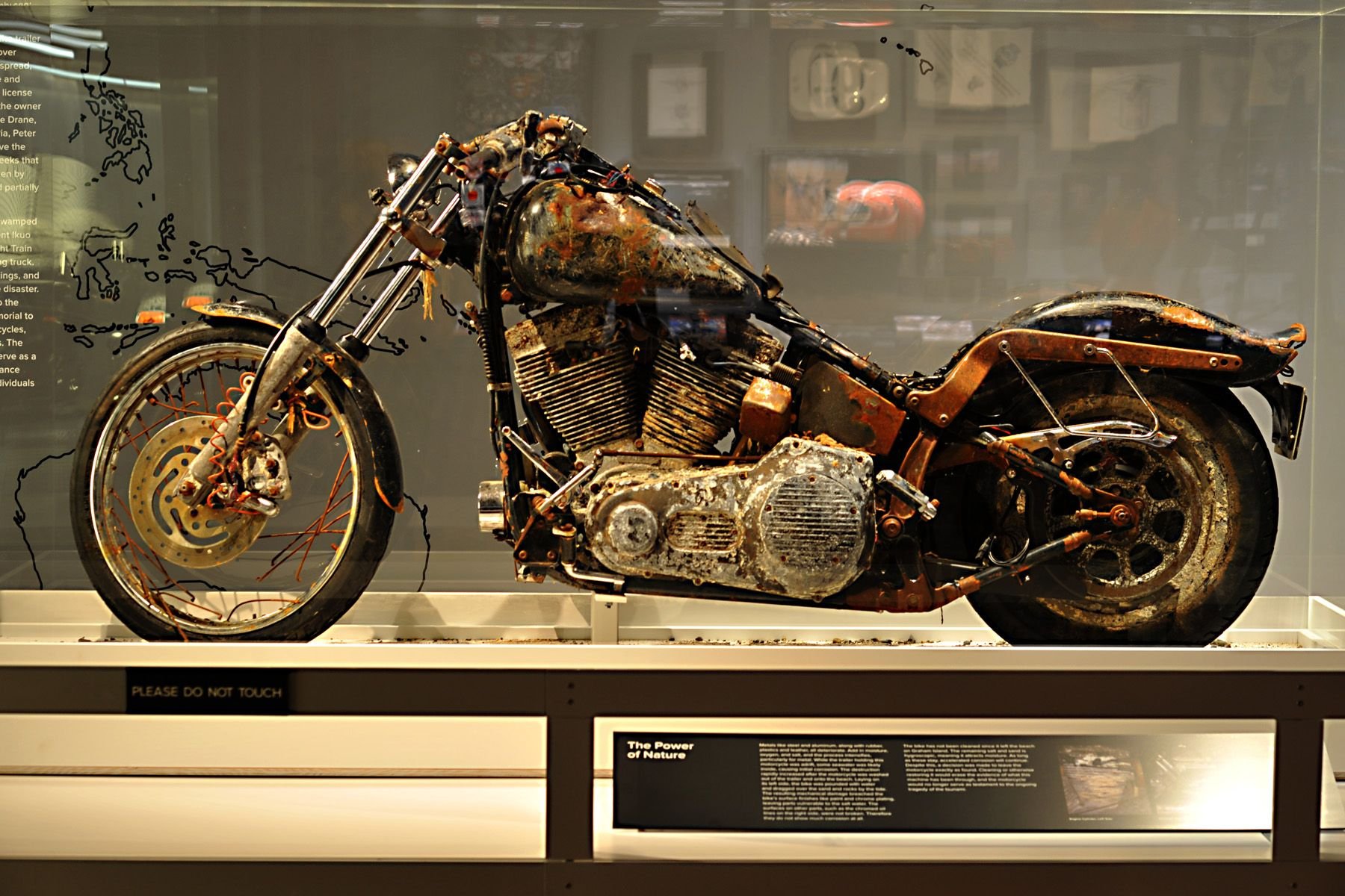

On a positive note, if you think about it, most of the motor and trans is sealed and can resist short term flooding. If water got into the transmission, it has a protective coating of oil that would stop rust from forming for a while, and maybe only the shifting mechanism needs help. Depending on the model/year/condition the vent could have a u-shaped hose that could have kept most of the water out too. As far as the motor, the worst thing is if an intake valve happened to be open it would let water in and air out. For an exhaust valve, air would be trapped for a longer time, keeping the water out of the cylinder if the water level subsided quickly. The breather hose depends on model/year/condition too. Electronic ignition is sealed, points may be rusted shut but they are an easy fix, as is the advance mechanism. I would clean and flush everything and hope for the best, you've got nothing to loose at this point. Pulling the cam cover is a good way to judge how bad the motor got flooded and let any water out.
Or maybe the Harley Museum would want another? This one was in a shipping container floating across the Pacific for over a year after the Japanese Tsunami of 2011.
