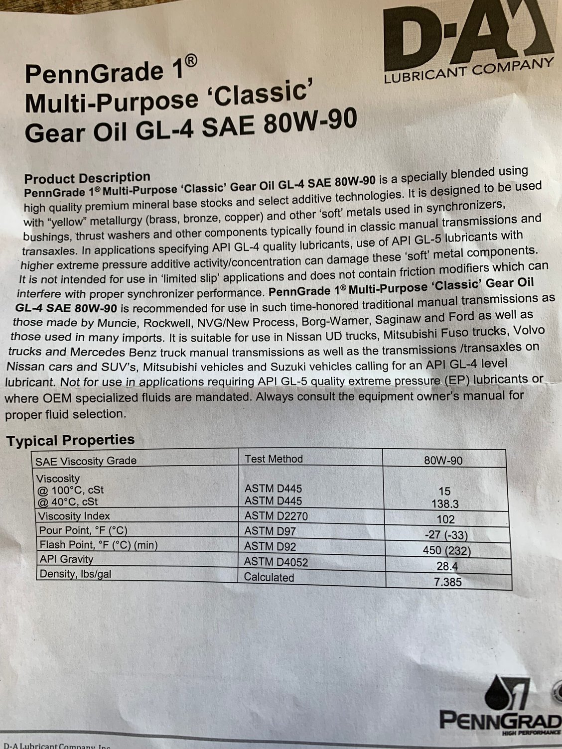

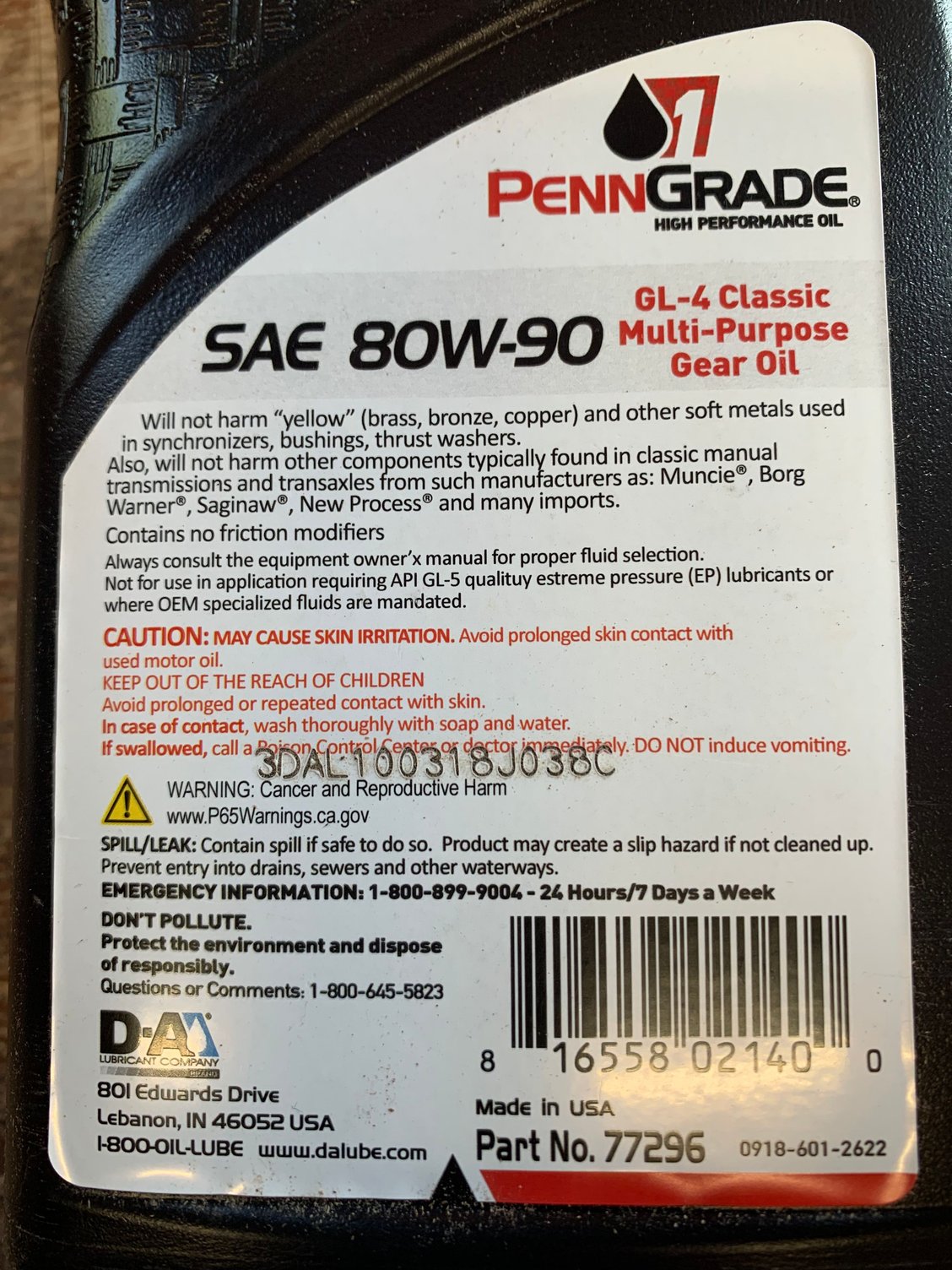

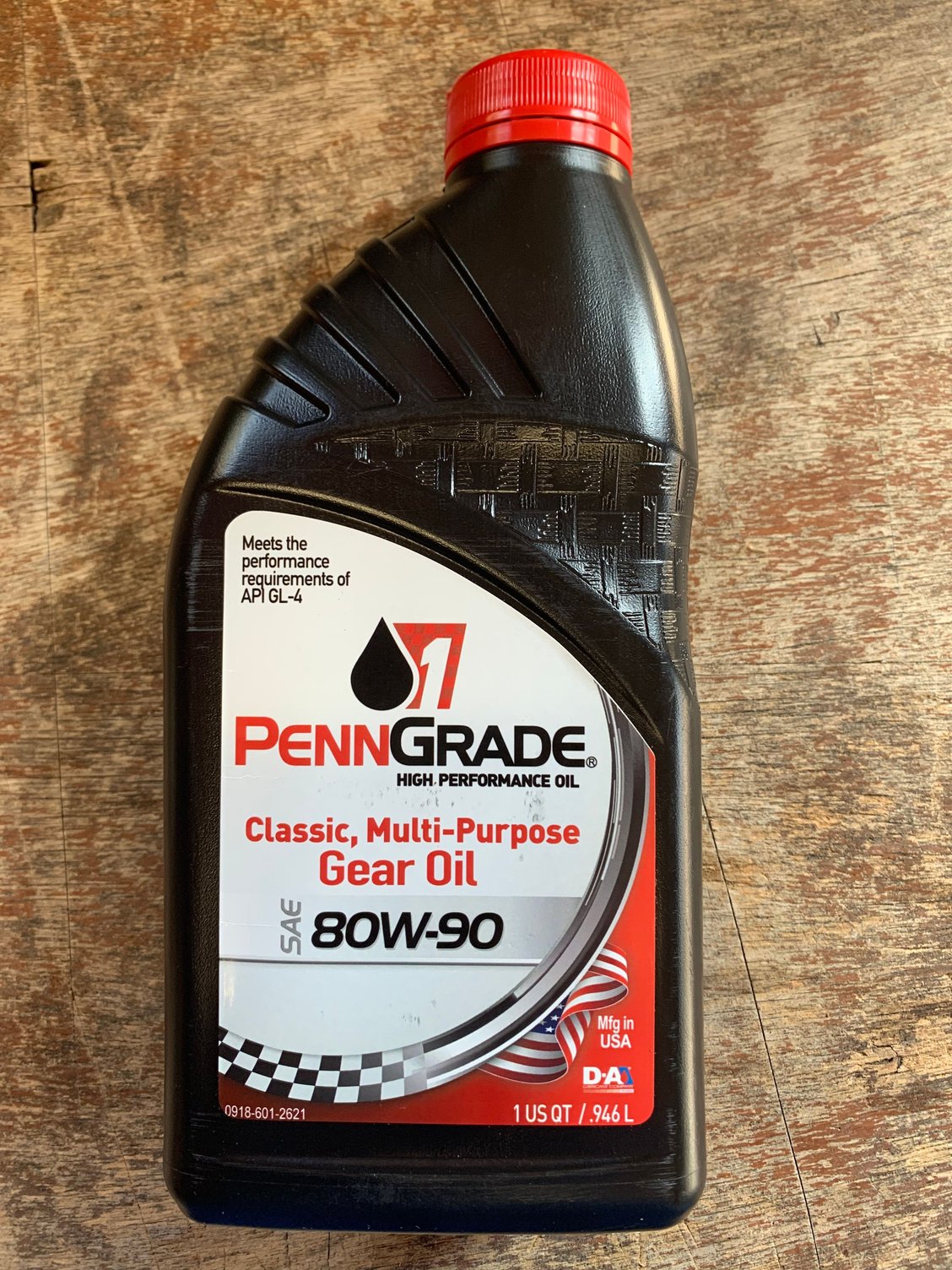

I’ll be using the VR1 60w with some of the Lucas Heavy Duty Oil Stabilizer added, but just for fun I ordered a quart of the PennGrade 1 gear oil from a motorcycle engine shop in North Hollywood, California called F&G Engine. This shop seems to specialize in vintage British bikes, and my impression is that for old Triumphs and the like this is the oil of choice. I’ve attached pics of the bottle and the literature and extras that the shop included with the oil. It emphasizes the oil is good for gearboxes with yellow metals. It was nice of them to include the postcards of the old Triumph race bikes, and it’s nice to do business with a small shop of motorcycle enthusiasts. Hopefully this sheds more light on this lesser known oil and I hope you may find interesting.
I am curious what is the weight / viscosity of the Lucas Heavy Duty Oil Stabilizer? The bottle recommends adding 20% - 60% total volume depending on the condition of the engine or gearbox. How does this mix effect the oil’s weight / viscosity?

Judging by the Brad Penn literature EP whatever number is a no no where GL-4 is indicated.
