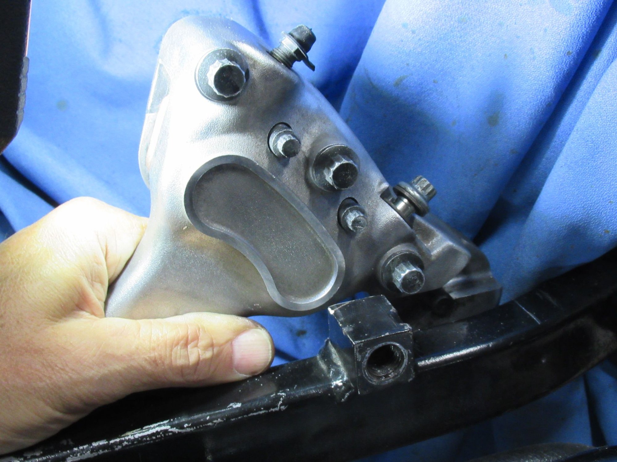

I saw a lot of people like running a softail caliper for their rear disk chops.
Can anyone with this setup provide pics of how you had to shave it & the tab mount you had to fab? Thanks.

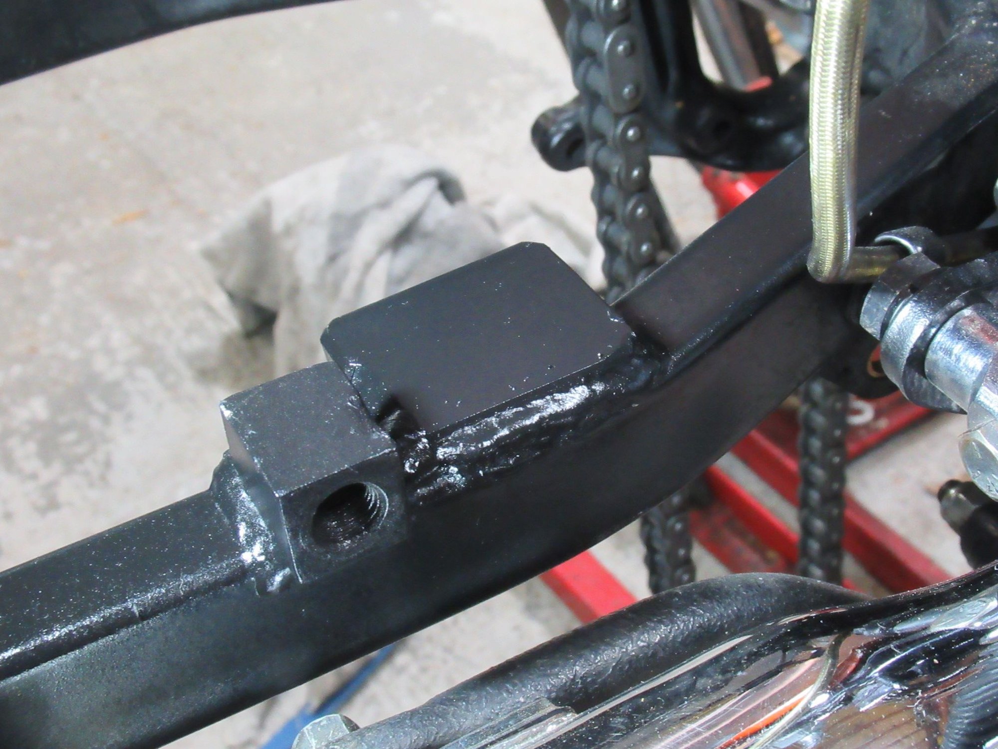

It is an easy upgrade if you can weld.
Grind a little off the shock mount

For a rigid frame, you would just copy the softail design. The tab has to be parallel to the axle slot.
So you added the tab to just slot in the caliper?
Yes, just like the softails. Good luck
