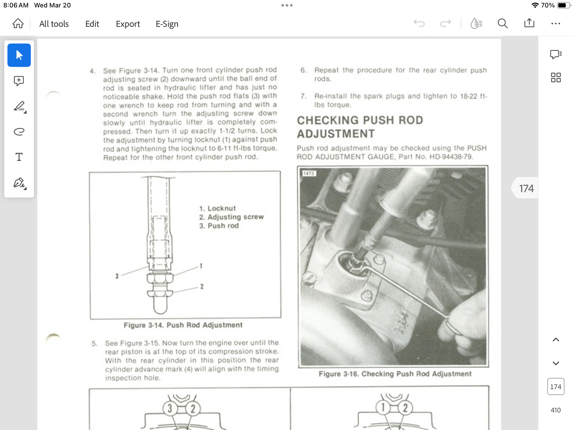

On my 81 the manual says to, with valve closed, adjust pushrod until lifter is fully collapsed and then back off 1 1/2 turns.

one and a half turns is nine flats........ what i do is 8 flats , then tighten, this will give you exactly nine flats.
