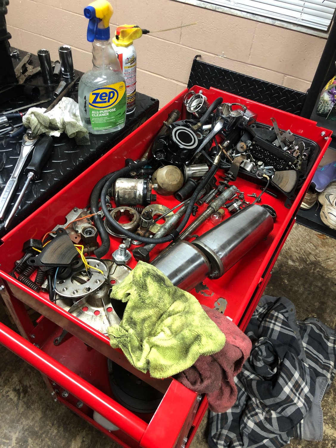

Its almost as far apart as it can be now.....so first I need to clean up this mess. I will have black grease under my fingernails for weeks!!! What I have learned so far:
- It is NOT original paint.....which is fine, but I liked that idea when I bought the bike...but?? I need to find out who painted it, and if I can get a paint code for the chips repair.
- I need to send the speedometer out for rebuild...retaining original miles.
- I have found and bought ONE new Harley NOS muffler....looking for another Harley NOS muffler.
- Definitely need a new wire harness, so will order that. I would love to keep the handlebar wires sleeve gray like original, but it appears the new harness has black sleeve.
- The wheel rims are beyond hope for me.....too much rust pitting.
- Inside of fuel tanks are spotless and clean.
- I will be getting frame, swingarm, and a few other black steel parts blasted and powdercoated.....going to try and carefully salvage the VIN sticker on right downtube so I can reinstall it.
- I will be opening up, inspecting and rebuilding the transmission and engine.....I just hope I can keep it to a minimum and use what I have. As I said....NO UPGRADES. I want to experience the bike the way Harley built it.
- For me......this is the stage of building that is THE most fun.

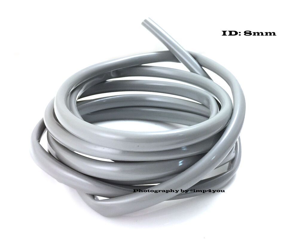

- Definitely need a new wire harness, so will order that. I would love to keep the handlebar wires sleeve gray like original, but it appears the new harness has black sleeve..
When I restored my 82 FXR, I removed the black sleeve and replaced it with this. It was tedious work, but doable.
https://www.ebay.com/itm/172670303574

Spent several hours today cleaning up all the tools, grease, parts, ..........and that marks the bottom of the rebuild curve....from this point on, it's up the curve on the rebuild. No timeline, as spring has arrived in PA, and that means on the road on the Road King and the Corvettes.
Thanks, I just bought two rolls.
