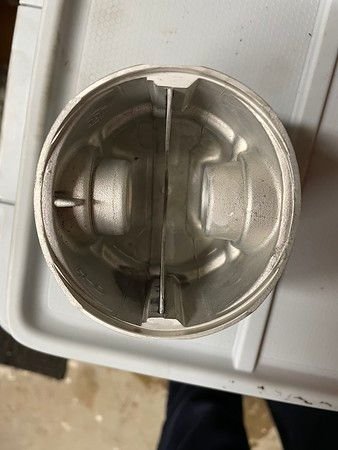

Just about ready to button up my top end but I have some questions about the pistons.
I know the OEM pistons require you to face them a certain way and orientate to either exhaust or intake etc. The guy I had do my top end valve job and hone my cylinders included a set of Superior brand pistons which he recommended with a set of Hastings rings. From what I see when compared to the OEM pistons, these aren't marked to show front/rear facing and the exhaust/intake pockets look to be the same size - instead of being different sizes. OEM also has the little notch on the pin hole to show facing. Everything I see with these doesn't show me how to face them.
He told me these are omni-directional but I wanted to make sure. I was a little put off by the pistons being Chinese but this guy does great work and has built some really really quality bikes. I'm not really questioning him at all - he's just really busy and I don't want to keep bugging him with stupid questions. 1984 80".

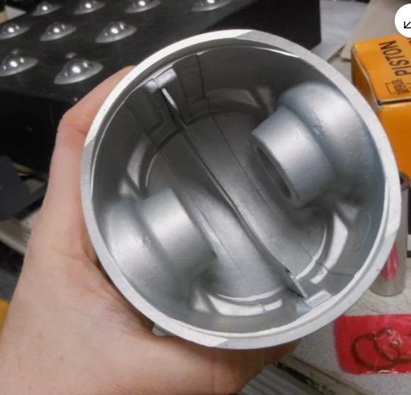

It looks omni directional, the valve pockets are both the same. I tell you though I don't like the cast in support piece, in the pic looks like there's gaps in the casting.

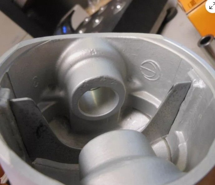

It looks to be a copy of a JCC piston the one picture has a circle on the side that is the location they put the company hallmark JCC
it might just be a neutral wrist pin location piston - JCC would be an off set - you need to measure wrist pin hole to skirt distance if its off set them location matters

JCC pistons have a small boss on them (as do factory pistons). That boss is located on the pinion side when installed
Yes, I know certain brands/OEM have notches/marks etc to show. These don't have anything. The wrist pin looks to be center too with no offset to suggest facing either. Again - my guy said it doesn't matter which way and he's pretty legit. I was just more questions here to get further info instead of bugging him.
