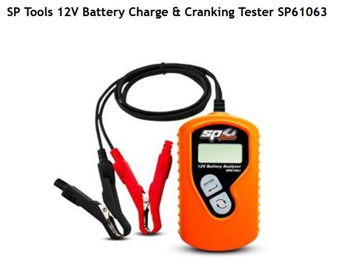

G'day Bulldog.
As others have said check the battery first. A multi-meter will only tell you voltage. Get a good tester that tells you CCA (cold cranking amps) as well as internal resistance. The best $50 I've spent and use it weekly.
Cheers
