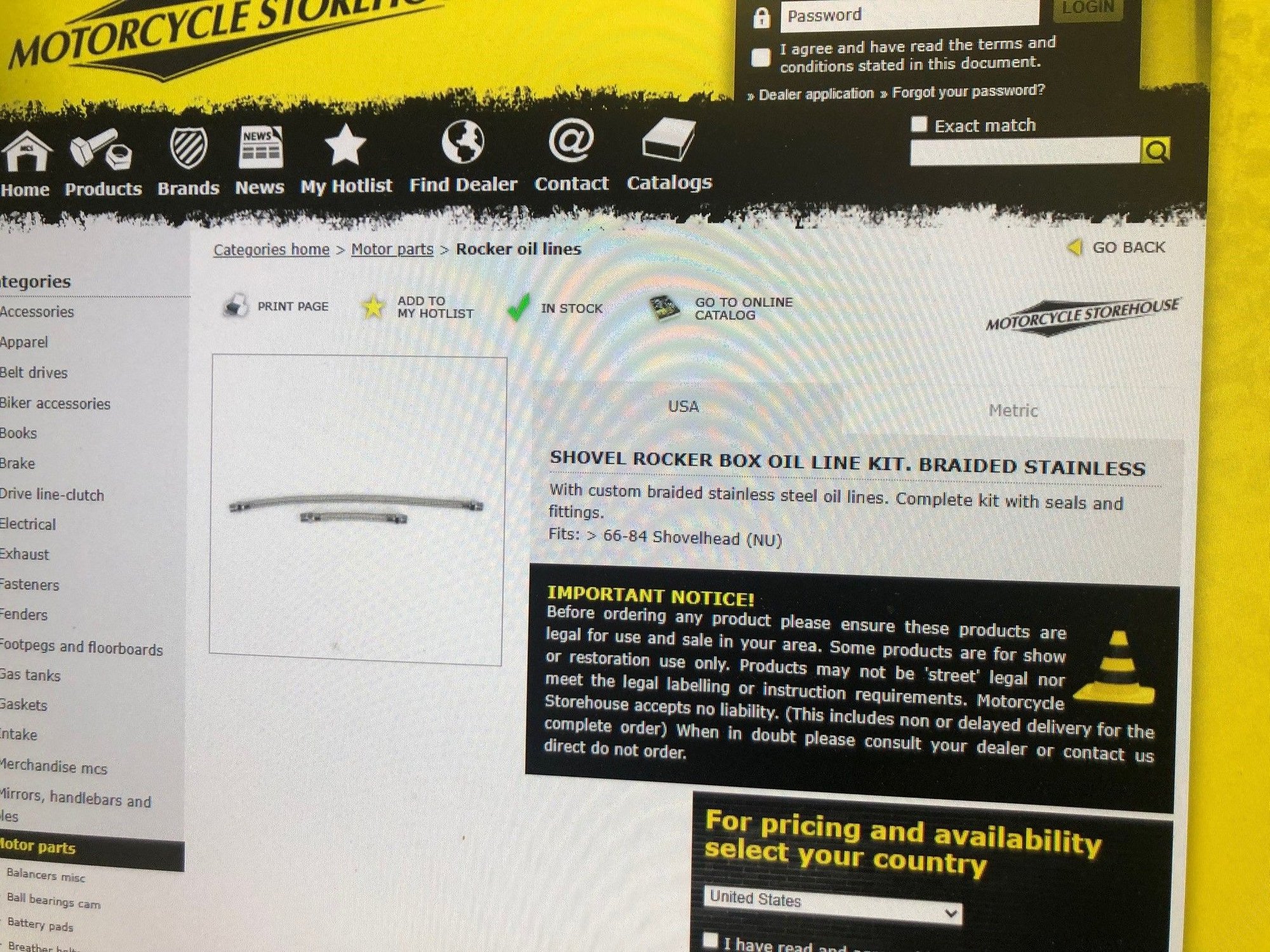

Anyone know where I can get a set of braided rocker lines?

Never dealt a set of those that didn't leak eventually and you lose the oil feed metering port for the rocker boxes, floods that front exhaust pocket without it.
