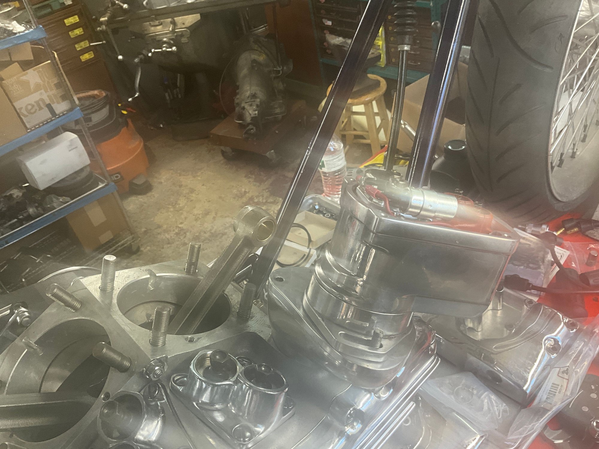

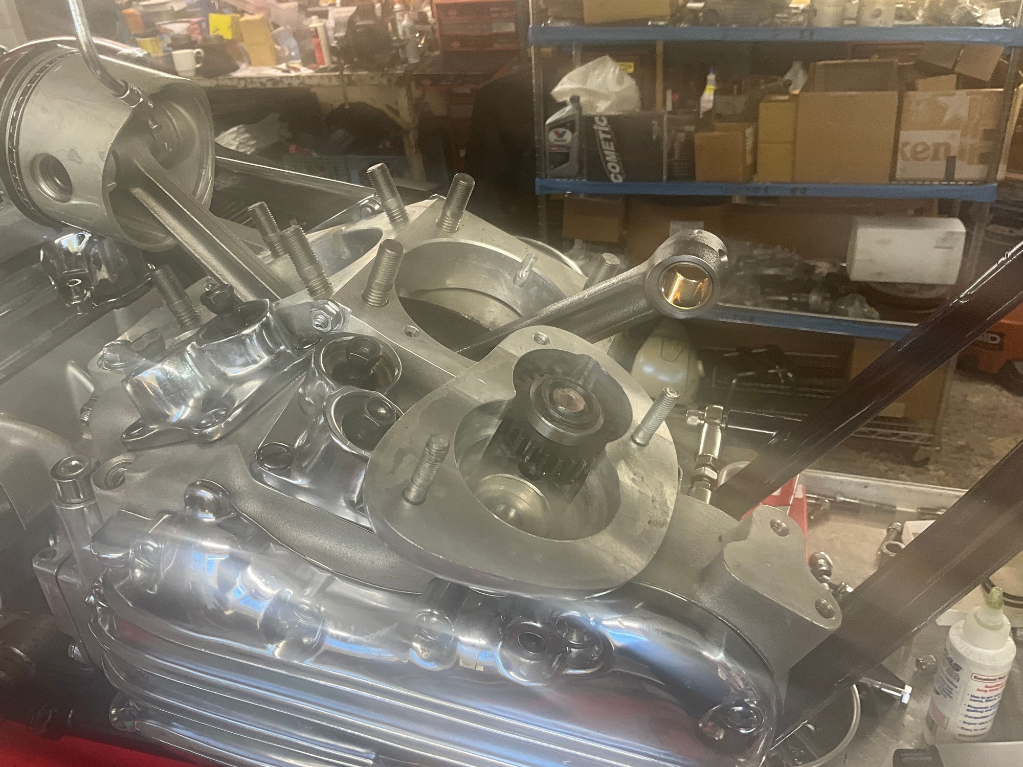

We got this job last year and the mag is something I don’t see timing with the gearing i could git it but maybe the advance really goes far dont know how this is adjustable or not have no name on it and never seen it before

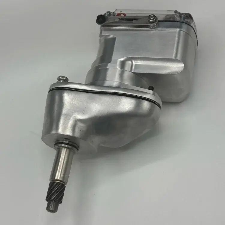

Is that one of the new Morris mags with an 'impulse coupler'? It makes starting super easy.
What is an Impulse Coupler?

I'm guessing they "geared" so a dummy couldn't over time - go lower but not over. Open the points a couple thousands at a time till it's timed where you want it snugged down.

Thanks joey - the original owner and i a few blocks from each other in the late 70s — another story
the new owner has very good directions and what i was going to do would not have worked at all -
