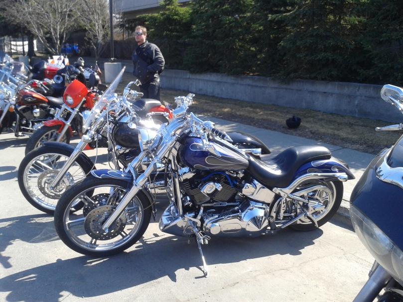

I've attached a photo of my '01 Deuce next to my '04 Deuce. The '04 has the Screamin' Eagle fork brace. That's the way I bought it. With the longer FX (41mm) forks, it seems these should be OEM from the factory. Saddling up on one bike from the other, the stability at speed, as well as when braking is immediately noticeable. The narrow tire also multiplies the ill effects of the longer forks.
If you've ever bottomed out your suspension in a pothole or on an unexpected speed bump or bridge transition, you may have noticed that unsettling feeling of wheel wobble when recovering. That's because your forks twisted a bit, and the rotational force of the tire and wheel- combined with forward motion, are re-straightening your forks for you. Via gyroscopic effect. If nothing else, the fork brace is a good insurance policy for potholes and speed bumps. High speed stability and cornering confidence are just a bonus.
Not the best photo, but you can see how thin and spindly that front end looks. Now that I've encountered your post, I'm thinking I should get one for my (FL) Deluxe. I've been putting off getting chrome lower fork legs, but now I can add those items to my winter mod list.
I highly recommend a fork brace.
Somebody please explain how to post a larger photo here.
