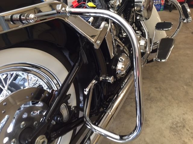

Tony,
As knees mentioned. with HD saddlebag guards, you do not need to lose your passenger footboards. Here is a picture with the saddlebag guard AND the passenger footboard, toolbox and true dual Samson.

Thanks guys, that helped a lot. Why bone doc? Some might call this crazy, insane, dumb, blah, blah, blah and I'm going on a 4 state ride with some serious canyon carving, in fact I bet my nephew 1K that I will eat his *** in those canyons. Should $hit happen I want to keep that bike off of me. Also, I think that add to that "nostalgic look too!
