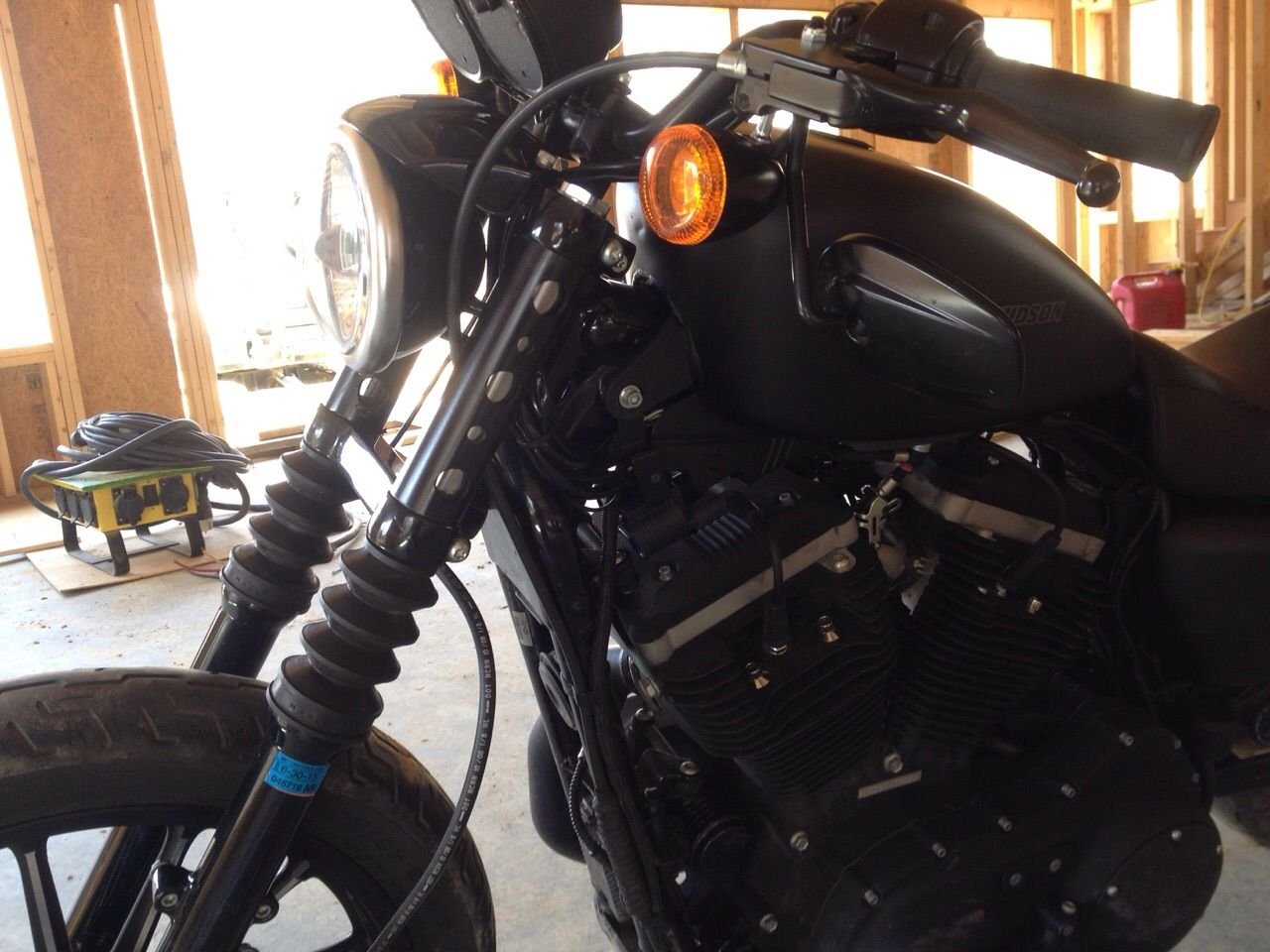

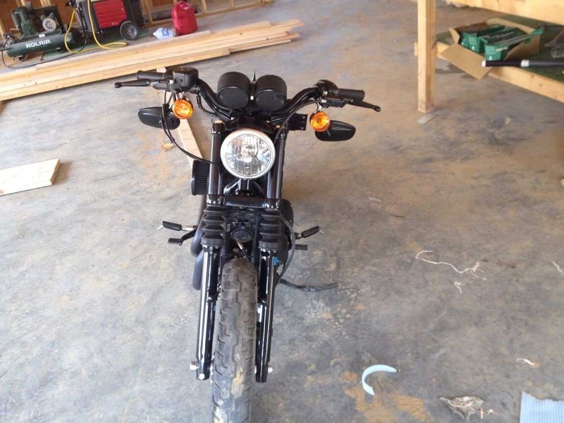

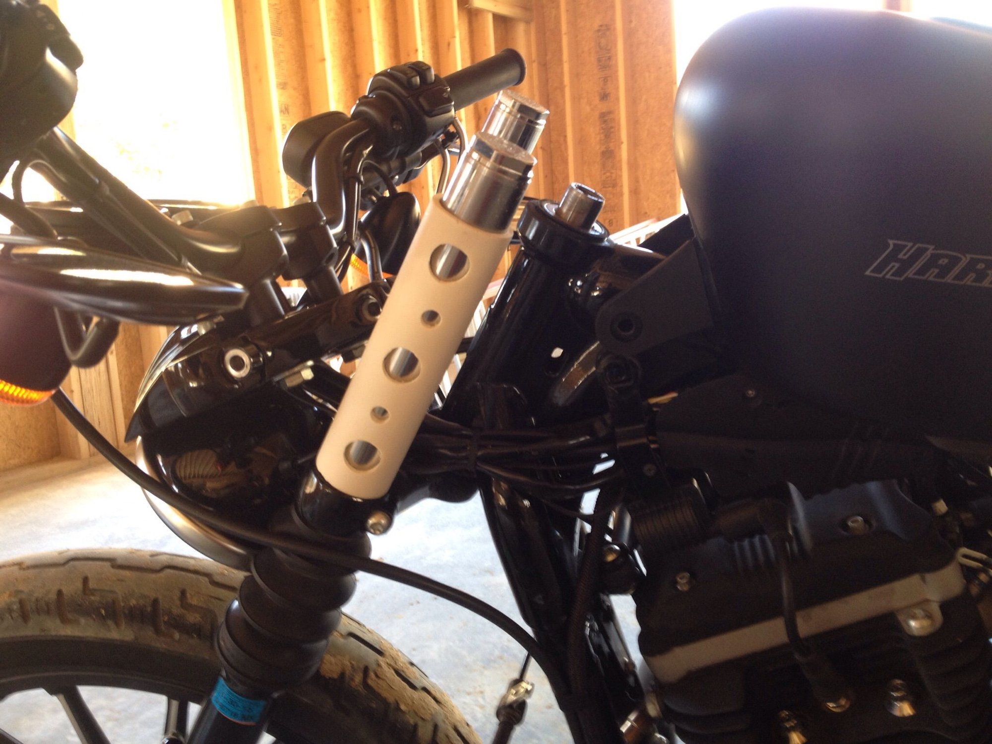

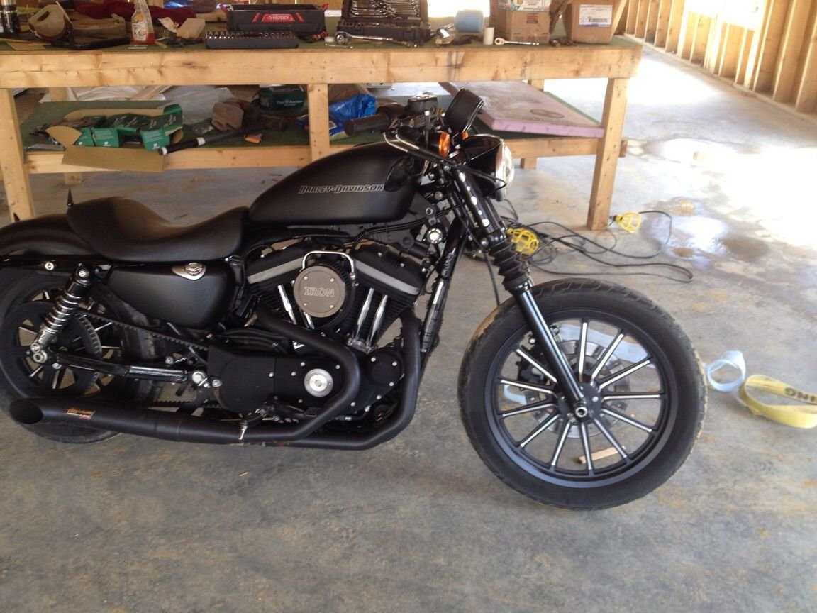

Just made a set of these for 2009 Sportser Iron. 1-1/2" PVC worked great. To keep them from wiggling (what little space there was) I wrapped the bottom of the pipe with a round or two of hockey tape. Fit snug as a bug in a rug.

It took surprisingly little time. Just measured before disassembling, cut pipe, drilled holes, wet sanded, and sprayed with krylon fusion. Sprayed around 4 or 5 coats waiting 15 minutes between coats.
