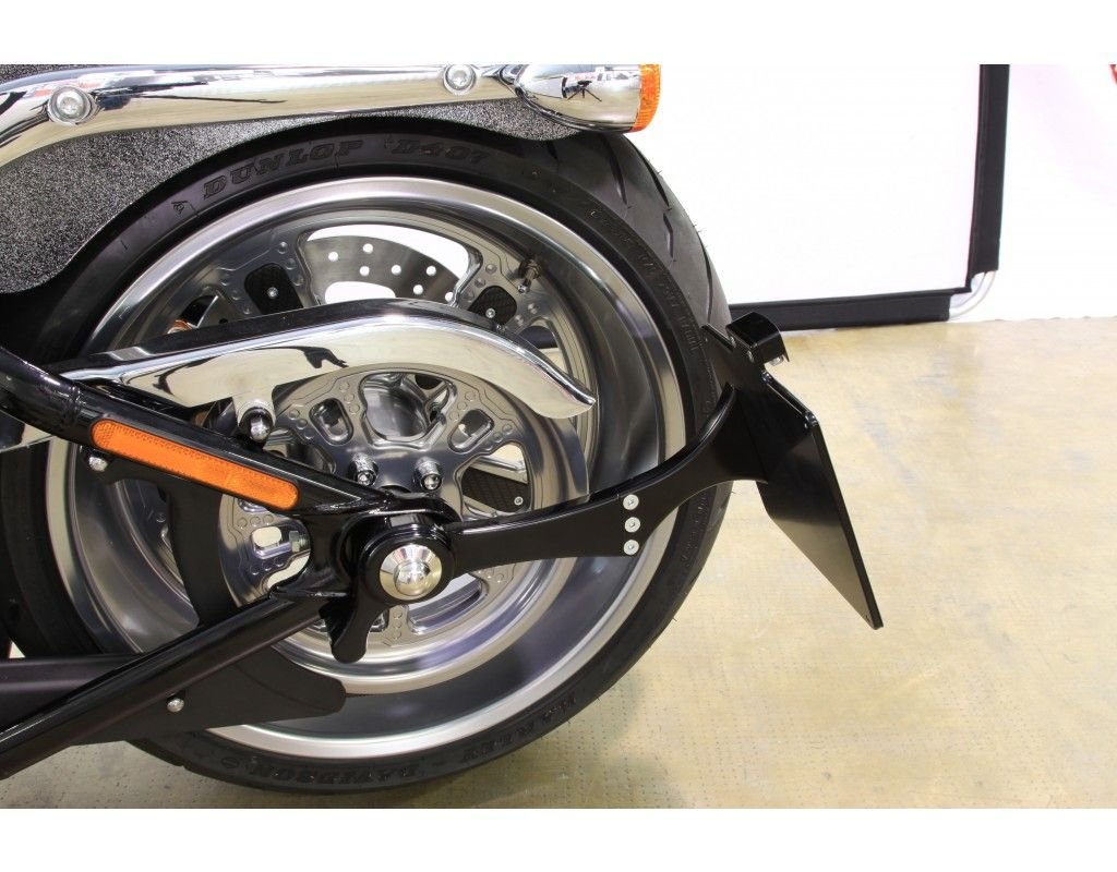

Tonight I will remove my horrible European style license plate holder and installing the Vega model coming from Rebuffini

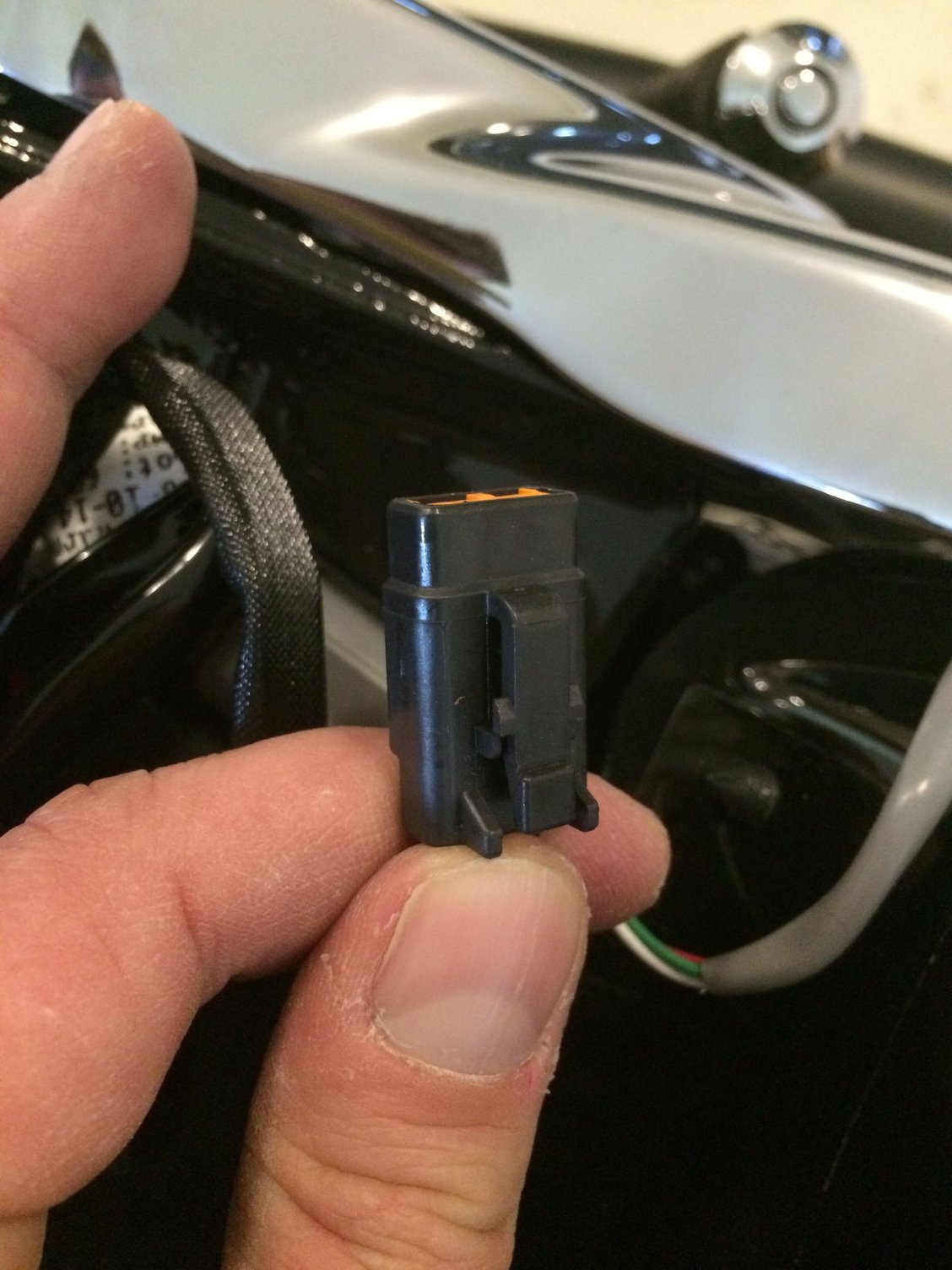

Now i've seen that the plug that goes to the plate holder has a "special" plug you can see in the following pictures.
I wish to do a nice and clean job so I am looking for a plug like that in order to avoid cutting and taping wires all under the seat.
Perhaps you guys know where I can purchase that plug?
Thanks!

Not sure what bike you are working on, but the plug looks to be the same one in these directions.
http://www.harley-davidson.com/en_US...ts/-J02753.pdf

Those are weather resistant deutsch plugs. You can reuse the ones you have currently...assuming you have new pins to place on the inside. If you get new pins, you just need to crimp them and re assemble the plug. Those deutch plugs are able to be taken apart and reassembled with ease...once you learn to pop them apart. YouTube is a good resource to use on the technique of disassembly.

Thanks for your feedback dudes!
I did the "old and dirty way", cut the wires and then welded them together again, nice and clean job as well.
BTW I was working on a Softail Breakout!
