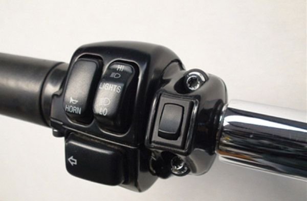

I like the idea of this one too Grip Switch.
It says it fits 2103 Slim but not 2014. Perhaps the housing is different between the two years but I did not think so. Like the idea of using a battery over splicing.

Cool Maybe need to go with a key fob size garage opener
I ordered the Hog Pen front brake cylinder lid type with the button.. Figured it would be cool but only now I noticed the bolt pattern for my Slim is North South opposing the Hog Pen Cover is offset like most HDs.
So as I am logging into Amazon to canx I get a message that says it shipped.
So I start looking at the Grip Switch but the website says it fits 2013 Slims but not 2014. Bummer.
So it looks like I am back to splicing into a wire or hiding a key fob size opener on the bike.
If anyone is hiding a small key fob size remote any specific info on model and where you hide it would be appreciated..
