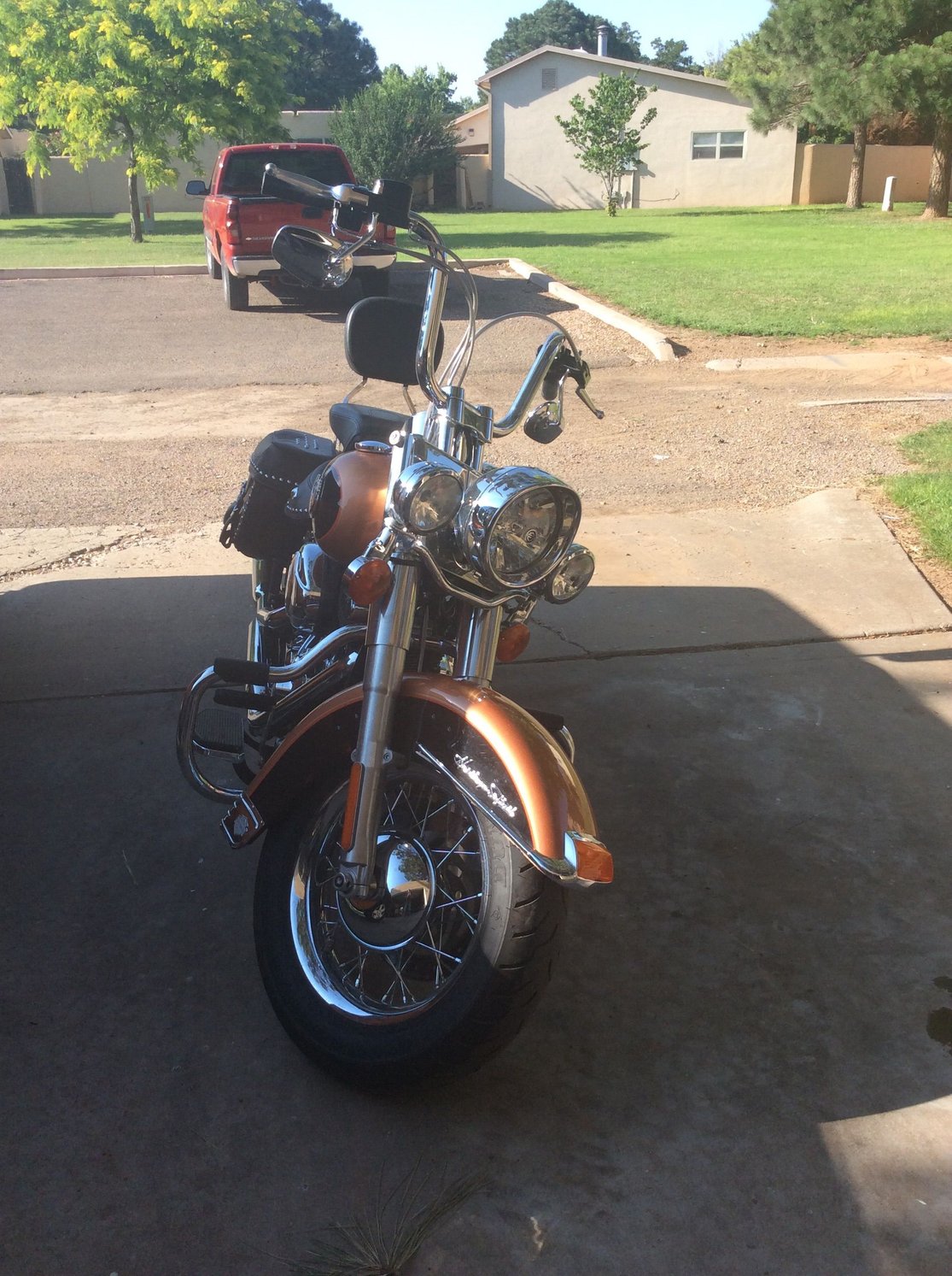

Everything went great! Just a snafu with the wiring...lost my place and had to redo the Deutch connectors. Found out that comparing with the other side is a good way to check too...thanks for all the help gents!
Finished! Just need to clean it now...
