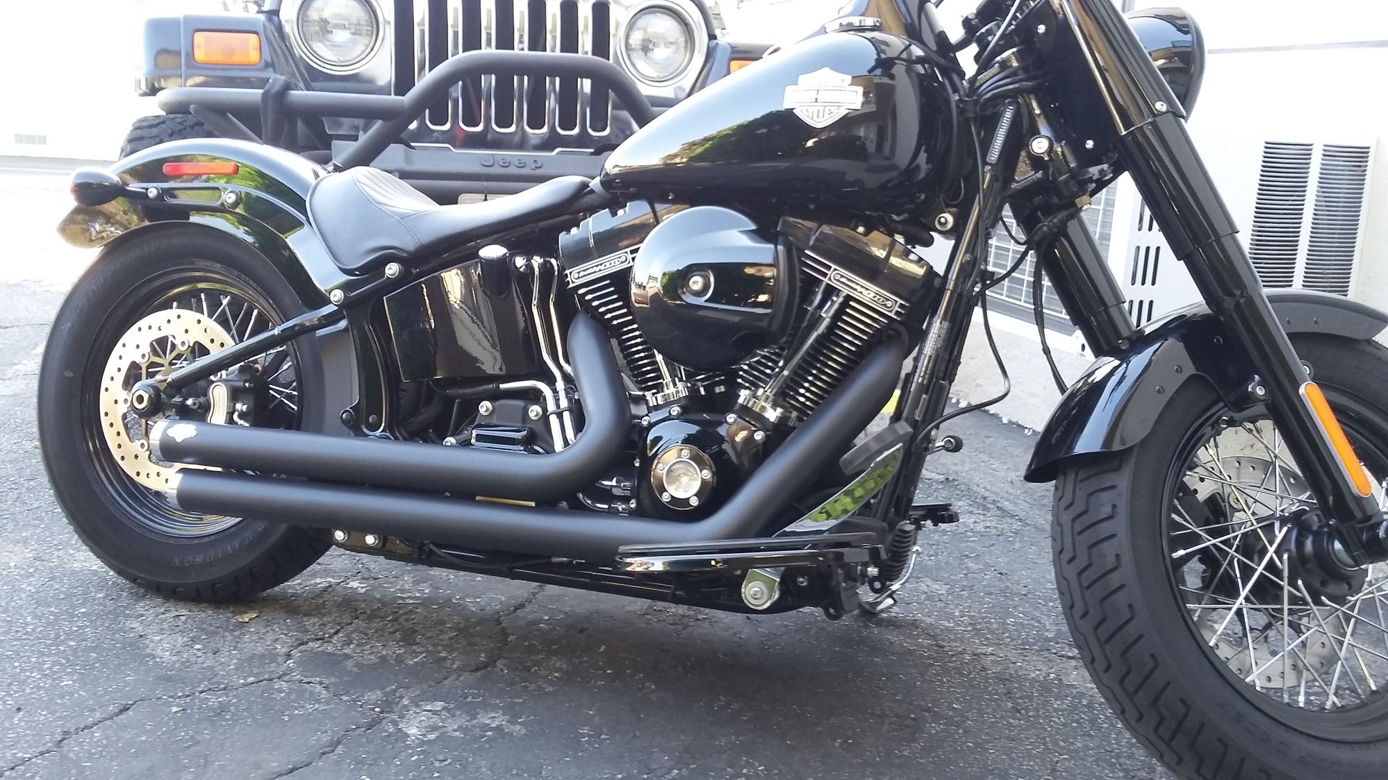

A 117 kit and a few internal bits.
Then forward controls for more ground clearance.
Neither bolt on without a little massaging, but they work nonetheless.

You've really dug into this bike. I'm digging the floorboards, so I have no interest in pegs; I am curious about the 117 kit. What does it offer besides displacement? Are there other advantages?
By he way, can you share your front fork mods again? I put Progressive 422 shocks in the back and gained some ground clearance. The ride quality is vastly better, but I'm still considering options for the front.

Default Front Suspension & 117 Kit.
Front forks changed to FX Softail, gaining 1 5/8" in length.
+2" cowbells to suit from Zodiac.
Progressive Suspension Monotube Cartridges.
Doesn't scrape at all now, can use all of the rear tyre tread width, andmost of the front.
117 kit with different cams (Andrews 57H) steady useable increase in HP, big increase in Torque over stock. Like having an extra gear, pulls hard from 2200rpm.
It's a torque hotrod now.
