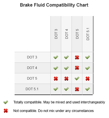

this is from HD website..
http://www.harley-davidson.com/store...-12-9990277--1
click on fitment and go to 2001 bikes...
accordingly to this,, your bike uses dot 5...
my 07 uses Dot 4. and says so right on the master brake covers...
Here is a chart I found about Brake fluids compatibility
taken from . this is a good read
http://www.epicbleedsolutions.com/re...1-brake-fluid/
Here's the chart only.

Aren't we all being a little sanctimonious?
OP, the correct answer is on the COVER of your brake master cylinder - I'd trust that before I'd trust anything written, including the HD manual.
(well, it could be a revised edition....)
Hope this helps,
John
Hope this helps,
John
What your saying could be 100% true...
But what if someone totally Flushed out all of the stock fluid and replaced it with something other that what the covers say.. which in this case it says dot 5 is stock.. and it doesn't work or you can't mix with Dot 3 - 4 or 5.1 brake fluid
IMO that another reason that --- unless you know 100% sure what your bike has in it (hard to tell if you got ut used)... then do a total flush and take it back to stock fluid...

Great observation. Mostly overlooked and I didnt think of that.
But if I was the OP and it was my bike in question? I probabably would have.
I say flush!

I just went thru that. Rebuilt my calipers and the fluid looked old and nasty. Flushed both back and front and used Dot5. Brakes work well.
