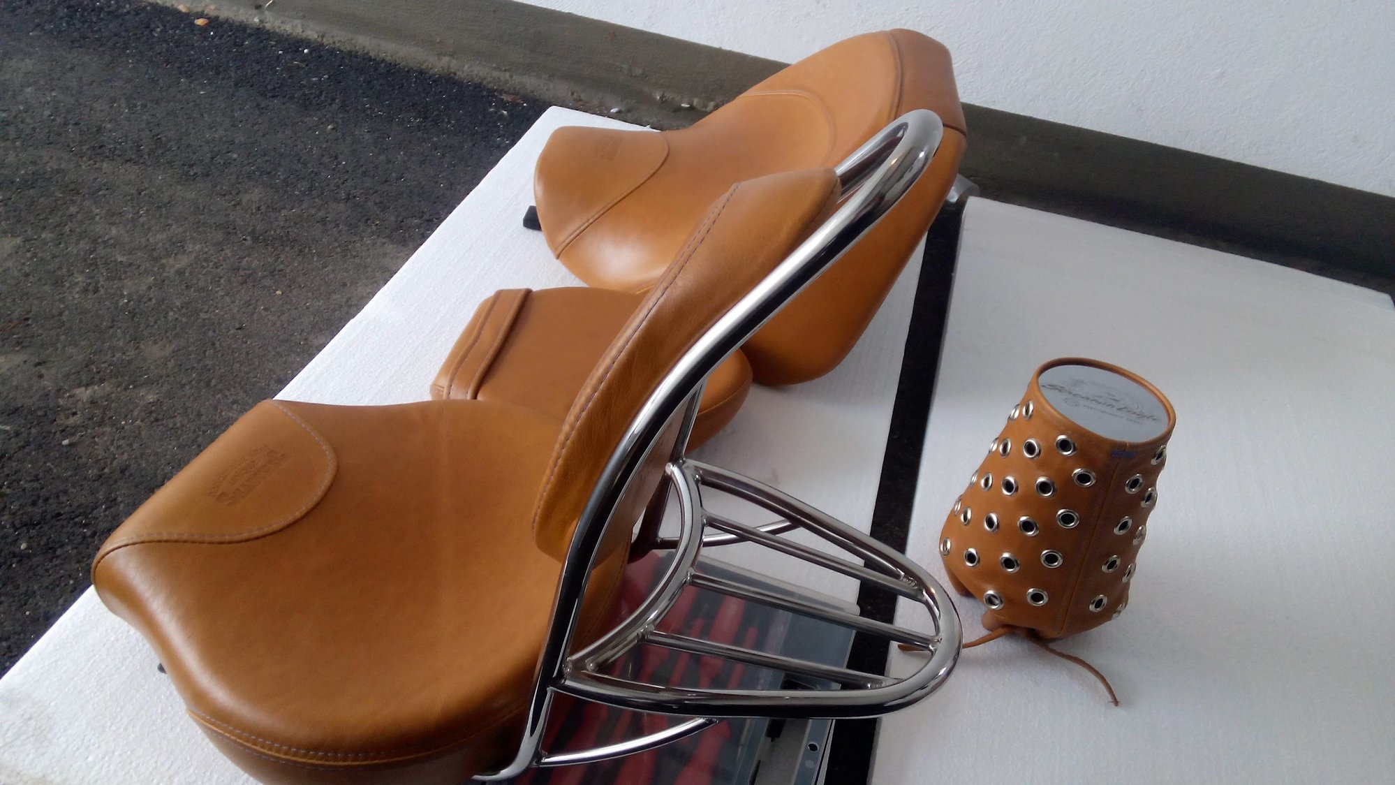

Customised 100% my and passenger seat... new sponge and leather.
