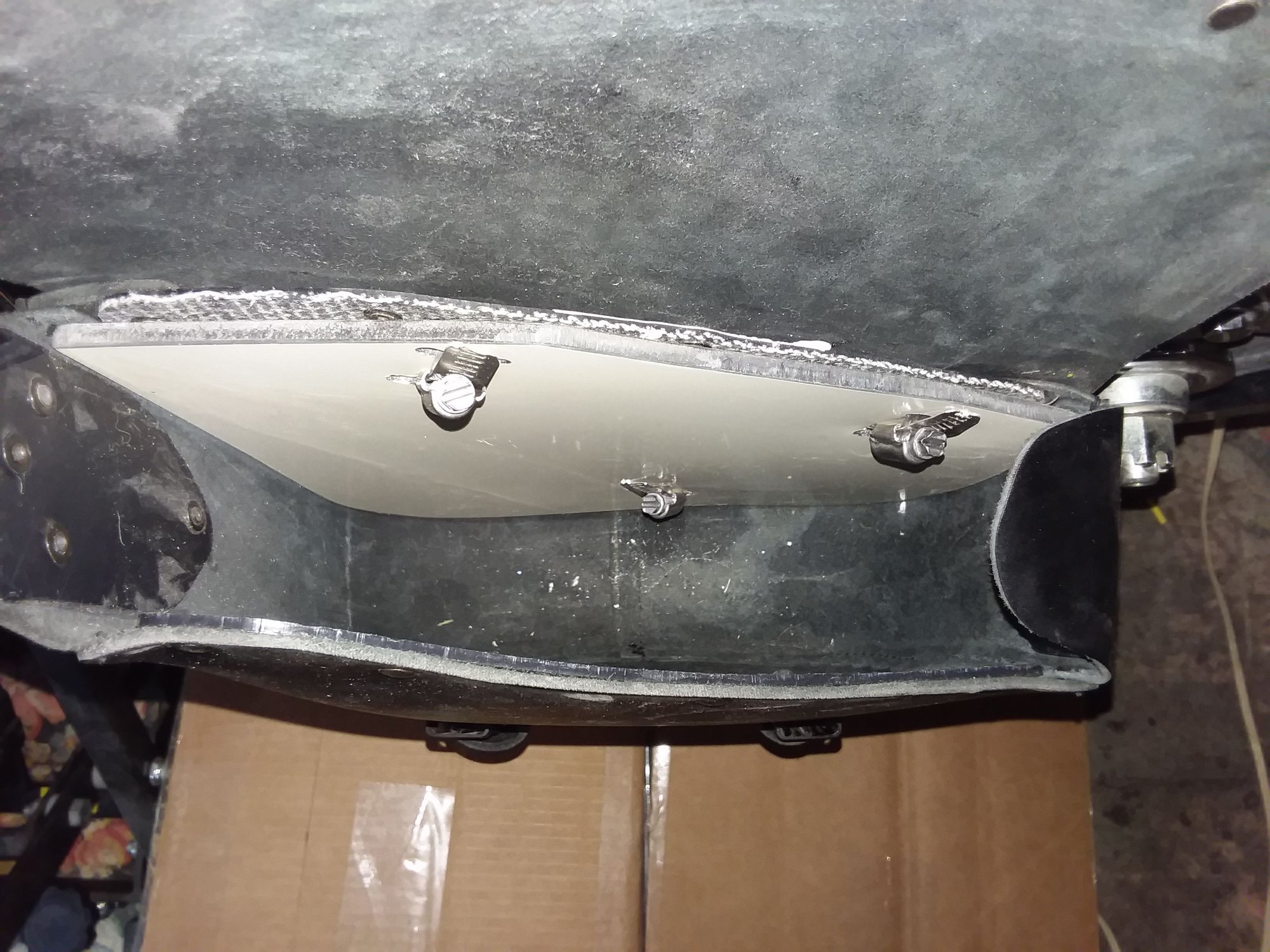

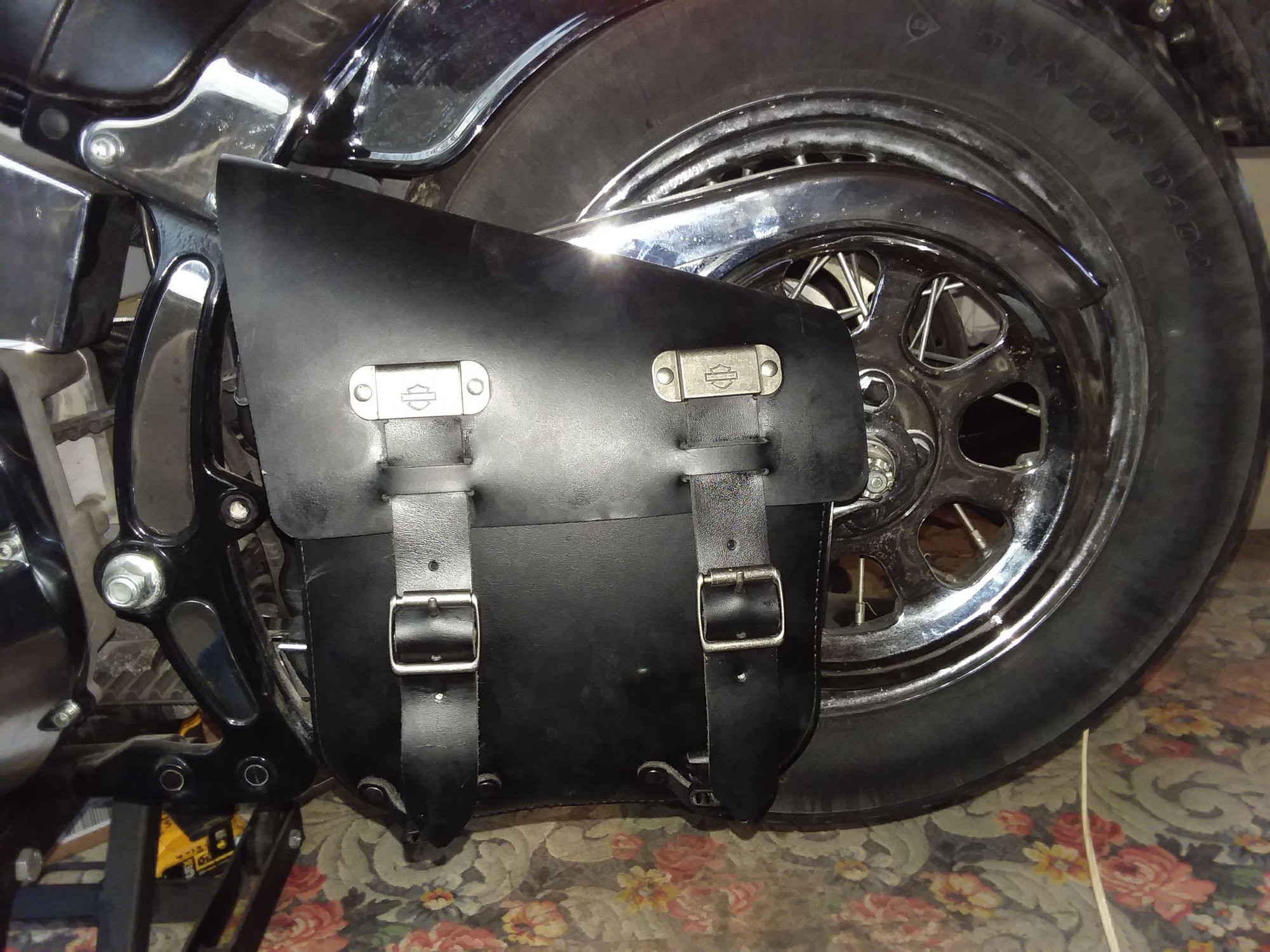

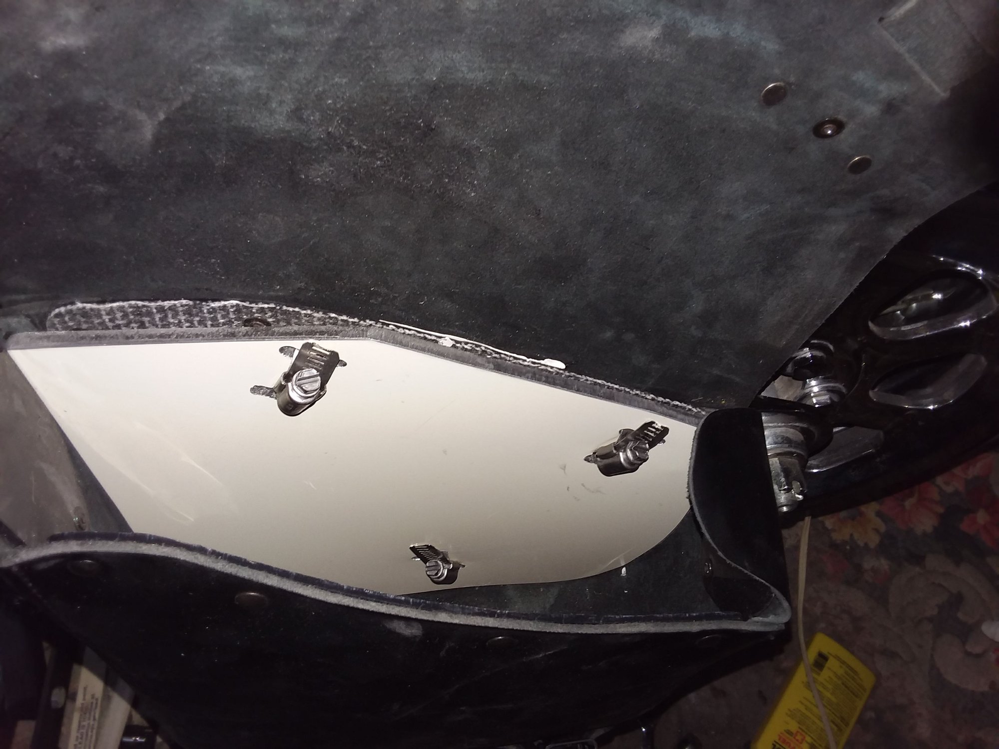

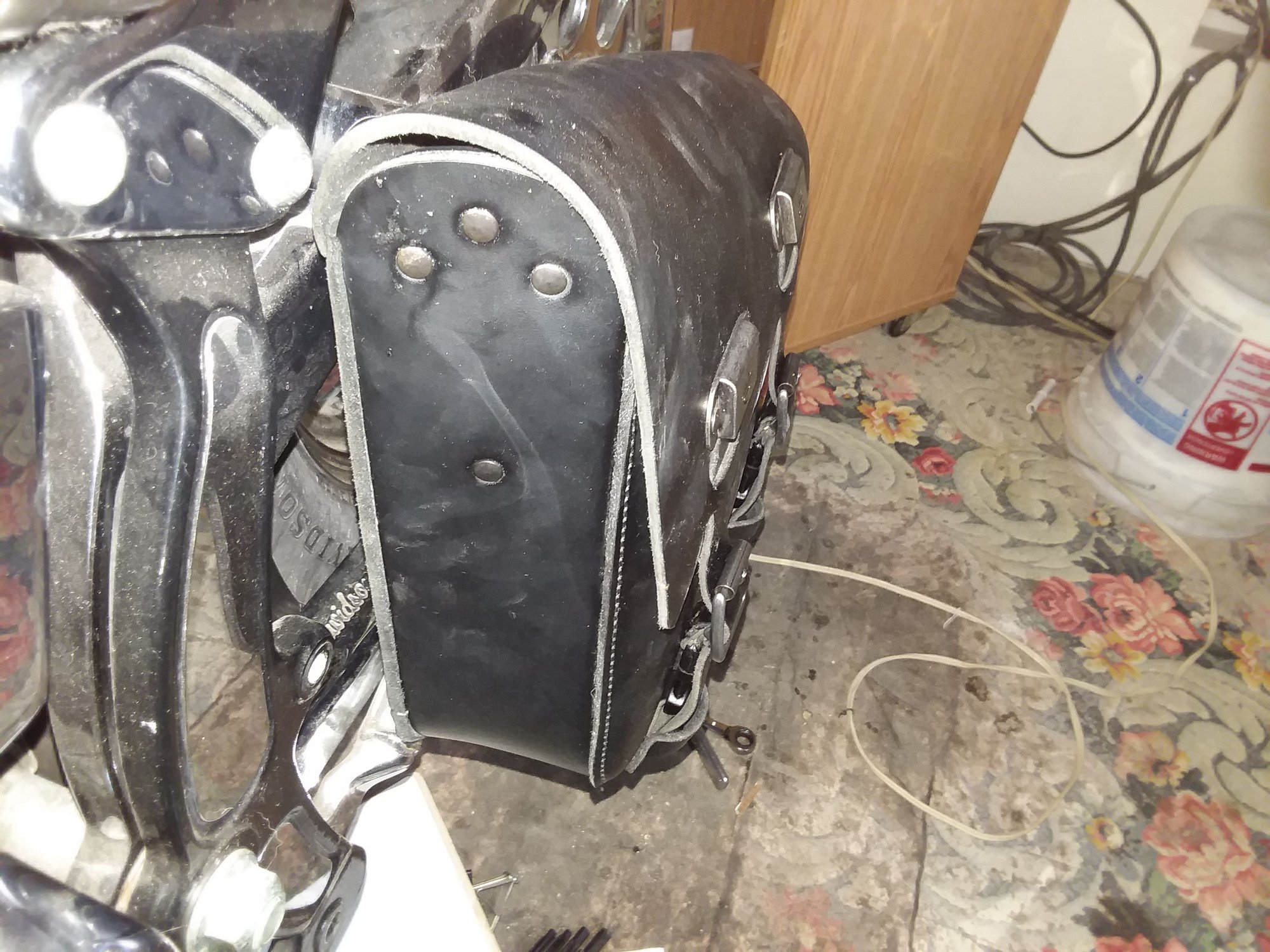

450 ci (large one) H-D bag here , Didn't like the 3 mounting straps plastic buckle kept coming unlatched also just kinda hung there and when over stuffed it was almost a round balloon , And it started to kinda slouch after a while even empty
Cut a peace of aluminum clad plex. to fit inside & 3 SS hose clamps to mount it . Now it holds its shape prefect and stays tight against the swing arm.. A big improvement . Bag is not the highest quality , but not the worst eather
Finished nice and tight
Panel & clamps installed
