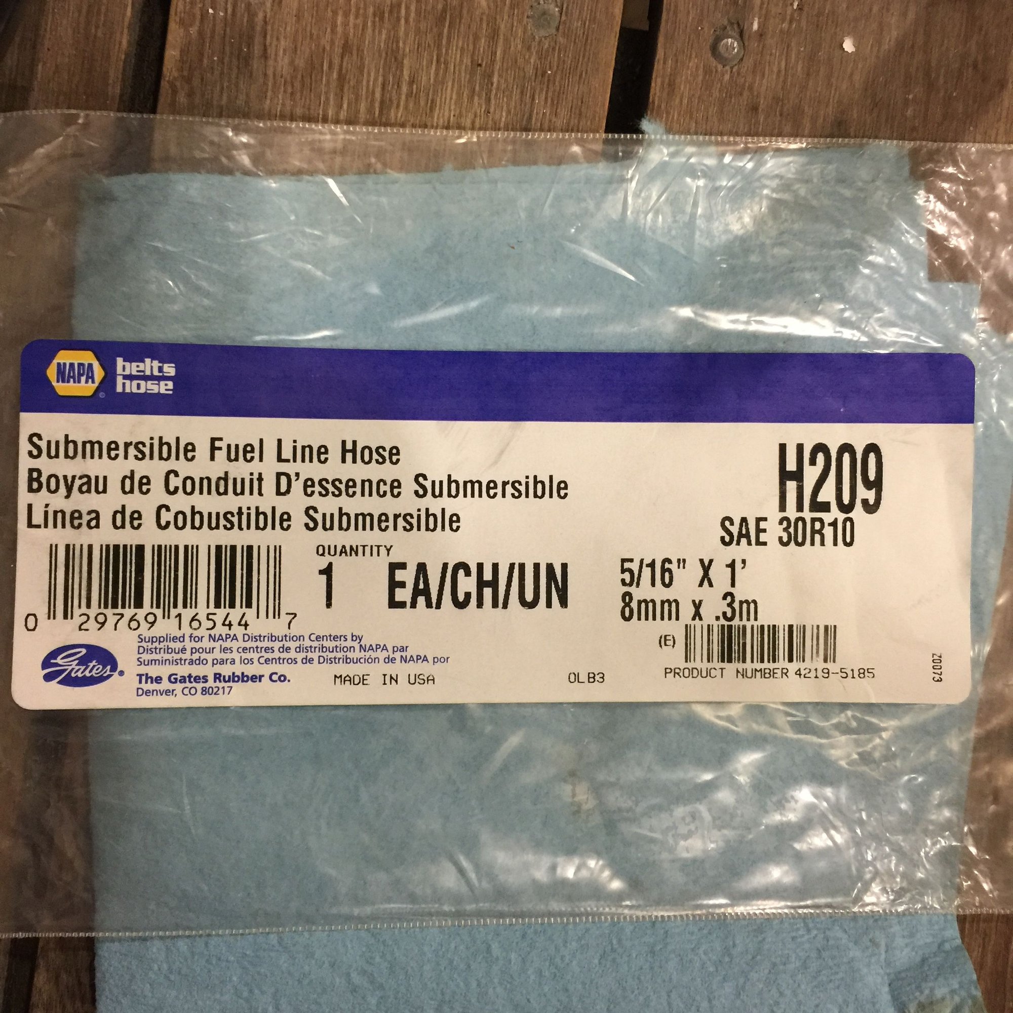

If you find you have holes in your in tank fuel lines, I have the part numbers for the submersible fuel line from NAPA that you would need. I had to do this on my 07 Street Bob, followed several threads in Dyna forum to replace them.
I will watch this thread or you can just PM me for them.

As requested, parts for replacing fuel line. The clamps I believe are called Corbin clamps.
