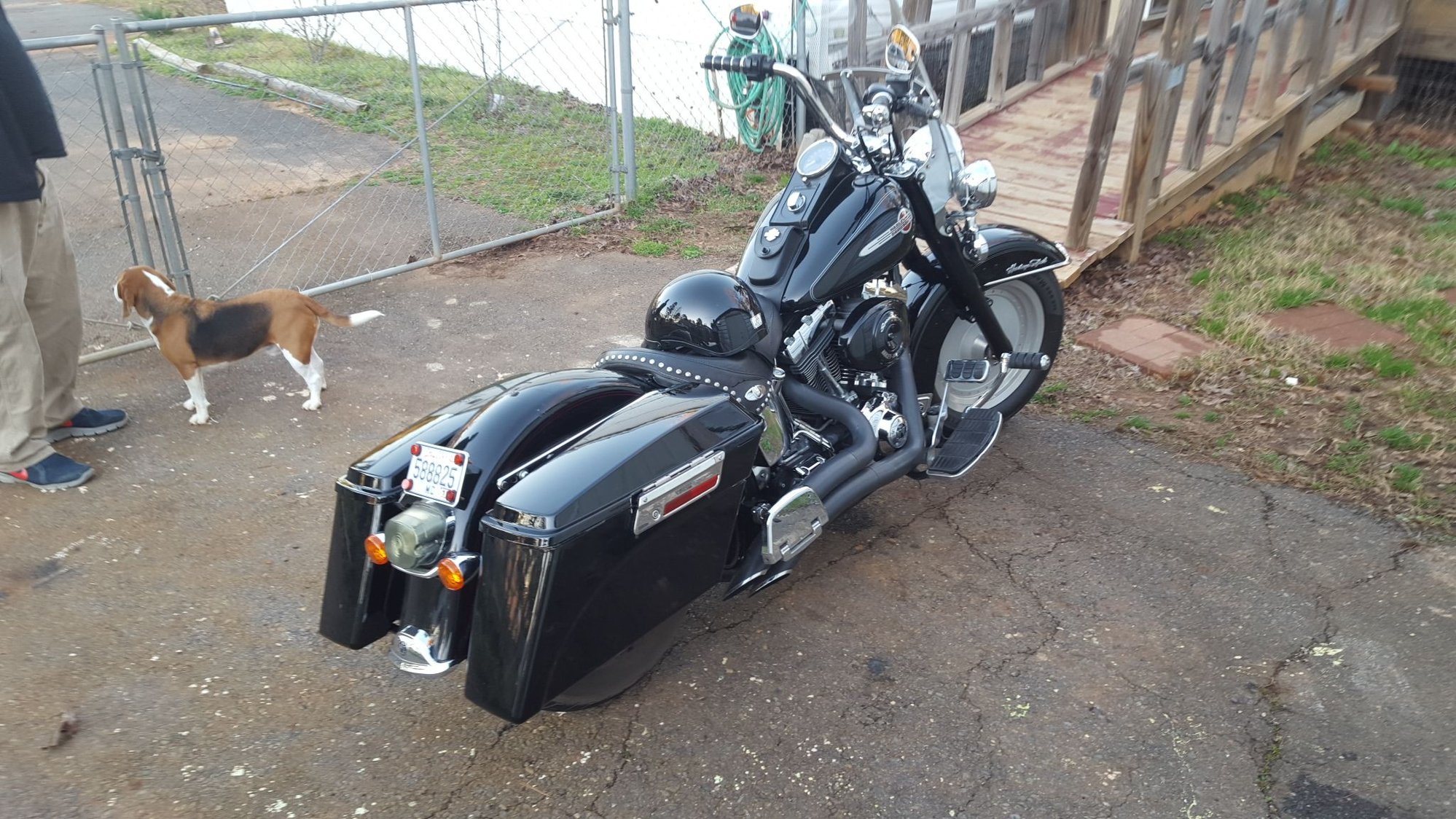

I like the way my heritage bars handle. I would call them mini apes. 12" or so high and I know quite a few people in your height range that really like the heritage bars. They are not as cool as the aftermarket brands but they would be a cheaper swap over for you to try to see if you like the way it feels. Might need to lengthen wires and replace cables, but you would have to do that if you went with Carlini Flying apes, gangster or the menace.
Here is a pic of mine these are the stock heritage bars.
