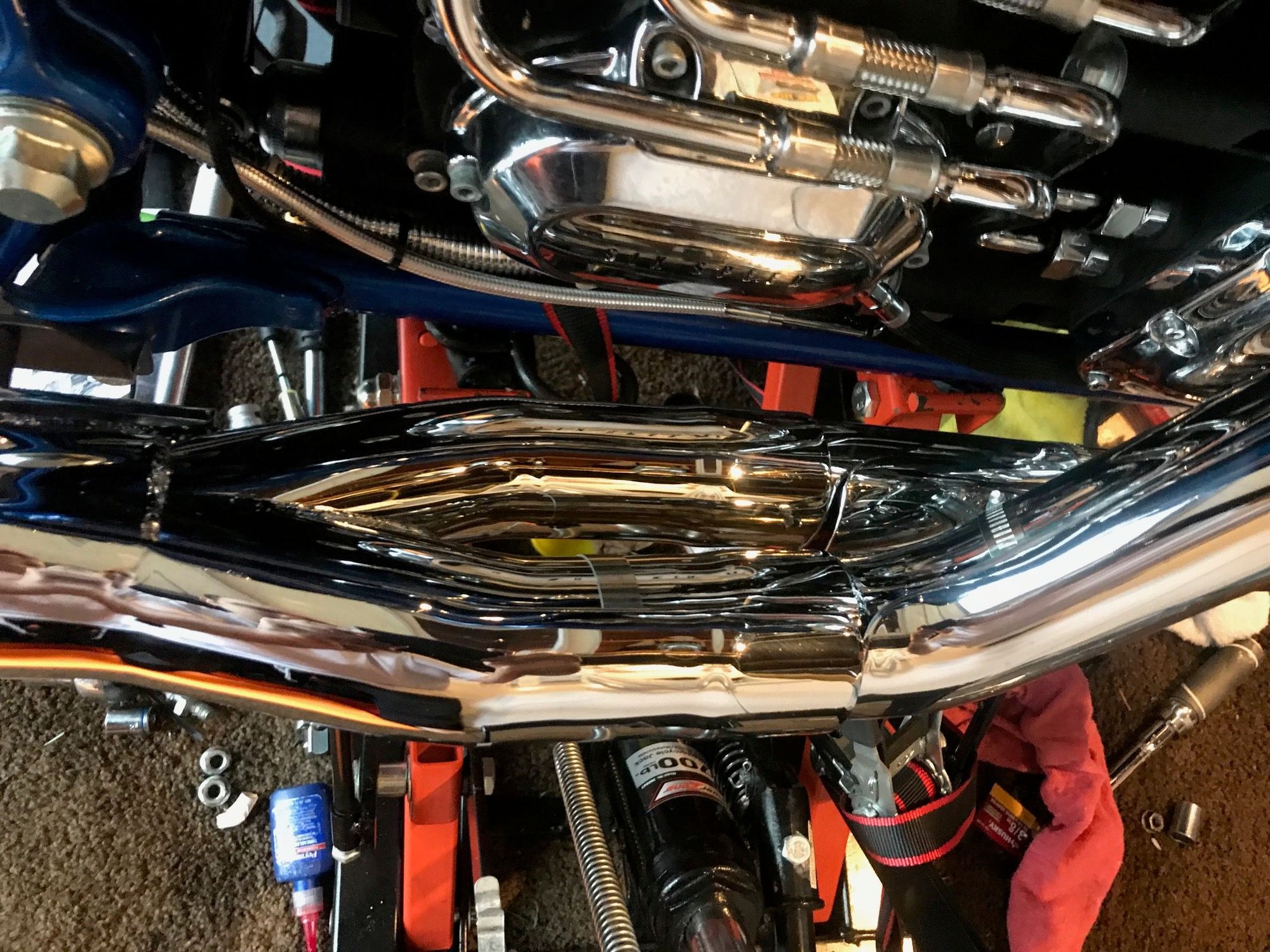

im not gonna kill your thread heres a lil peak of the rb racing lsr installed

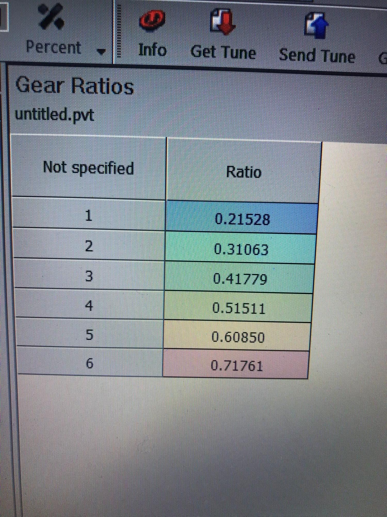

Hey BUDS., im about top flash my new tune, for my RB Racing LSR 2-1 Challenge..... when I change my ratio numbers, as I changed gears, how do I properly flash it into tune, before flashing bike?
PLEASE EMAIL ME ASAP.. TEMPIRELLC@HOTMAIL.COM... I CHANGED THE <32 FRONT GEAR/TO 30>, AND REAR SPROCKET FROM A <67/TO 72>. whatever the mod was/is...same as you....here what my tune thinks I have.

Tommy, I also emailed you with the stock ratios.... When installing the 30t/70t mod you don't need to change the gear ratios from the stock numbers, it has no affect on those. You just need to recalibrate the speedo/odometer.
