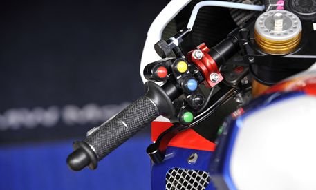

Default Thumb Lever?
Thumb lever below grip left side?
I have always been a fan of the GP/ Moto GP. The 500cc 2 stroke days were the best.
Years ago, Mick Doohan hand a thumb lever on the left bar if memory serves, in order to race with a injury.
I have no idea if the idea caught on, but with the 'net we might be able to replicate his setup if your Nephew has a good thumb...
Here is an image, you might have do do some searching...
Looks like you push the lever with your thumb.

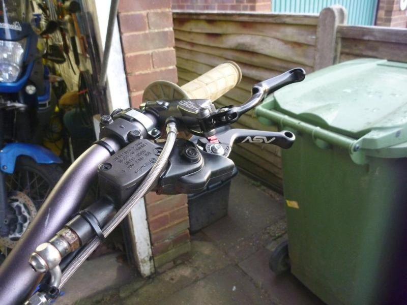

Or something like this on the right lever but with a Hyd master cylinder:
https://www.reddit.com/r/motorcycles..._he_moved_his/
Quick search:
http://www.amazon.com/gp/offer-listi...80154653794588
http://www.kliktronic.co.uk

Default 2 levers left side?
I could not find a Hyd master for the right side thumb. I thought it would be easy to find.
This would be fairly cheap and easy:
1 brake lever on top of the other clutch lever left side. (or vice versa).
http://advrider.com/index.php?thread...dlebar.849894/
jepondur
