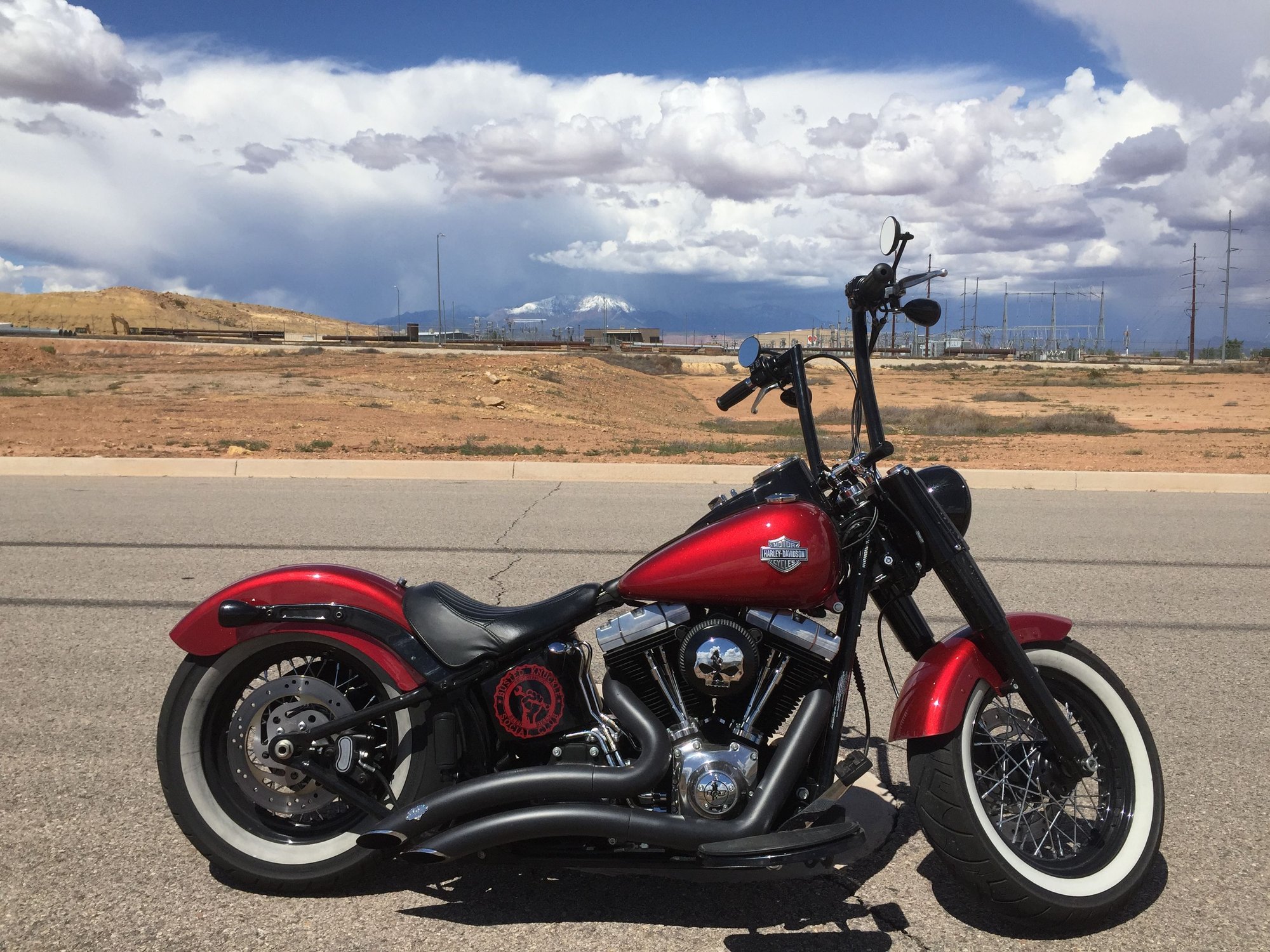

Another option is to rework your rear fender and lower it. The fender mounts to the struts which bolt to the frame under the seat. When I did the 200mm conversion on my Slim I used a Fatboy fender and struts, welded up the strut mount holes on the fender and relocated them higher and forward to make the fender sit where I wanted on the tire. It took two attempts to get the location I needed. You have to take suspension travel into consideration so you do not bottom the fender out on bumps.
As mentioned earlier, you can use an air or progressive shock to further control ride height and shock rebound (this is up to the individual, both have pros and cons). I originally had stock shocks with lowering bolts (you can also adjust rebound on stock shocks). The stock shocks with lowering bolts were a tad harsh on large bumps so I went to Progressive shocks. I lowered the ride height about an inch and adjusted rebound to my liking (I only ride one up on my Slim). This is an old pic of my final set up. Rides great, does not bottom out and I never have to worry about a failure in an air system as I would have to if I ran air shocks.
Edit: The seat mounts will also have to be adjusted (bent) if you use this method.
Nice bike.

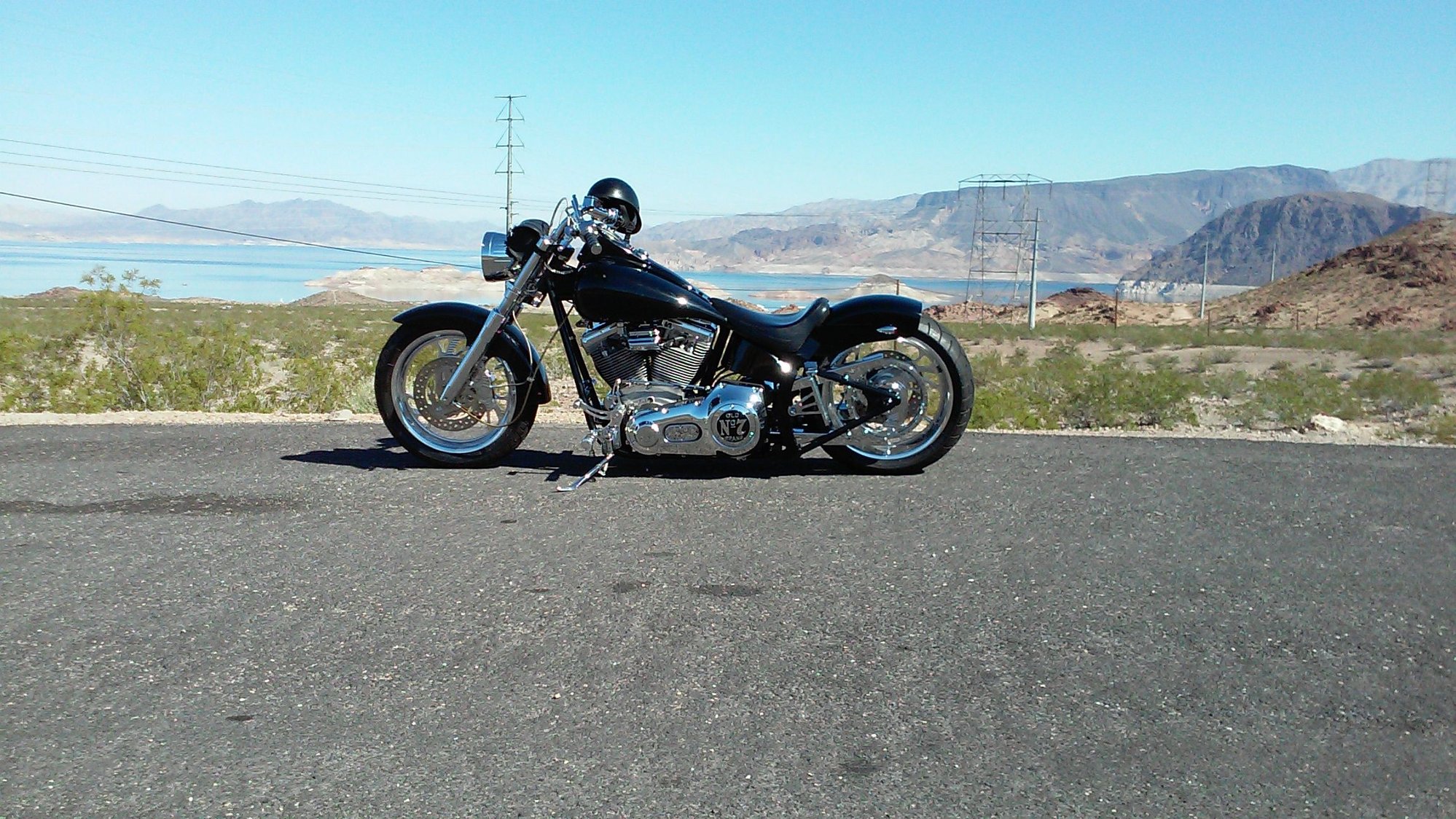

I chopped and reworked my fender as well. I also have it lowered 1 inch. Sorry its not a slim either.
